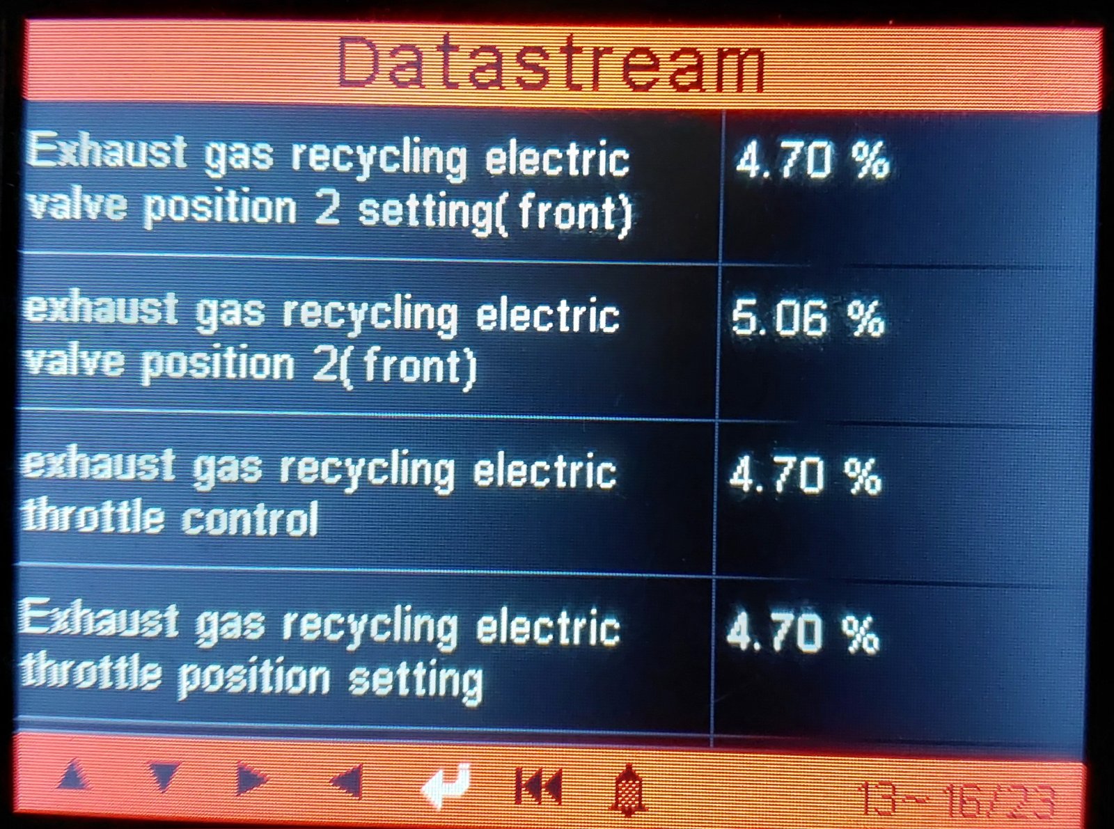

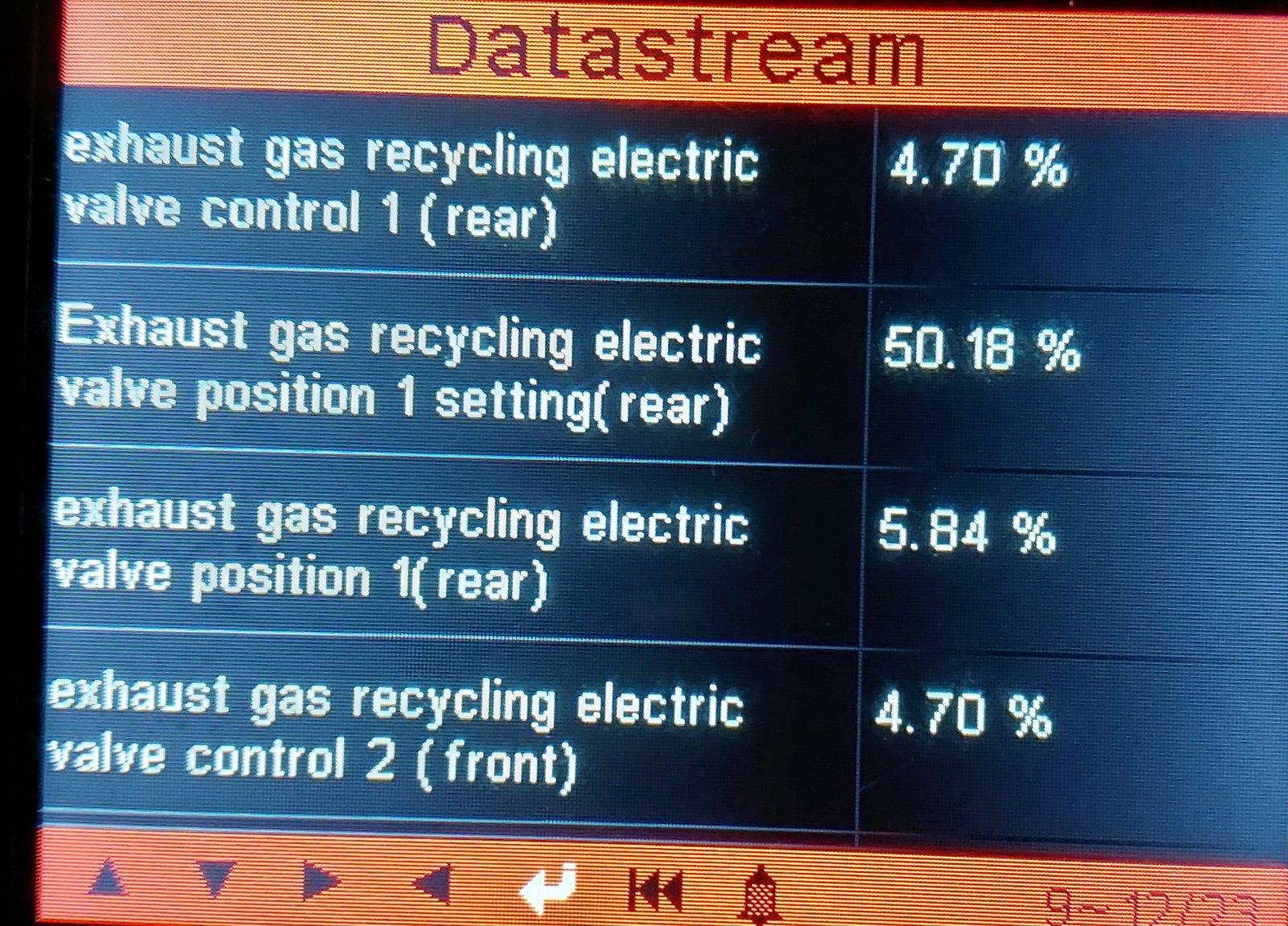

My 2.7 HDI suffers from power loss and uneven running during acceleration. Prime suspect is of course an EGR valve. I connected my code reader to check running parameters. See attached pictures. There are three different parameters related to each EGR.
The rear EGR Valve Position 1 Setting (Rear) is stuck at 50%, regardless of power-setting. I guess this means the rear EGR valve is physically stuck at 50% open. The two other values, EGR Valve Control 1 (Rear) and EGR Valve Position 1 (Rear) both follow power-setting in a sensible way, and drop to around 5% after one minute at idle. One of the values I'm sure refers to the input value from the ECU, what but is the third parameter? I would think there would be only two parameters, one for input value and one for actual physical EGR valve position.

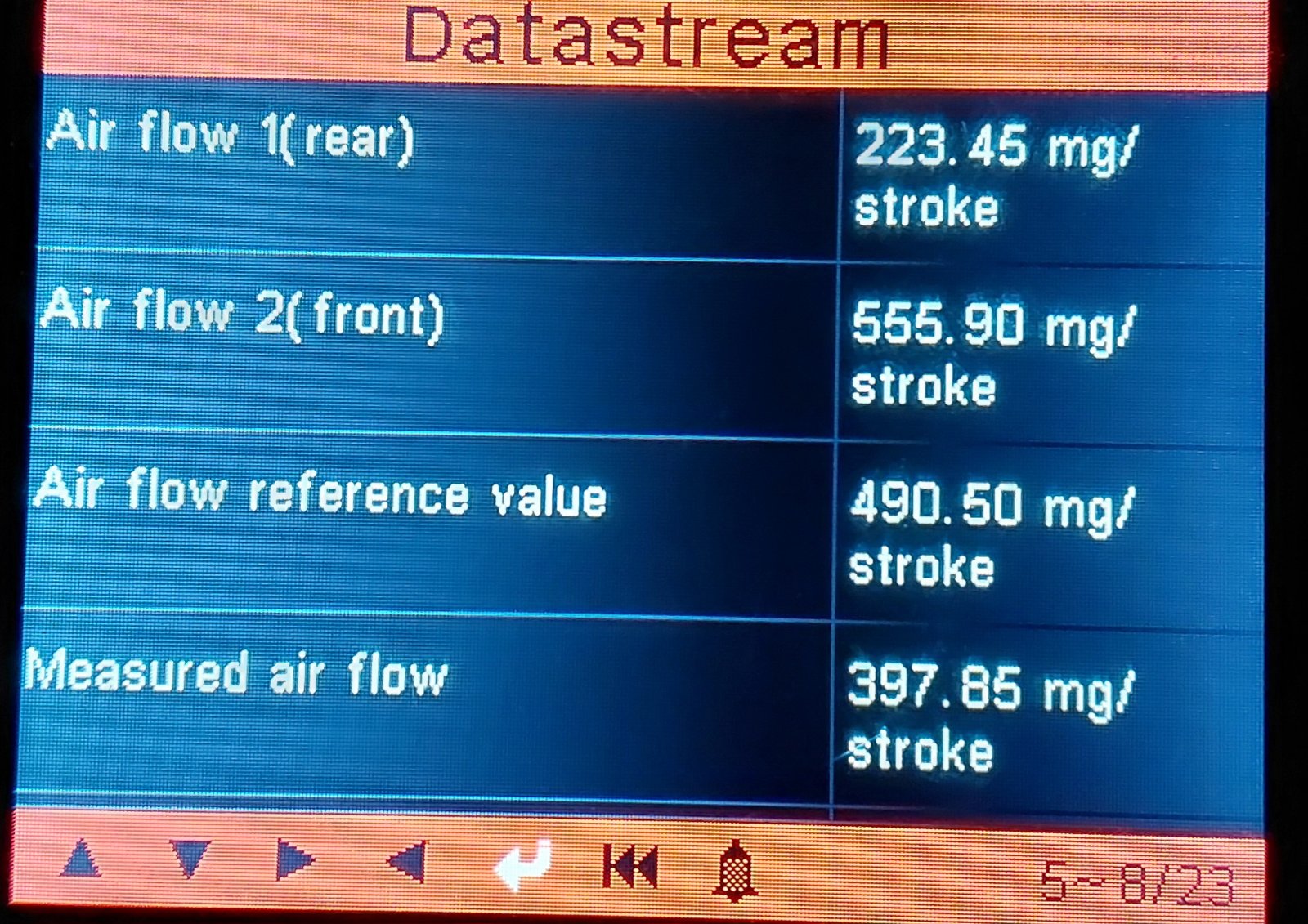

The picture showing Air Flow parameters shows a low rear air flow, which makes sense.
