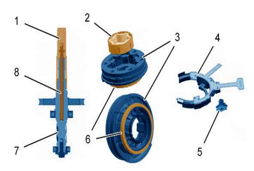

So when we talk about the steering wheel angle sensor here, we are not talking about the sensor in the actual steering wheel as it's not present.
"a" Power steering electric motor.
"b" Steering wheel torque and angle sensor (Absolute steering wheel angle) (*).
"c" Electric power steering ECU.
"d" Steering rack.
(1) Pinion stem.
(2) Upper rotor.
(3) Lower rotor.
(4) Hall effect sensors support.
(5) Geneva wheel (*).
(6) Steering wheel angle sensor magnet.
(7) Gear.
(8) Torsion bar.
The Hall effect torque sensor has no contact.
The torque sensor located on the pinion shaft is used for measuring, in real time, the torque applied to the steering wheel by the driver (Value of the torque between + 10 Nm and -10 Nm).
The pinion stem (1) is linked to the pinion (7) via a torsion bar (8).
Each rotor consists of an opposition of South/North magnetic poles:
The angular offset of the 2 rotors produces a variation in the magnetic flow which is converted into an electric signal by 2 Hall effect sensors.
For vehicles that have ESP, the torque sensor is complemented by the following specific components:
The Geneva wheel (5) gears onto the tracks of the lower rotor (3) in such a way that it turns 1/10th of a rotation for every 180° of rotation of the upper rotor (2).
The Geneva wheel (5) measures the steering wheel angle on starting.
Note: (*) According to version.
- The upper rotor (2) is solid with the pinion stem (1)
- The lower rotor (3) is solid with the pinion (7)
- Geneva wheel (5)
- 2 Additional Hall effect sensors

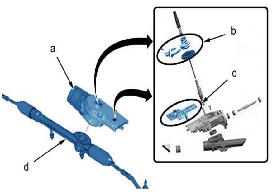

Can I assume the image is the steering rack itself or is this sensor shown as item 6 etc located elsewhere hopefully so as I've changed the rack already? I've got access to the parts page and can't see anything else within the parts pages that may apply.
The live data shows 0 degrees when the steering wheel is perfectly straight so I don't understand why the car thinks its wrong unless it has 2 reference points if that makes sense (both ref points aligned to confirm readings to satisfy the ESP/ABS module) Surely it needs two readings to know if something is wrong. I have tried calibrating it many times and displays it as calibrated then when rotating the wheel the - and + appear smooth and consistent, all data does. The fault wont clear whatsoever so its obviously not happy somehow/somewhere.

The overall assembly is shown below of which the parts in my last diagram show a bit more detail of the components. (I'll also copy this back into the original post above to help viewing at the same time.
"d" Steering rack.
