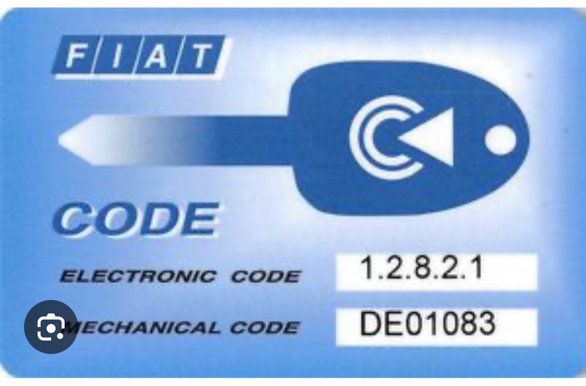

Hi Does anybody know what the code card number will be to get into the marelli BCM? To do a proxy alignment i’ve getting asked for code card any ideas where i would find this I don't have any books or anything

The code you are talking about is the electronic code & should be on a card like this. Would normally be found in the handbook pack.
Its unique to your vehicle, if you dont have it you will need to talk nice to a dealer with your V5 & ID.
This is the code you would need to program a new BSI or key.

Thats wheeler will I get it from Peugeot also as the van is a boxer but has the fiat bsi and I need to proxy align and it wont let me in without a a code!

Or you can disassemble the BCML7 BC250I 1398635080 and test the memory 95640 and read the data, upload it here and I will tell you the e.code.

Alternatively a decent auto locksmith should have the equipment to pull the code via OBD in around 10 seconds, if you know a garage that uses a high end Autel scanner this can pull the code too via OBD. No need to open BSM on this age van.
