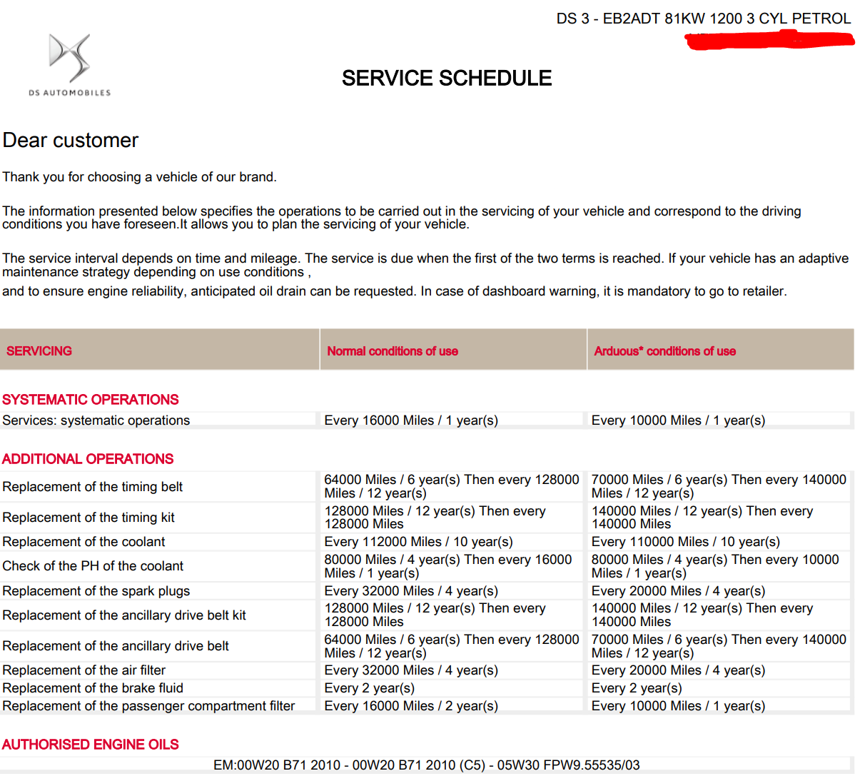

Got a new (to me) DS3 and wondering if I can get a service schedule for it please?
Vin VF7**************[VIN obfuscated, can be read by forum staff]
Also wondering if anyone knows if the wet cambelt issue was resolved with my 2019 model? There were issues with earlier models and the servicing interval was brought forward for the first service because of this
I understand its critical the correct grade of oil is used. Is anyone able to advise on what I would need? I can't find anything in my documents

The wetbelt issue can't actually be resolved to be honest. It's the engine design. All that can be done is annual servicing as required in any case and ensuring the correct specification of oil is used, and of course ensuring the belt is changed at the 64k mile or 6 year mark.
Click or Double Tap image to Zoom
Your oil grade and specification is shown underneath on the schedule.
