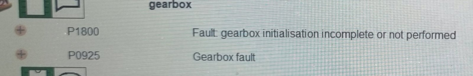

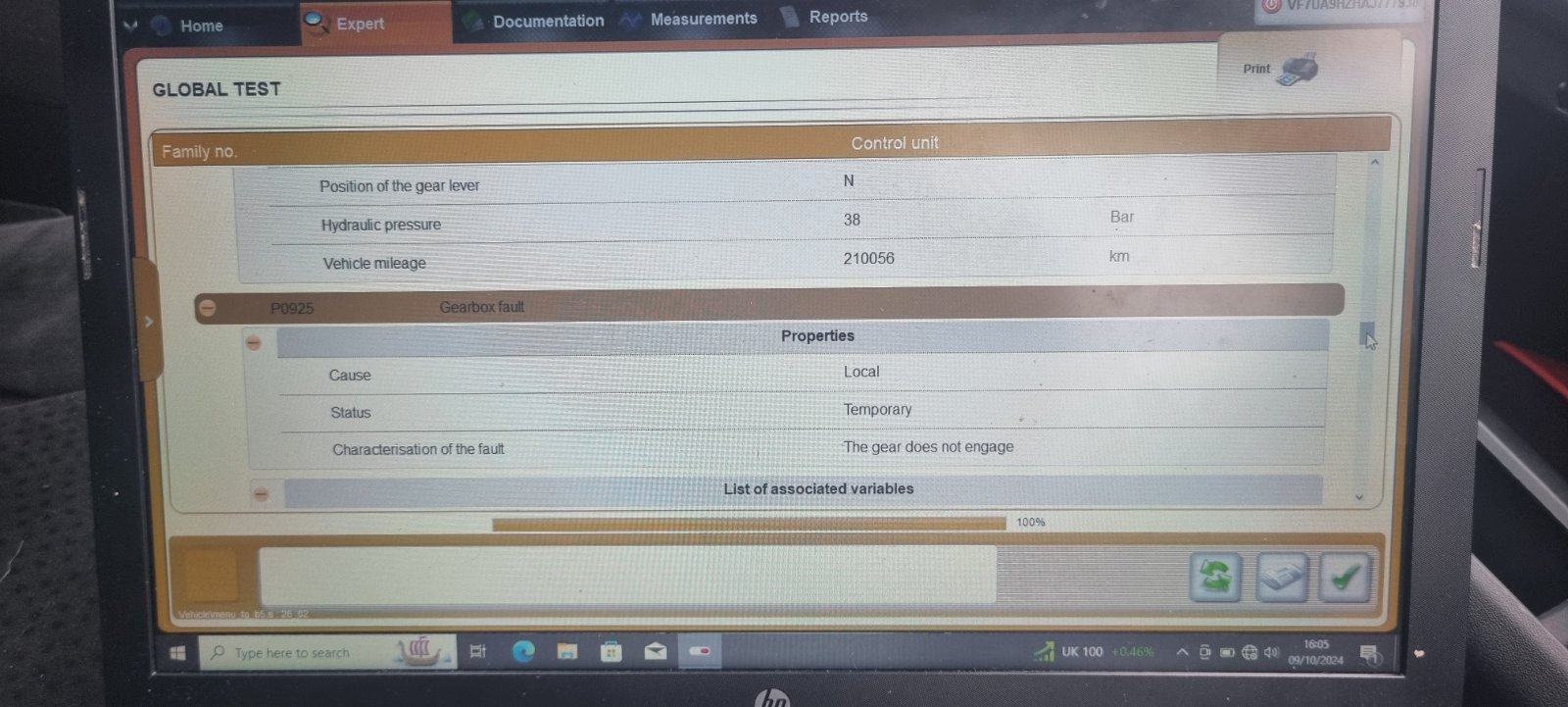

So I've received my lexia kit and got diagbox installed on laptop and plugged the car in and found some faults.
I got the codes p1800 and p0925. I've included pic of this.
First code indicates the garage may not have fully completed the initialisation and calibration of the gearbox and new clutch etc but could that have also caused the p0925 fault or could I also be looking at another issue altogether.
Thank you very much for your help.

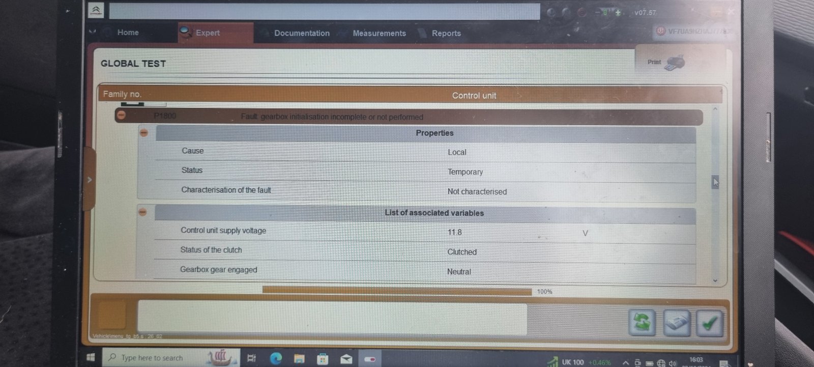

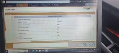

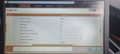

You need to drill down into the fault to see what it is saying about the captured data. I'd be very surprised if DK didn't do all the necessary programming after install of the new clutch.

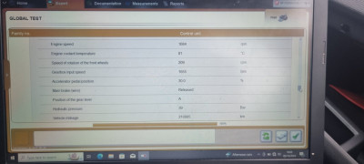

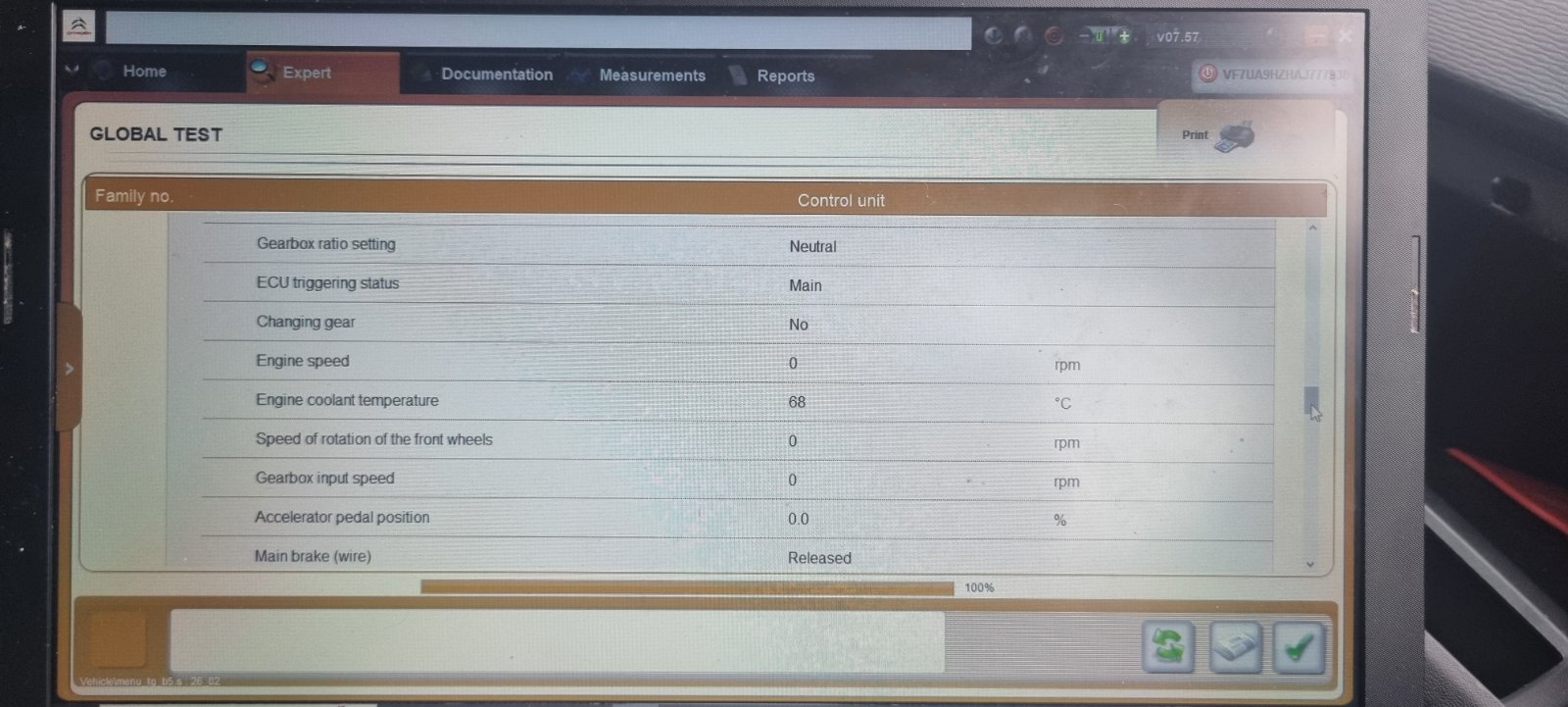

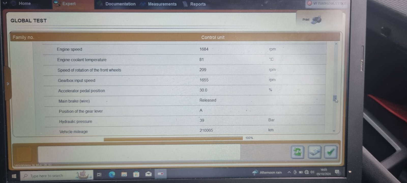

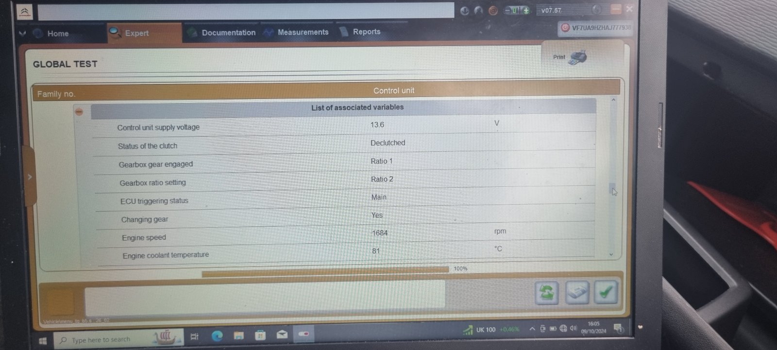

This is everything I got from the diagbox. I've attached pics of the data it gives.

Re: C4GP egs problems
Code P1800 suggests it wasn't carried out.
Fault Code: P1800
Description of Fault:
  • Gearbox programming incomplete or not carried out fault : Not characterised. Selection gate initialisation not completed or not done.
    Context of appearance of the fault code:
    The following conditions have to be met:
    - ECU woken up
    - Ignition on for more than 5 seconds
Conditions for Fault to clear:
Downgrade Modes whilst Fault is active:
  • Automatic mode deactivated
  • Crawling deactivated
  • Take-off deactivated
  • Gear change prohibited
  • Switching on of the warning lamp and/or warning message (*): "SERVICE" warning lamp
  • Sport warning lamp
  • Snow warning lamp
  • Automatic or 6-speed piloted manual gearbox warning lamps (Orange PRND triangle)
  • Display of a "-" on the fascia panel
Symptoms:
    • Impossible to make the vehicle move
    • Lack of power
    • Difficult/impossible to change a gear
Suspect Areas:
  • Programming to be carried out in after sales
Fault Code: P0925
  • Gearbox fault - The gear does not engage : Not characterised. Non-engagement of the gear requested at the end of 2 s (Not N).
    Context of appearance of the fault code: Gear change in progress (Engagement only)
    Technical precision on the context of appearance of the fault code: Absence of fault codes P1586 - P1587 - P1724 - P1726 - P1731
  • After switching the ignition off and then back on
  • Attempts at engaging the target gear and activation of manual mode (Gear change requests are then ignored)
  • In the event of a failure to engage the target gear:
    - Emergency selection of neutral (Subsequent gear change requests are taken into account)
    - Automatic mode deactivated if engagement of target gear fails
  • In the event of failure after several attempts: Selection of neutral
  • If the vehicle has the Stop and Start system: Stop and start function deactivated
  • Switching on of the warning lamp and/or warning message: (*) Warning lamp MIL
Symptoms:
  • Lack of power
  • Absence of automatic stopping of the internal combustion engine
  • Lighting of the engine autodiagnosis warning lamp
  • Starting problem
  • Timing
  • Leaks
Suspect Areas:
  • Clutch kit
  • Gear engagement sensor
  • Selection sensor
  • Electrical harness
  • Pipes
  • Hydraulic valve block
  • Electro-pump
  • Pressure accumulator
  • Electrovalves
  • Piloted manual gearbox
  • Mechanical problem (Gear selection mechanism, Gear engagement fingers)
  • Gearbox mechanics (Internal control)
(*): According to equipment and engine.
