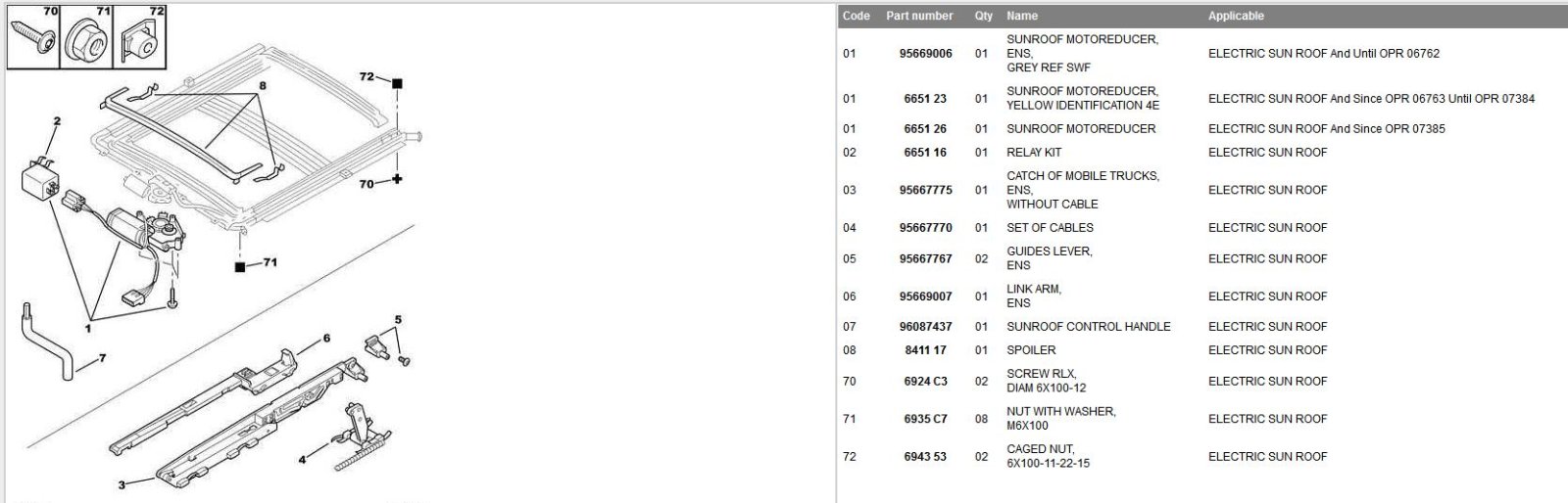

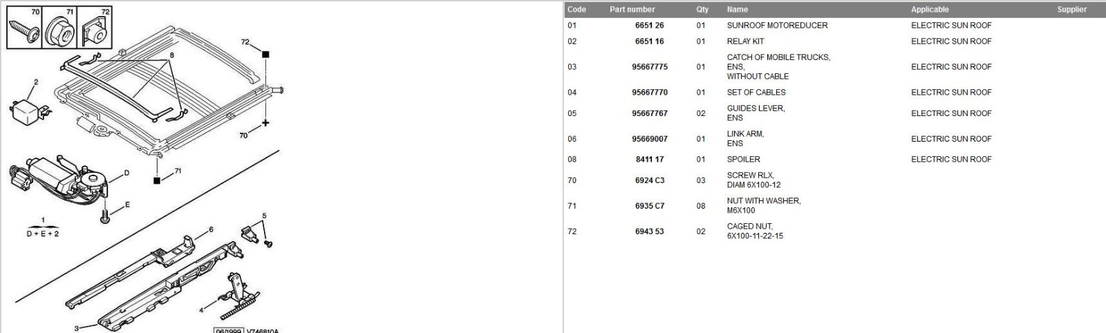

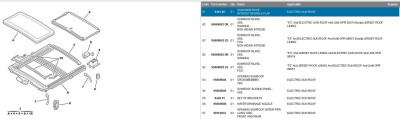

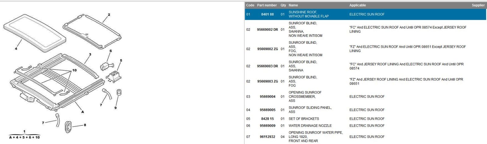

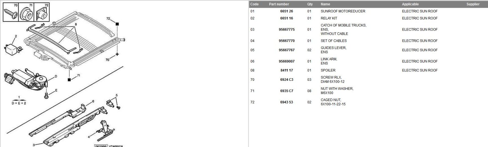

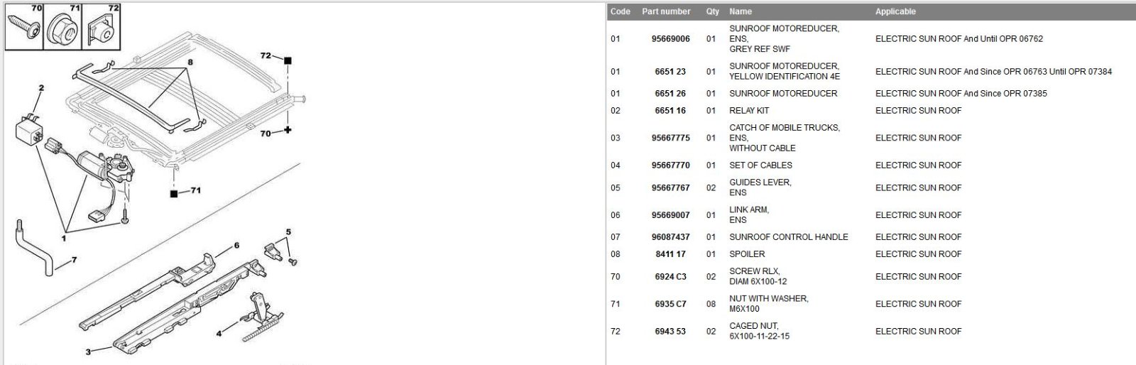

I have a "problem" (self induced) with a S1 car's sunroof..... I have, hanging on my wall, a complete cassette from a S2 V6 (incld motor relays etc)
The plan would be to switch them over..................Anyone done this because to me the cassette looks like it is the same but the motor/relays might be just need to be swapped over.
(Note, the motor etc is working on the S1 unit)
S1
s2
