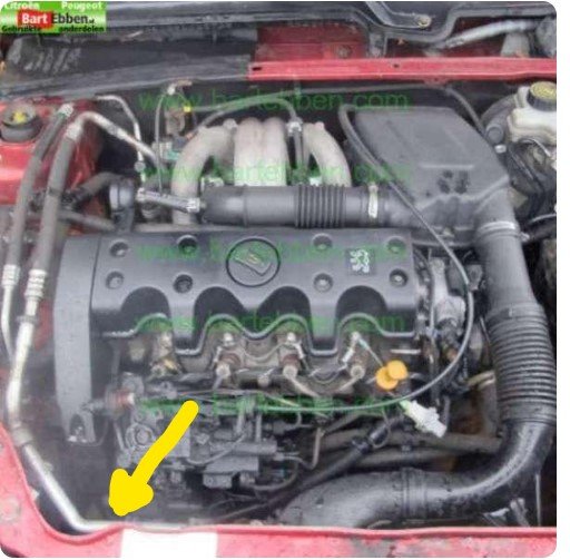

There is a big black 9 pin relay for the immobiliser attached next to the radiator on some models , it was known for the wiring to break right at the plug as it was too short. Worth a look.
It's kind of in the location shown below.

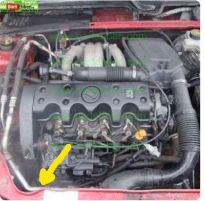

Cant remember this pump off hand but most of them need to be removed off the engine to get to the stop solenoid.
