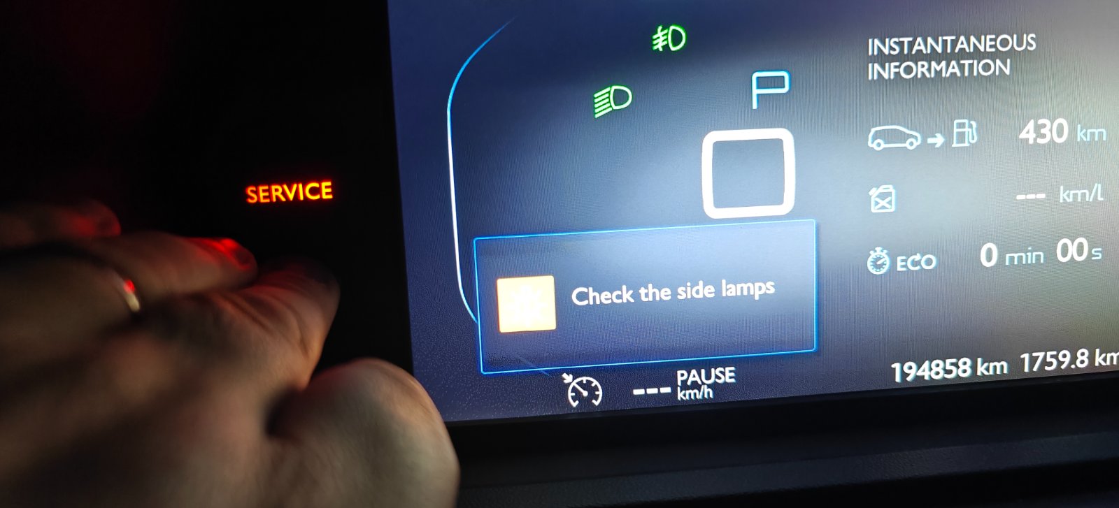

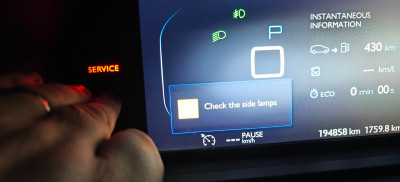

When starting the car I hear a single beep and is greeted with a yellow engine warning.
It says "check the side lamps".

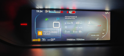

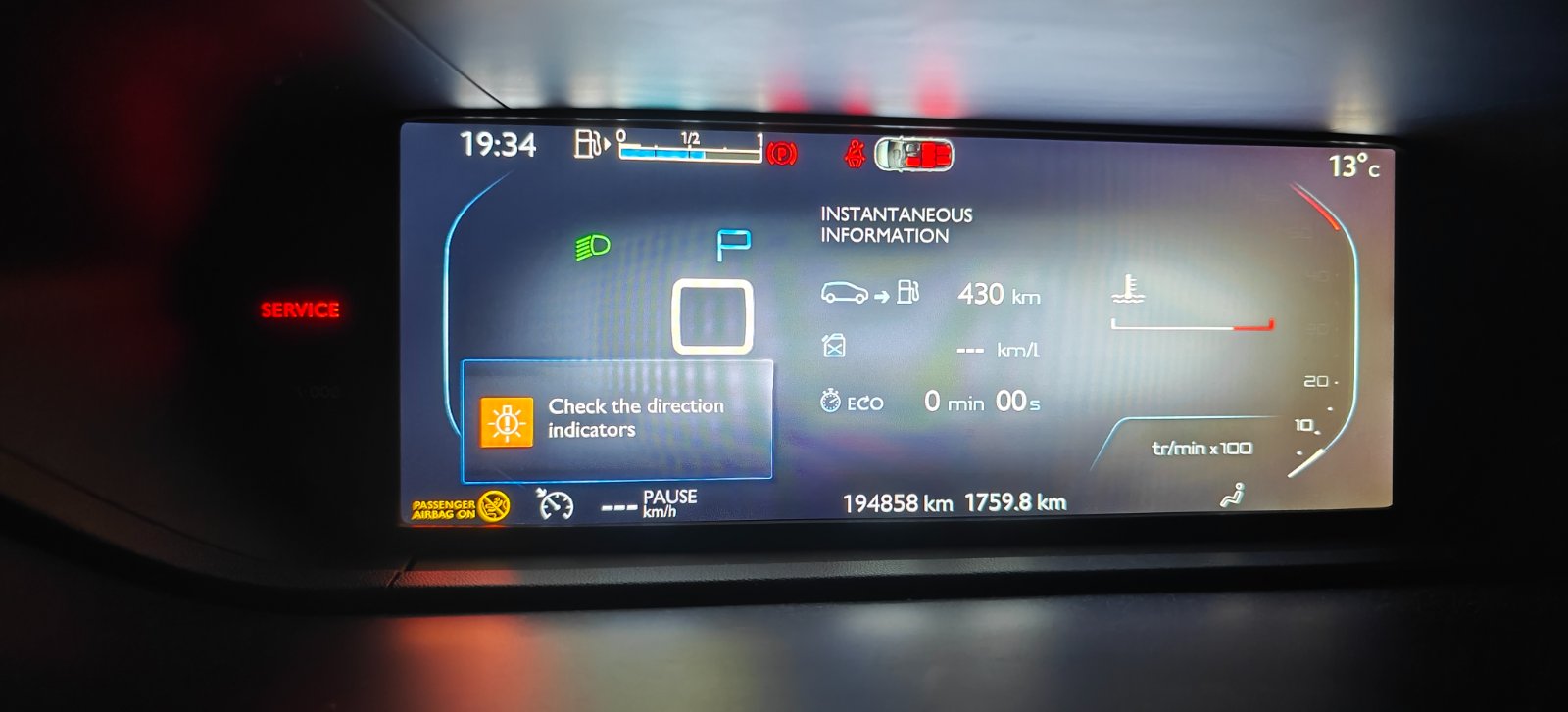

When activating the right signal lamp using the indicator arm I then get another beep followed by the message "check the direction indicators".
If I blink to the left then I get no message.
The message is only displayed once per driving session.

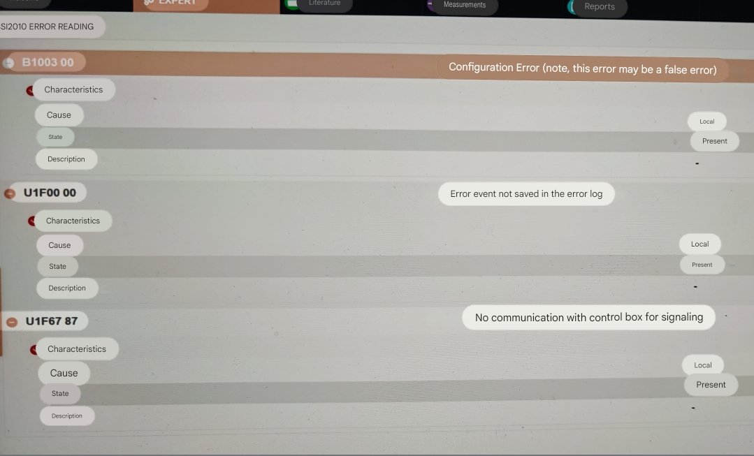

Fired up diagbox and tried to clear the BSI2010 errors (see attachment). Sadly the errors are persistent.
The culprit error is: U1F67 87 - No communication with control box for signaling

BSI reset was the cure.
Maybe the issue happened because I disconnected the battery more than a few times during my above mentioned speaker / radio troubleshooting.
