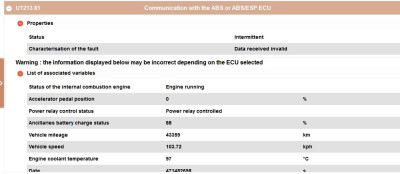

Last week 3 warnings appeared on my dash:
TPMS
Wrench
Control to prevent wheel slippage
i scanned and i saw this attached fault code : U1213 81
any leads?
Thanks a lot

This is a generic fault in the vehicle speed data - usually associated with several different components (ABS / ESP ECU, Power Steering ECU, Engine Management ECU, Multifunction Video Camera etc.).
So as this is related to the ESP ECU, there's a data issue in that the speed information is not right that will affect one or more systems. It needs further investigation to determine specifically what the issue is and you will probably get downgraded modes with some features not working until it's resolved.
I doubt it will be a wheel speed sensor, as this would have a specific code and tell you which sensors the issue was with, so is likely a wiring or connection problem.
