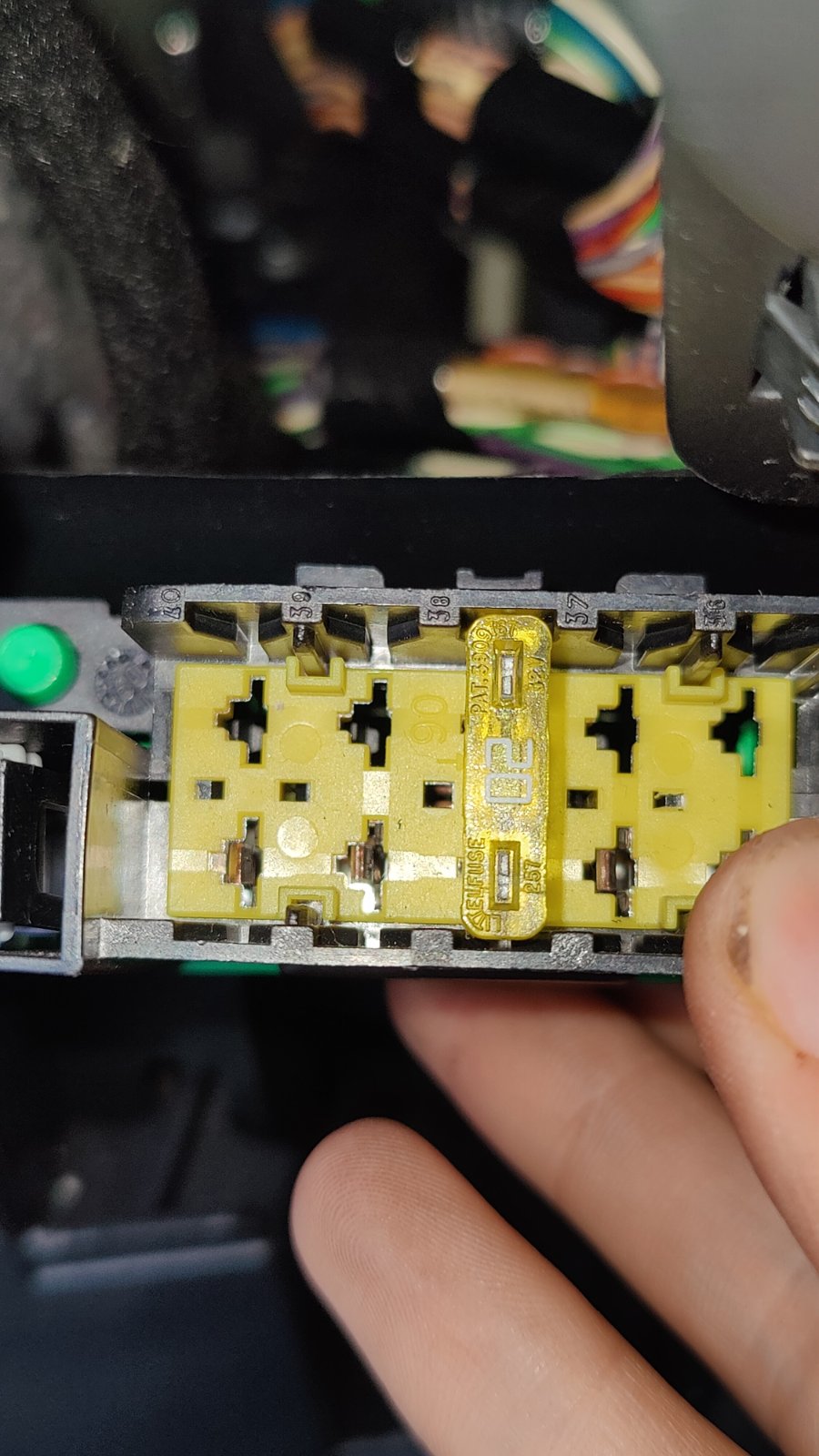

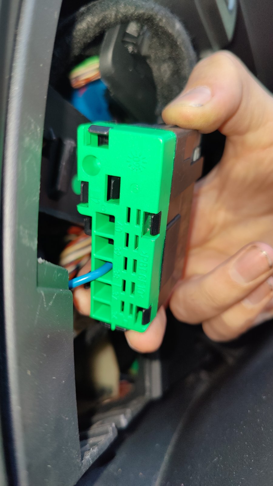

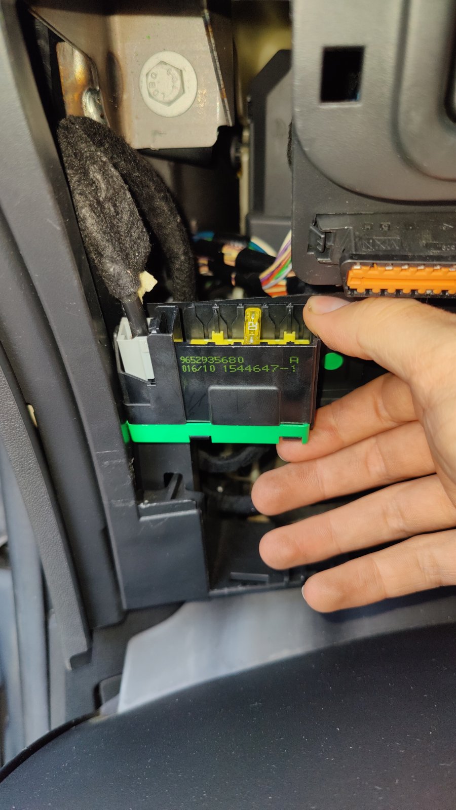

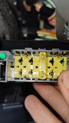

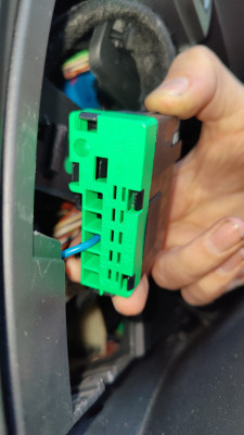

I want to add heated seats into my ds3 and want to use the original fusebox as it has a space for the seated heats (an option in Europe) . I would just like to know what type of pin connector I need to crimp onto the wire that pushes in to the bottom of the fusebox.
Any ideas?
Fusebox p/n is 9652935680

Do you have a picture of the connector that the terminal goes into?

wheeler wrote: 22 Sep 2024, 15:12 Do you have a picture of the connector that the terminal goes into?
https://photos.app.goo.gl/5jBJMzoTVSzZJEby7

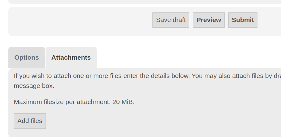

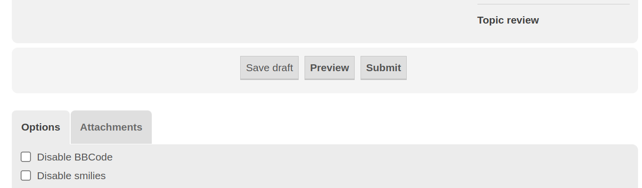

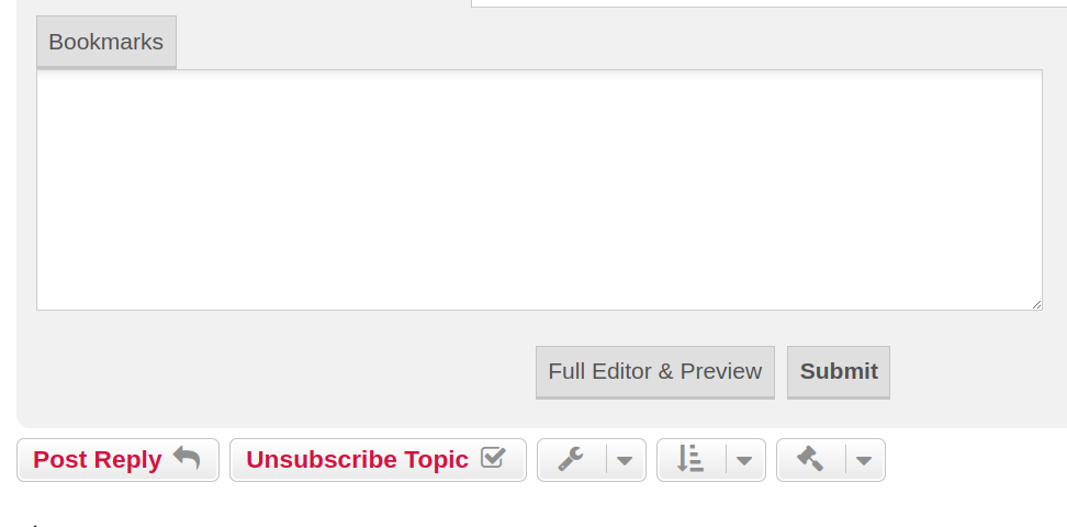

To add an image, go to the "Full Editor and Preview" at the foot of the page:-

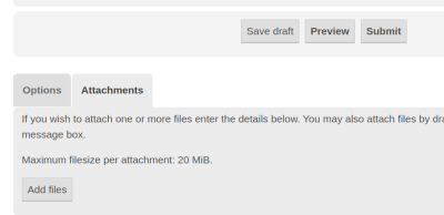

Select "Attachments":-

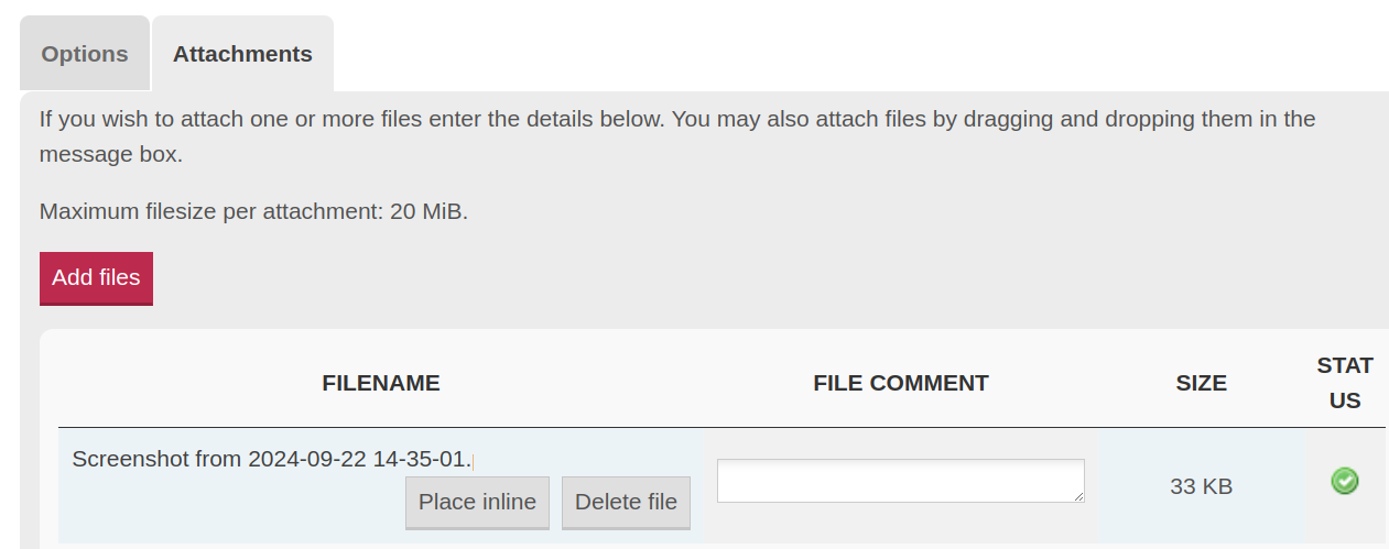

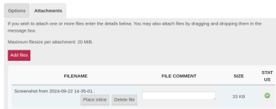

Then click either "Add files" and search for the image(s) on your device or drag and drop the image into the text box.
Then place your cursor in the text where you want the image to appear and click the "Place Inline" button on the image code
Yep

Cant see that one listed as a separate part. Probably best to see if you can get the fuse panel from a scrapper with plenty of wire attached. Lots of the PSA cars use the same fuse box so should be easy to get hold of one.

wheeler wrote: 23 Sep 2024, 12:24 Cant see that one listed as a separate part. Probably best to see if you can get the fuse panel from a scrapper with plenty of wire attached. Lots of the PSA cars use the same fuse box so should be easy to get hold of one.
No worries, i was just looking for the type of crimp connector on the wires so i could add a new one. after extensive research i managed to find the part i need - 963893-1 made by TE connectivity
