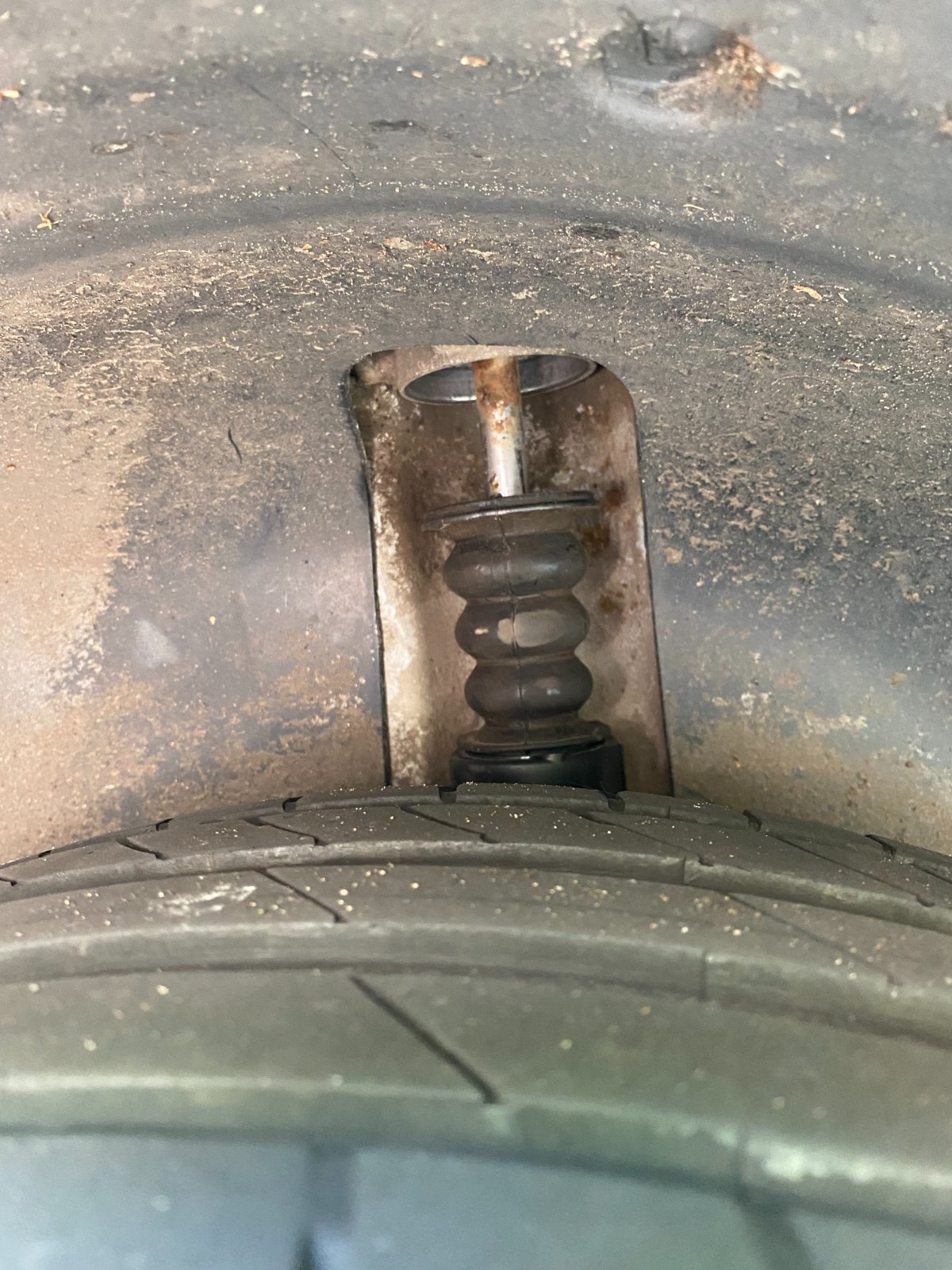

How? I've no idea but I'll give some pointers and ask if anyone else with any car has experienced the same issue. Before I replaced it, the car was making a slight noise going over speed bumps. This became worse after I replaced the gaiter.
The nearside shock was replaced some years ago according to the invoices. I wondered if it was replaced with genuine. It's Bilstein so maybe it is. The shock has a white collar where the piston meets the main shock body. Upon rechecking the tightness of the bolts over this weekend, I noticed that the gaiter was split again and that the white collar had substantial vertical scratches in its VERY tough plastic so it is like the base of the gaiter is being gripped SO tight that it has ripped the gaiter in half again.
Genuine gaiter, bilstein shocker! What gives?
Photo doesn't show the actual split gaiter because I decided to duct tape it together and guess what? Duct tape is indestructible and provides a stronger, mechanical grip than the plastic itself and has ended up pulling the whole gaiter down the shocker! What a shocker that was..
The piston is in impeccable condition under the gaiter so no issues with leaks on the shocker.
