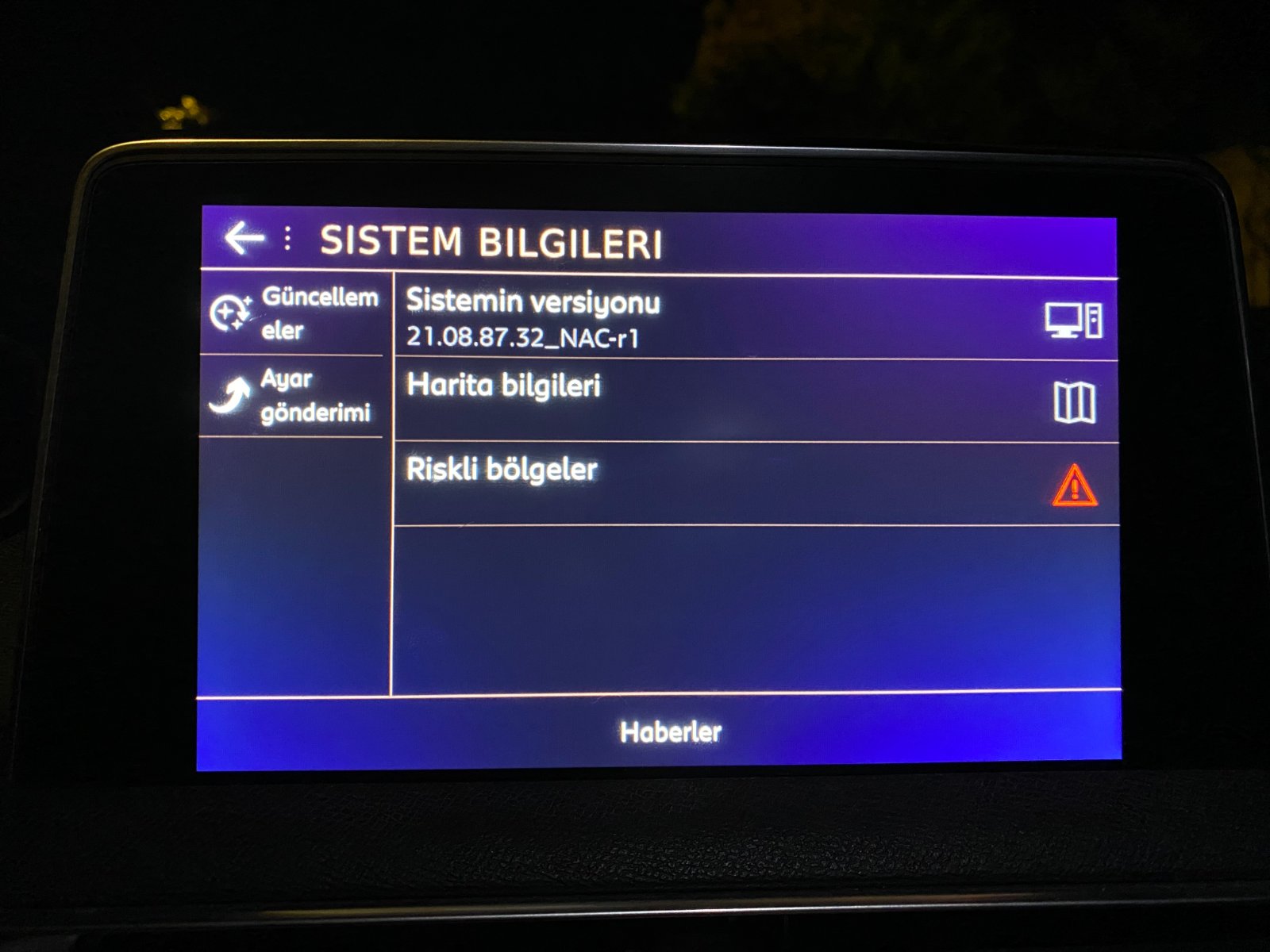

Dear Marc, thank you for your help!
My current system version is: 21.08.87.32_NAC-r1
And my VIN is: VF3**************[VIN obfuscated, can be read by forum staff]
I also upload the information page in case you'll need it.
Thanks again for your time and help!
Deniz
Deniz
- x 6955
Re: Peugeot 3008 (2017-GTLine) Touch Screen Problem
Ok, so this is a wave 2 system and that is the latest firmware available.
