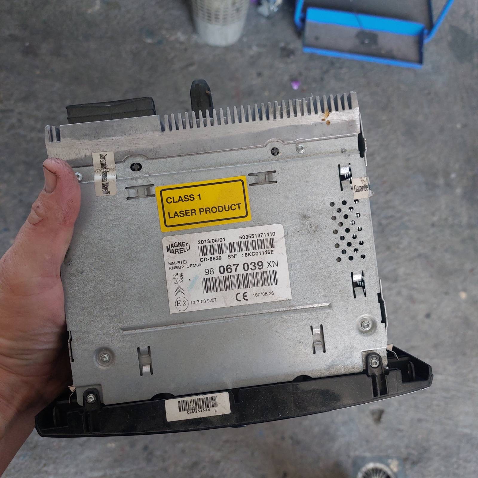

OK, I found on sale this RT6 from Peugeot 308 (RT6 date is 2013/06/01):
Price is 200e. with display. Seller agree to install it in my car.
So what I should check after installation?

Re: RT4 dying display. Replacement with Android?
Be warned that the RT6 ECU can be locked out (it goes into secure mode), meaning that even Diagbox may not be able to configure it in offline mode, without a dealer login or online purchase of tokens from PSA and use din connected mode. These ECUs are protected. Even owners who have an original RT6 and who have upgraded the firmware can find themselves with the unit factory rest back and can't use it, with missing features and options.
Just wanted to warn you that there is a risk....
