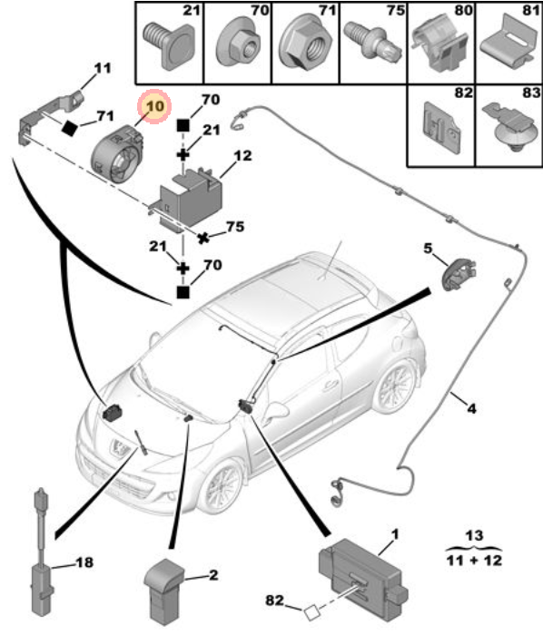

So the prime suspect is the battery in the siren module. This has a service life and when it start to go off like this, it needs replacing. It's akin to there being a cut in the power supply - as if someone were trying to disarm it, the siren goes off. When it gets towards end of life it can't hold as much charge, triggering it going off randomly, but will get worse.
Item (10), Anti Theft Alarm Siren, part: 6680W7, £217.45

Ah, excellent suggestion! Thanks for the diagram, I wonder how serviceable that unserviceable part is, I'm pretty good with a soldering iron if nothing else!

The siren module (#10) is self contained and has a battery in it (as Marc said). That battery only powers the siren.
The siren module is glued together (not screwed), so you will need to break it open some how if you want to change the battery!
If the main battery is disconnected while the alarm is active (the car locked) the siren will go off. If you disconnect the siren module while the car is locked, the siren will go off!
The alarm module (#1) is powered from the car battery.
The bonnet switch (#18) detects if the bonnet is open. The bonnet switch is only connected to the alarm module. The alarm relays the bonnet status to the BSI and the BSI relays the status to the central display. Typically, if your car doesn't have an alarm, there is no bonnet status!! FYI the bonnet switch on my C2 was not clipped in correctly and caused random alarm triggers. I don't think that's the problem your car is having.
The BSI relays the door and boot status to the alarm.
Opening a door with the key should set the alarm off and starting the car should stop the alarm. This bypasses the remote locking de-activation (as a test).

Thanks Ozvtr. I haven't witnessed an alarm when sensors are deactivated so it's possible but not conclusive.
I don't have a bonnet sensor as far as I can tell. My C8 has (a problematic) one near the bonnet catch which I unplugged but nothing on this one.
I'm fine with cutting, epoxy to reseal and solder if necessary but would avoid that if it's unnecessary.
With faulty sensors is it simply a case of swapping out the actual UsS. I'm assuming they have connectors on the end of tails if they're like my c8. I could unplug one at a time and maybe locate a faulty sensor that way. If no luck I'll get the dremel out lol
