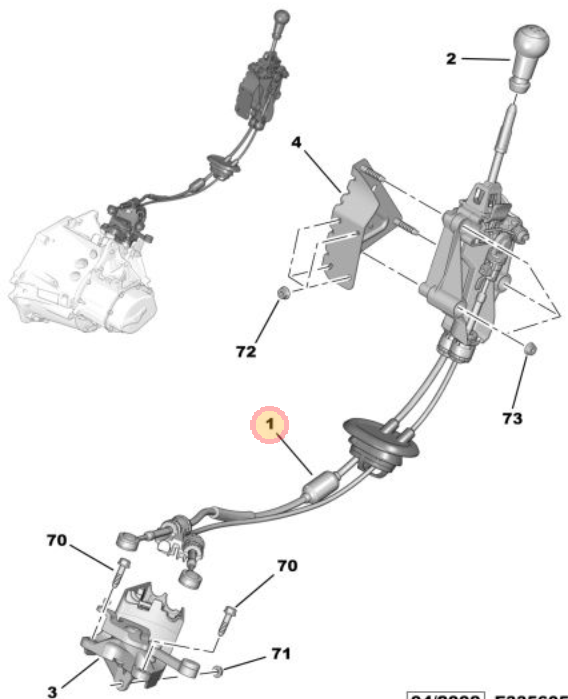

Can't remember if it was you or another member I replied to recently regarding a C3 Picasso and the gear control cables, but in either case on this model, there are no cables available separately. They come as a complete unit attached at factory to the actual gear lever as you can see, item (1) - so the separate picture top left is the actual part that is a complete unit.
(1) Gear Control Lever, part: 9803397380, £342.41
You're also correct about the tools - they are internal references from a set that the dealer will use often containing different variants for different vehicles, so not always available to the public.
However just google for a ball joint fork and you should find loads - one that will work for 10 mm ball joints is what you need if replacing it.
