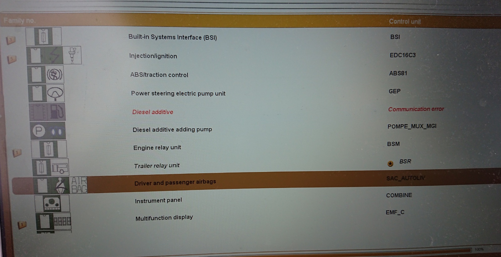

My 2008 307 Hdi 110 displays 'Risk of Particulate Filter Blocking' and 'Depollution System Faulty'.
I am an absolute Diagbox newbie, but a quick scan shows amongst others the error message 'Diesel Additive Communication Error'.
Can anybody please shed any light on what this message means? Does it relate to the Eolys fluid level, a faulty fuel cap sensor or is it related to the version of Diagbox (7.62) I am using?

Before going any further, you haven't clicked next to each of the ECUs that are showing multiple faults recorded.
I.e. The BSI has 3 faults shown, the injection system has 5 faults logged etc. You need to click onto each of these ECUs to expand the selection and show the actual fault codes.
If this is your first scan, I suggest you record the fault codes for each ECU where there are faults as explained above, and provide these here with your VIN so I know what systems you have.
Then, clear each of the faults, go for a drive, then re-run a Global scan and report back which ones remain.
The additive pump is a multiplexed pump and is not showing a fault against it. The communication error relates to the additive level, which may not be an issue, as the level is not physically measured, but estimated.

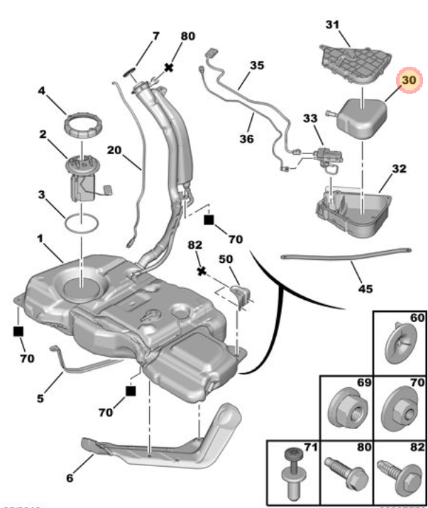

Your vehicle has a flexible pouch based system and requires Eolys 176 fluid specifically for this engine and vehicle.
(30) Additive Pouch, part: 9678080680, £211.57 from Peugeot.
However Neo Brothers have genuine 2.2 litre pouches for £83:
https://www.neobrothers.co.uk/car-parts ... 9678080680
With this sort of mileage your DPF has reached end of service life to be honest. It will at this stage need removing for a deep clean or replacing. Over the years, the Eolys fluid that is added to the diesel tank contains a Cerine compound that cannot be burned off. This, along with other engine deposits and ash also can't be burned, and it is these elements that ultimately clog up the filter pores.
So this is probably why you are getting a blockage message now we know the mileage.

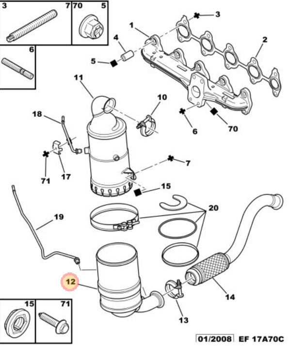

Put it this way:- The filter has done its job admirably at 150k miles and this is past the service life, so it really depends on how long you envisage keeping the car. It would have to be working if you want to keep it or sell it - so you could try a deep clean, but this can carry a risk if not done professionally (risk of breaking up the cement holding the filter internally) and will never be 100% like it was at new - but may give you a few more years life. The aftermarket alternatives vary considerably and the adage you get what you pay for is true here. They can vary incredibly on build quality and materials, so although may seem cheaper than an OEM, they won't be made to the same standard.
Details of the offerings from Peugeot are below and include brand new OEM, as well as cheaper alternative new ones and exchanges: (note this is for the particle filter element only and not the catalytic converter assembly at the top half).
(12) New OEM Octo Square Particle Filter (TR PSA F010), part: 1731JT, £1039.46
OEM Standard Exchange Particle Filter (TR PSA F010), part: 174037, £1045.52
Cheaper PSA Particle Filter, part: 1691076780, £589.93
Yes, this is right - incredibly the 174037 exchange DPF is more than a new one! Probably due to return shipping costs and processing / remanufacturing.
All VAT inclusive direct from Peugeot.
