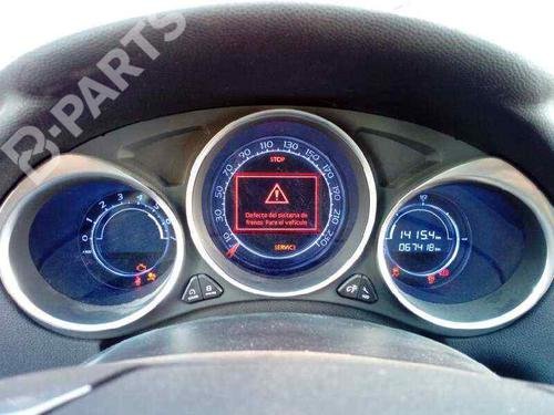

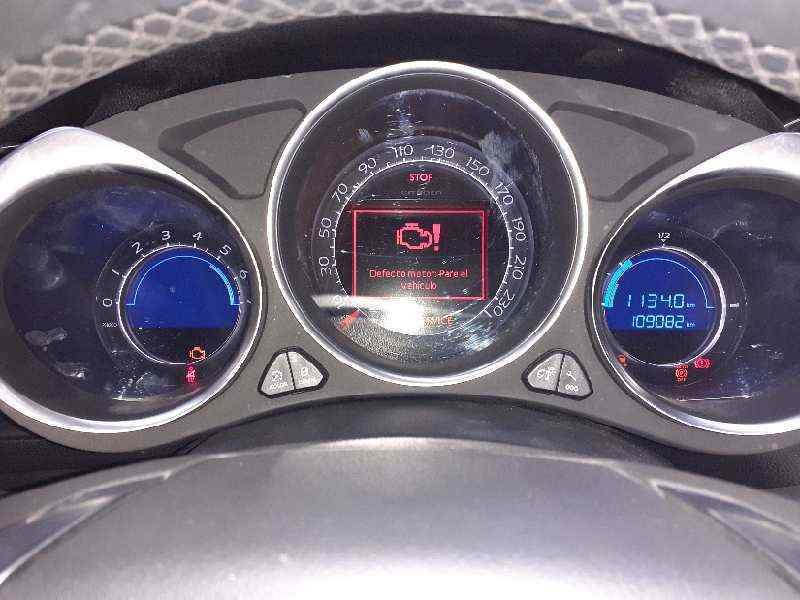

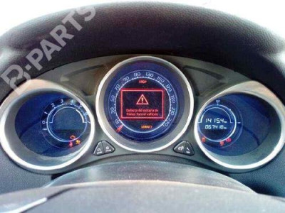

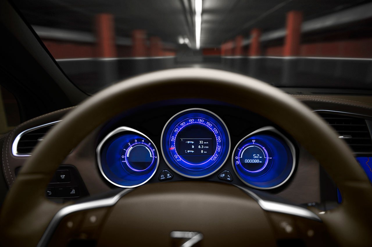

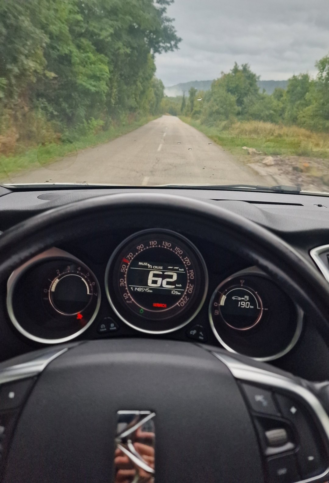

Hi everyone,
I recently installed an Android head unit in my 2013 Citroen DS4 1.6 HDi, which originally had a small monochrome display. The new Android unit comes with a CAN bus module and displays some vehicle information, but it looks a bit unusual and not user friendly. I'm wondering if it's possible to modify the software on the instrument panel to behave as if the car had the original OEM navigation screen. I'd like it to show things like error messages and trip computer data there, instead of only displaying my speed in huge numbers
Here are some photos I found on Google:
Any advice would be appreciated!

My idea is more about finding out if there’s a feature in Diagbox/Lexia that can activate the more informative version of the gauge cluster.
When sunlight hits the LCD at a certain angle, I can see all the symbols that my car never displays, like the ones for the automatic gearbox (D, N, R) – even though my car is a manual. It makes me think the cluster is capable of showing more information, but it just isn’t enabled. I could be wrong though. Just thought that it would be an interesting topic to discuss.
