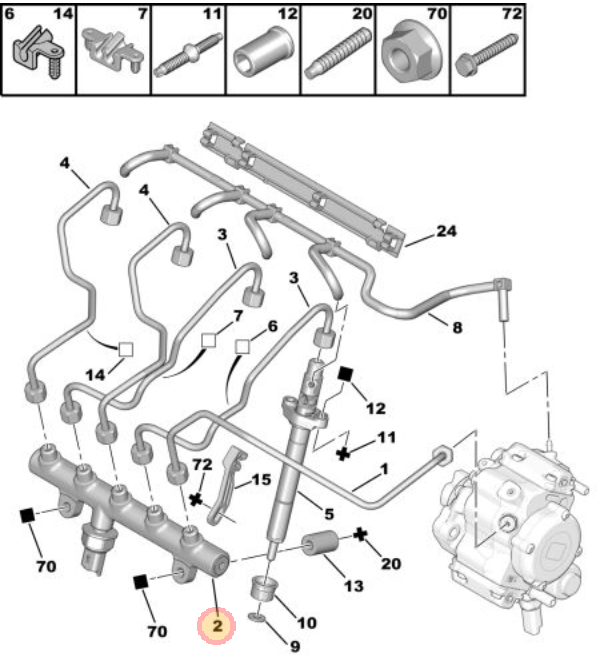

Re: C5 X7 Fuel Pressure too high
The fuel pressure sensor is not available separately on the parts database Steve, it comes as a complete unit, often due to issues with these if separated so they are fixed at factory on this engine.
(2) Injector Supply Rail, part: 1570L9, £366.18
and if this has to be replaced I hesitate to add that the injection Outlet pipes (3) & (4) should also be replaced as they are designed to seal when tightened by deforming slightly and if later removed and refitted, they often won't seal properly. That's the official line anyway.

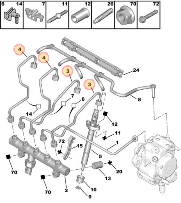

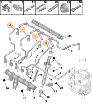

x 6955
(3) Injection Pump Outlet Pipe (for 1 & 2), part: 1570N0, £56.52
(4) Injection Pump Outlet Pipe (for 3 & 4), part: 1570N1, £56.11
