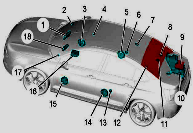

Note: Below shows saloon, there is no separate Tourer info, for RT6.
(11) is the amp for the FM1 and (8) is the amp for FM2, which likely boosts the signal from the FM2 screen printed aerial (12).
So if one is getting poor FM reception, I'd be looking at water ingress into the harness, or the FM1 or FM2 amplifier modules to start with.

Mike is right about the diversity function using the separate FM aerial, with the following RT6 caveat:
The radio navigation RT6 has 3 tuners:
