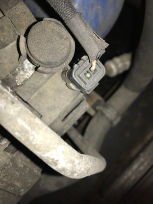

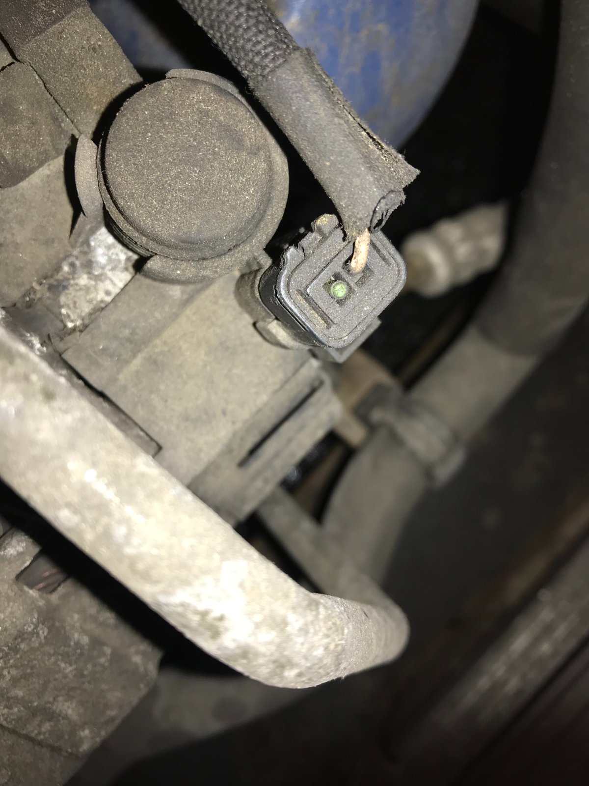

2004 Dispatch, The battery charge warning light is on continuously, battery is good, on checking the alternator I found this connector, shouldn't this be a pair of connections, the yellow is good but looks as though the green has been cut off ?

These alternators have only one control wire, so nothing wrong there. The warning light is controlled by the engine ECU, so there may be a relevant fault code present.
Try running with the alternator control wire unplugged, it should go into a backup mode and start charging. This will cause the engine ECU to log a different fault code.

Re: Alternator connector fault
Yes completely normal to have only a single IND wire on this vehicle however a Dispatch of this age wont have anything fancy like ECU controlled alternator. Goes straight to the bulb on the dash.
What is the voltage at the battery with the engine running & again if you measure it on the main + connection on the alternator & put the earth of your meter straight on the alternator casing?
It is indeed a single wire, and it does look like a wire is snipped off. Alll normal.
Interestingly, I had a fault with that connector on a Berlingo just this past week, it was logging faults,
P065A Alternator mechanical fault
P0A3B Alternator temperature fault
P0A1A Alternator communication fault
U1401 Alternator LIN network.
Using a pick to tighten the pin of the connector resolved it.
