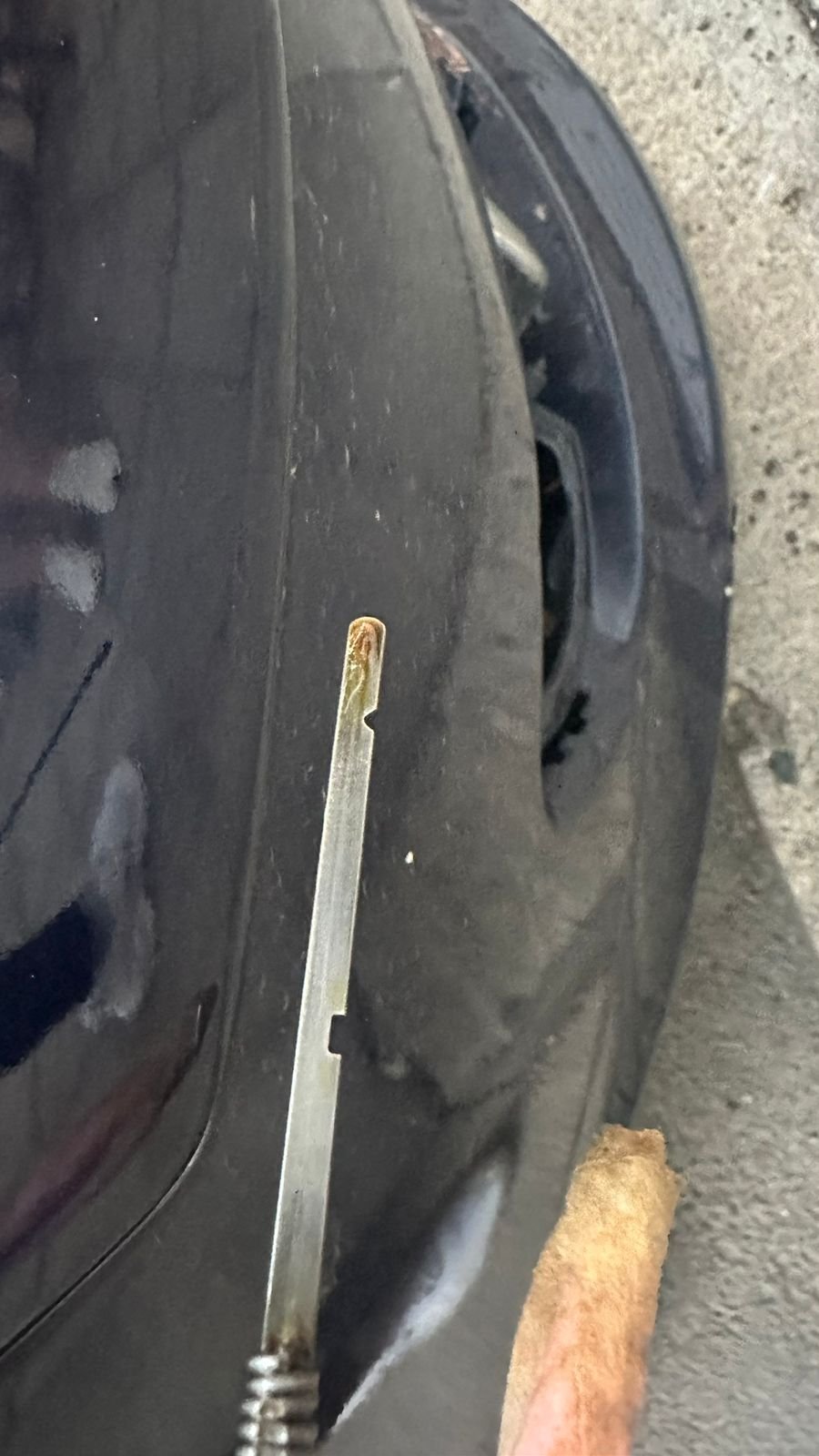

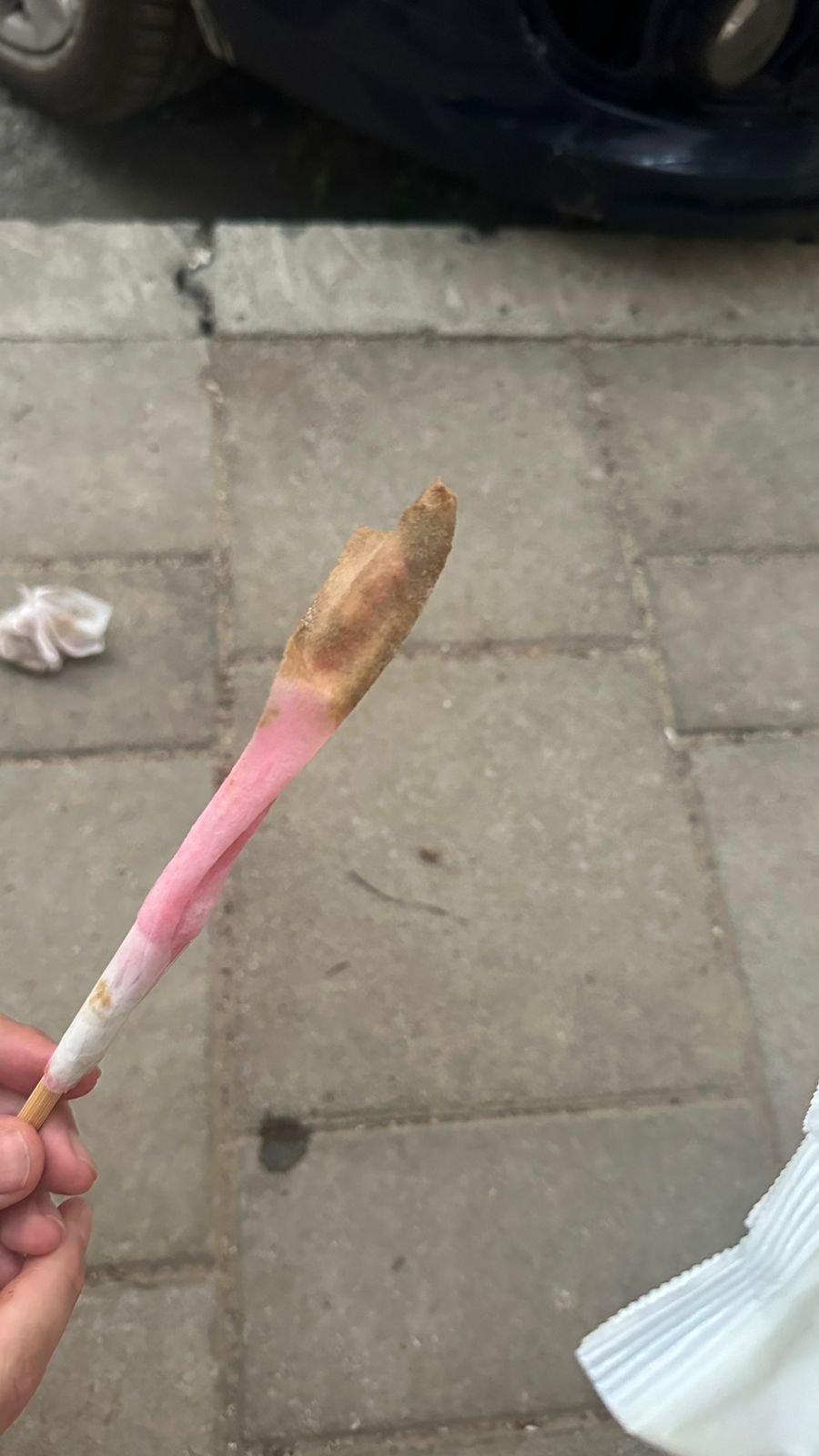

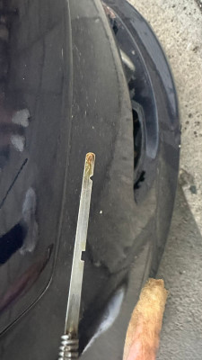

Hello all!
I have a problem with my Citroen C4 2005 2.0 petrol (with lpg system).
I have seen that the coolant is dirty with oil probably but the dipstick looks clean. I have had a problem half a year ago with the oil radiator that was leaking oil in the coolant but it was changed with a new one.
Im a bit confused if it can be the head gasket or the oil radiator again. I will be taking it to a mechanic but id like some advice first as i dont wanna go clueless. So far the temps looks kind of normal but i dont want to overlook this problem now. A few images attached for additional info.
Thank you!

Update on this matter
I spoke with the mechanic and they told me that the oil must be remnant from the time i actually head this problem and even flushing the system a couple of times would not entirely solve the problem.
I have driven quite a lot now and it seems that there is no problem.
The oil was actually on top only and if you can see the first pic half of the stick has oil and the the lower half is clean with the red coolant.
