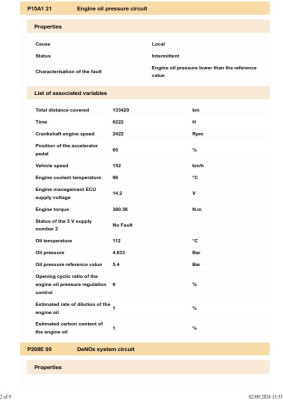

This came up in highway when i accelerated.Service light and repair needed in dash.When i stopped in traffic light, shut down engine and start again and everything gone. In diagnostic report as follows. The oil i use is Raxol 0w30 https://www.raxol.eu/en/product/tiger-c2-psa-0w30/390/ and genuine PSA filter (Made in Tunisia..). 7.000 km on clock.Car has 133.000 km. There was another code P208E which i didn't know in 130k but i had already treat it with adblue additive. My hope is on oil pressure Control Solenoid https://www.youtube.com/watch?v=FPY75WRL_dE known to fail but i had nightmares about oil pumps last night. My VIN is VF3**************[VIN obfuscated, can be read by forum staff].

Your oil grade is correct (0W30) and should meet the following PSA specifications: B71 2312.

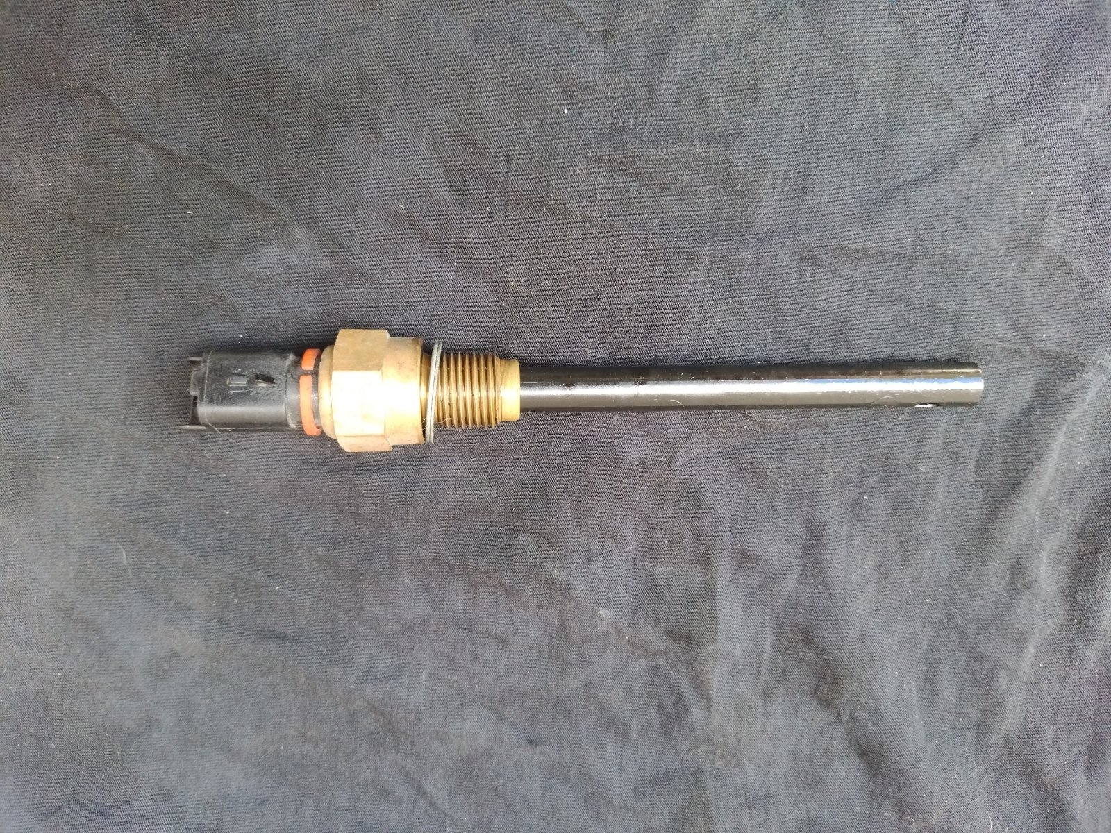

Update.Low oil pressure is one of these things that nobody wants to see on dash and requires to fix it ASAP if you are lucky.So after checking the obvious things like oil filter good fit, oil regulator solenoid, oil pressure sensor e.t.c, i found where the 1 bar loss of pressure went after accelerating. Connector plug of oil temperature, level or whatever is it, nice and oily with 0w30.

Re: P15A1 Engine oil pressure lower than the reference value
It's your oil gauge - info replied to on your post on the parts thread.

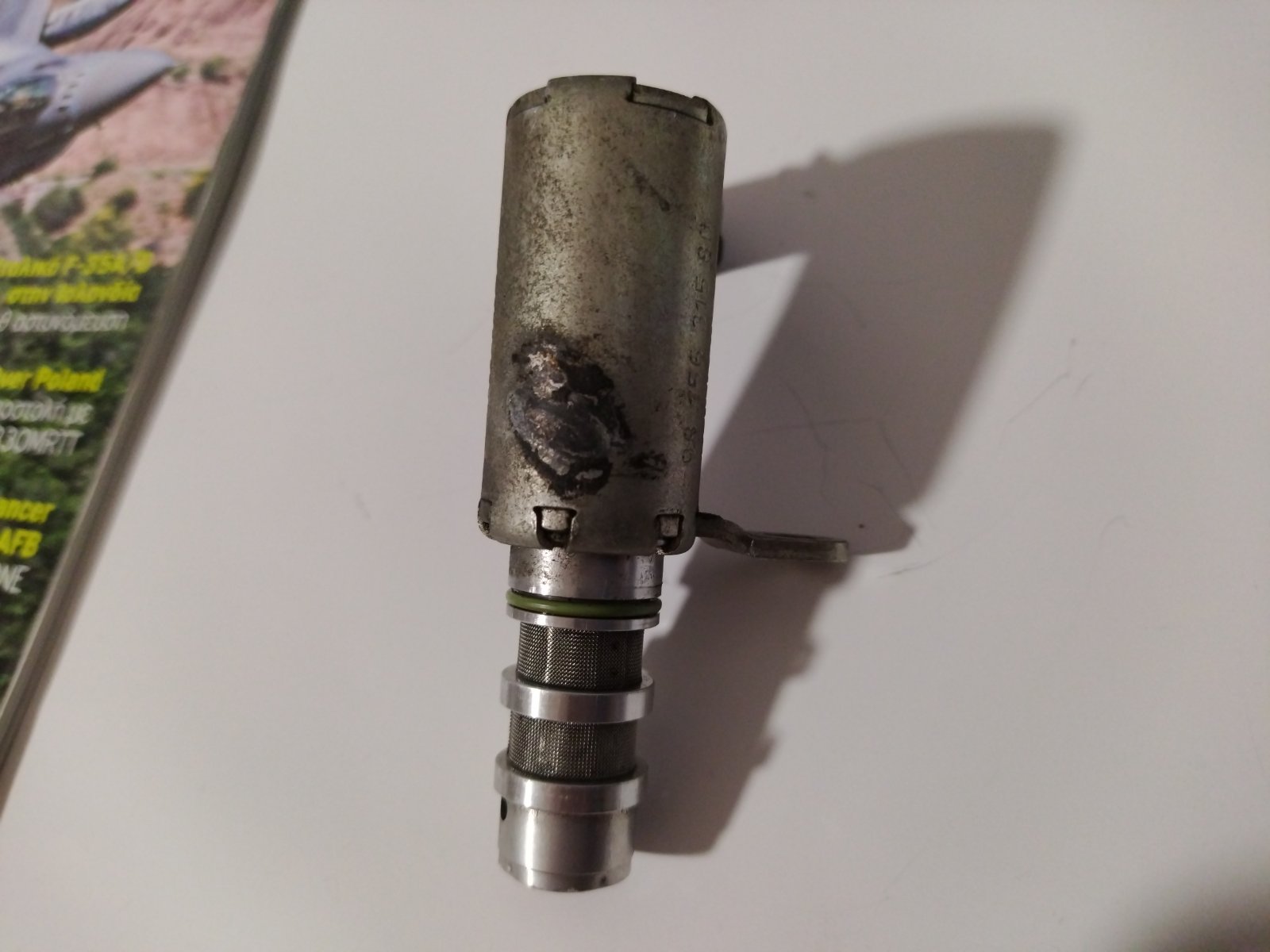

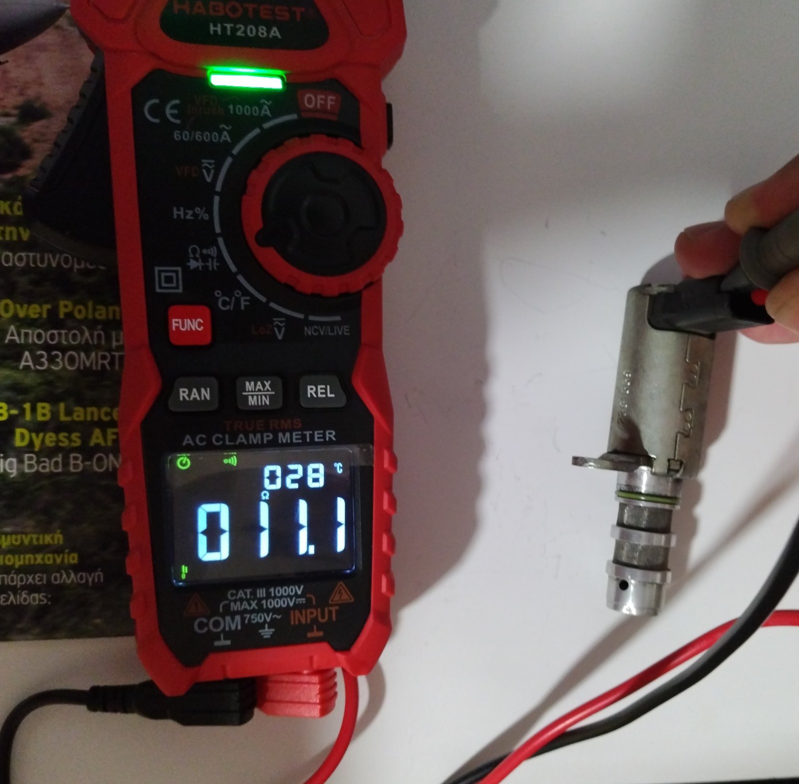

I'm updating the post cause i'm pretty sure that oil gauge wasn't the main reason. I changed the oil gauge. Car starts and everything looks ok. But i didn't test a ride in highway cause of tight schedule and i have other daily cars. I pressure test yesterday the faulty gauge and it seems ok.Nothing bubbles in connector plug pins when pressurized. Maybe it happens under increased engine temperature. After second thought i couldn't figure out how a small loss of pressure in oil pan (which isn't under serious pressure) can cause a dash oil pressure warning.The pressure sensor measures after oil pressure solenoid in oil filter passages. When i unplugged the oil gauge plug connector, it was some amount of oil that seemed to be there through penetration of oil gauge into plug connector resin and maybe cause a short to pins and trigger the warning. But it wasn't the only "smoking gun". The oil pressure solenoid, which was the main suspect seemed defect from high temperature coil as shown in picture. But it passed all the tests! I tested the ohms which was 11.1~3 (normal values 8-12), ground test and shorts and energize it with 12 v. Everything o.k. So it looks like show goes on..

I have had defective dephaser oil control solenoids in an EP6 turbo petrol engine that electrically tested ok but were mechanically defective. I cleaned the hydraulic component in an ultrasonic cleaner ( solenoid standing in a Vegemite jar half- filled with kerosene, bath filled with hot water). Had to change the kero several times). They have worked fine in the months following.

I had the same thought that's why i did a good clean to oil regulator solenoid with brake cleaner.It was already in mint condition without oil dirt or metal swarf and tested ok with clear clicking when i energize it with 12v.But i didn't like the look of metal enclosure.It looks like defective from something. At the first opportunity i'll change it with an original one because they are known to go bad. I did around a 1k Km trip last days and everything looks o.k. I even simulated the driving conditions when the warning happened and nothing. So it looks that the oil gauge was the problem.

Update #3.
As a conclusion and final update for this matter, i confirm after continuously P15A1 fault more and more often, that the defect item is the oil valve solenoid/regulator 9815631580. A known issue in these engines with turbo and engine fatal damage just from this critical part. So, have in mind.
