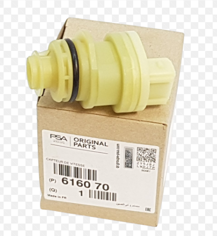

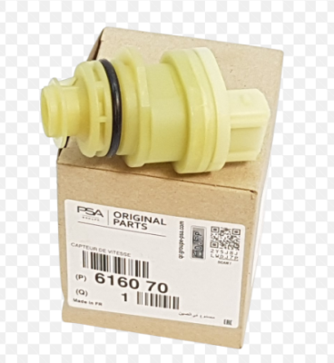

Ok, so as I thought this vehicle is a 2001 1.9 DW8B, and doesn't have ABS or ESP, yet alone a touchscreen!
So it's likely the speed sensor needs replacing if the actual speedometer is working correctly - in the sense that it's rising and falling properly and not randomly dropping back to zero or all over the place.
On a 306 it's here - so should be in a similar position:
https://www.google.com/search?q=Peugeot ... NhTGo,st:0
Looks like this:
Be advised you'll get some oil coming out when removing and replacing.
Looks like this:

Is that the part number I need as in the photo mate? You are correct in thinking the speedometer works fine it does just that, no dropping or bouncing, (like my Grandad's old C15 van!!), it smooth albeit 20mph out of synch.

Yes, you're lucky that the picture I included just so happened to show the correct part number....

I can't see it being anything else Danny, because if it was the speedo itself, I would expect that to show erratic behaviour. Let us know how it goes.
