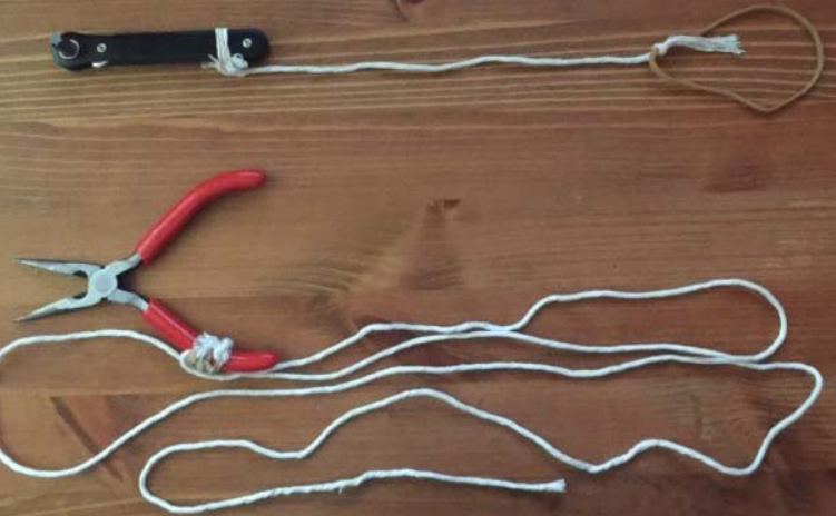

Where were you 8 years ago when I did mine??? Beats my string round the wrist tied to the torx tool! :-D

Re: [C5 X7] 3D printed keys for HP24W halogen DRL replacement
Unread post by the-termin8r »
I tried a similar method of zip tying the T45 to my ESD strap, but it just slid off the zip ties. LOL
I just found that post....
https://www.frenchcarforum.co.uk/forum/ ... 87#p464087
Those were the days... :rofl:
