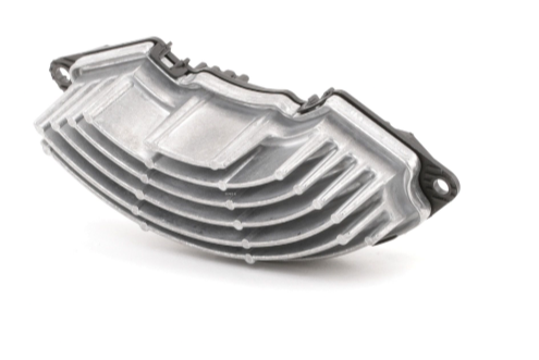

- changed the resistor that sits into the bottom of the fan itself and also checked voltage. 13ish volts down the live feed which is then passed through the resistor and out the other side to the fan itself with no voltage drop. Smaller black square plug has no voltage at all under any circumstances. The resistor isn’t a cheap Chinese one, I deliberately looked for a decent one which ended up coming from AUTODOC.

So just to confirm this is what you've replaced?

Unread post by 8v_chris »
Yes although his was a different shape, it’s the squarer type with him not having automatic air con. He doesn’t have the digital screens controlling temp either side, just the twist dial
His was this shape -
x 6946
Re: Constant blower fan at full speed - Citroen C4 Picasso
Yes, that's the one. Just wanted to make sure - I used a poor picture previously.
So if this has been replaced with a decent branded replacement, I would be looking to the actual control unit on the Driver's side. These are still electronically controlled, but are no longer available new from Citroen.

Solved: Constant blower fan at full speed - Citroen C4 Picasso
SOLVED!! So it turns out the it had the wrong blower motor fitted and therefore the wrong resistor pack in the bottom. I swapped it out for the other type of resistor and blower motor and it’s back to normal so I guess that was the issue from the beginning and it also explains the reason the the plug on the loom for the motor appeared to be the wrong one.
