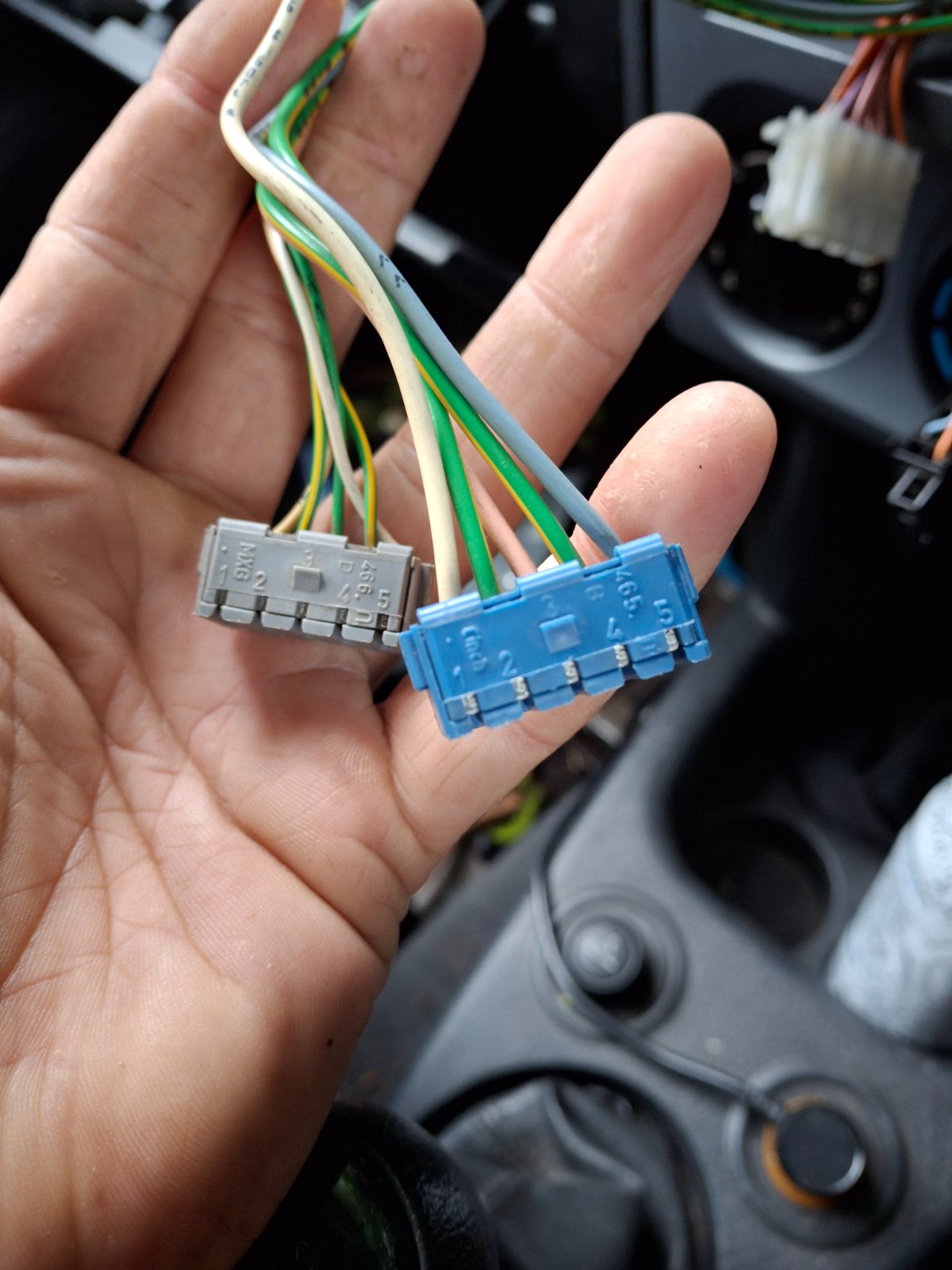

Hello all can someone tell me what I need to do here I have a 2007 peugeot partner 1.6hdi and trying to put a original radio in as I've been told this could be a reason why my fob not working to lock car remotely. But I am stuck with these wires it had an aftermarket radio in when I got the van and the grey and blue connectors where not connected to anything now i am pretty sure these are for the top screen and steering wheel stalk but there is no where to connect them to on the original radio help would be much appreciated

The connectors in the bottom picture are not from the radio.
They look like they are from one of the switches above the radio, i would have thought the one with the thicker wires is for the electric windows, are both the windows working? the other one may be from an unused switch blank like ESP for example.
On a side note aftermarket radios do not cause problems with the central locking, its the incorrect fitment of them that cause issues.
If the Radio fitment was causing the problem then just by disconnecting it should get it back working again, a radio does not need to be fitted to get the remote central locking to work.

Thanks for your reply on my van I don't have electric windows and the blank buttons on the front of dash don't have them connectors plus they already have wires in them, but when I put the original radio in it does not connect with the screen on the top of the dash so I am unable to put a code in this is really driving me mad lol it's like I am missing a wiring harnesses for them wires to go into the original radio

The blank switches dont have connectors as such, the just have little clips that hold the connectors on the back of them.
The 2 plugs in the lower picture are 100% nothing to do with the radio, Look how thick the wiring is in the blue plug. Now that you have confirmed you dont have electric windows im 99% sure thats what the blue plug is for.
What do you mean cant put code in? There is no radio code on these, the radio is programmed to with the cars VIN, this is done via a diagnostic tool. Even if you have the wrong VIN programmed into the radio the radio would still work but you would get an annoying beep every 5 seconds or so.
Have you checked all the fuses?
