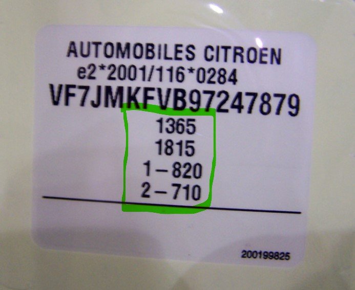

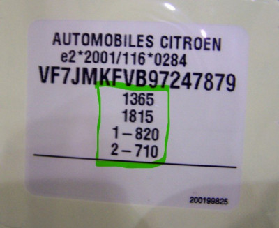

Look at your VIN plate/sticker, there should be 4 weights listed on it. If the first 2 rows of weights are the same number or the second row doesn't have a number at all the the vehicle is not approved for towing.
However, you have not said what you want the towbar for? Some people use towbars for things like luggage boxes or bike carriers.
The mk1 Citroen C1 for example is not approved for towing however it is still possible to buy a towbar for it, technically if you are using it for an off the ground bike carrier or luggage box then you are not actually towing.

In case someone else is looking for this information later:
The XL version is allowed to tow 750/750kg until 2022, and 0kg/0kg from 2023 model year onwards.
The M version is allowed to tow 750/750kg regardless of model year.
The VIN plate has a hyphen (-) instead of a tow masses on the later XL models.
