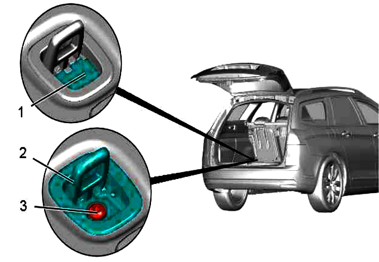

There are two cargo fastening eyes behind rear seat, left and right, and those are also keeping the rear trunk floor panel attached?
How to remove those/ how to remove rear trunk floor panel?

To get the boot carpet out, you'll need to undo the bolts and remove the hooks as shown:
First lift the cover at (1)
Remove the exposed Bolt (3)
Remove the Hook (2)
