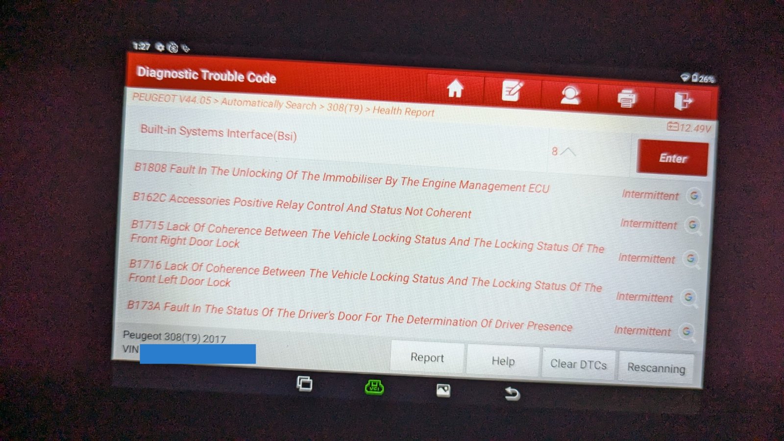

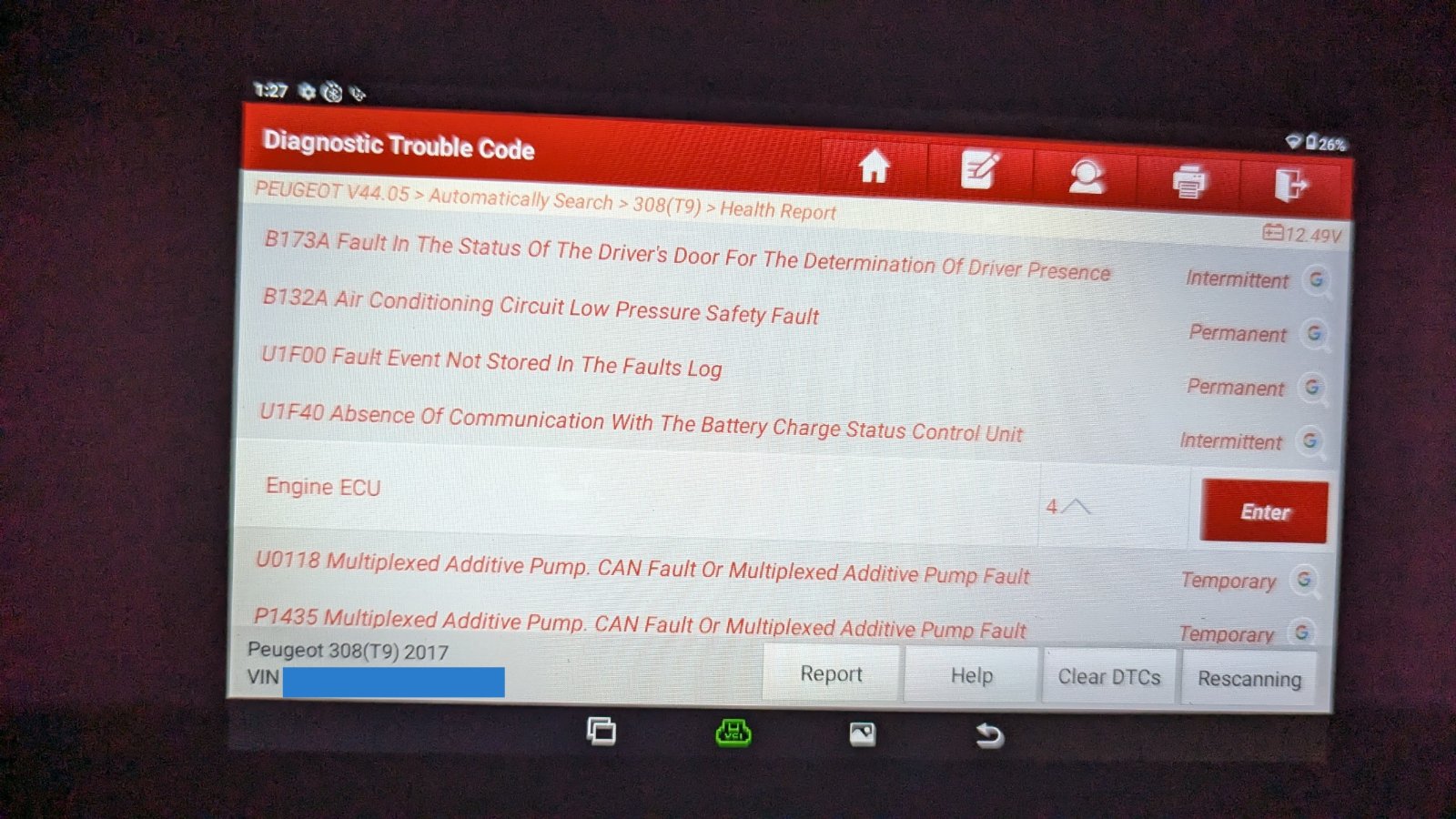

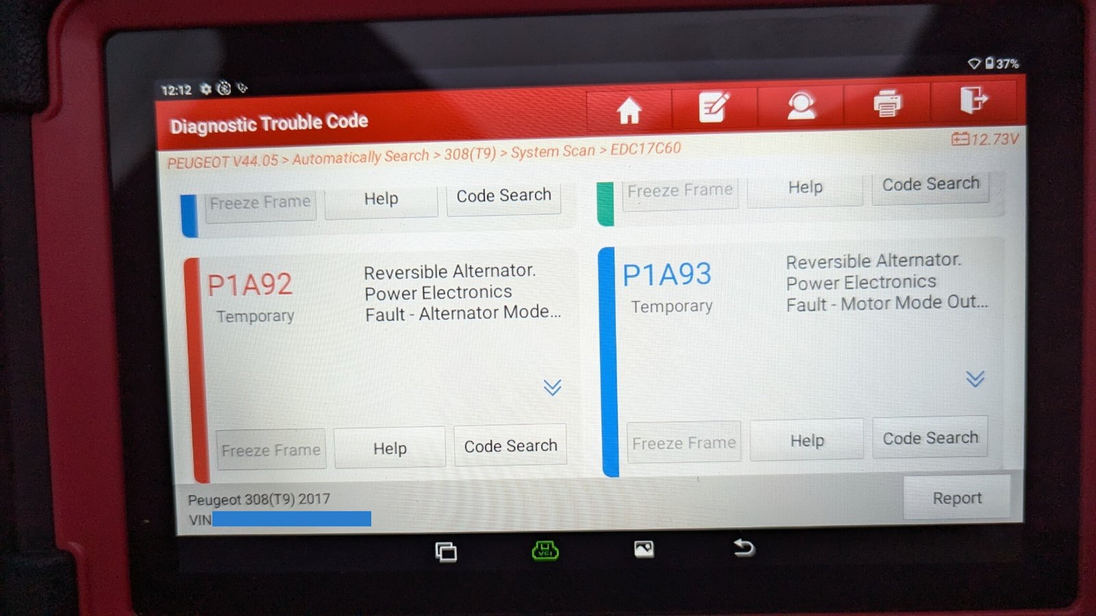

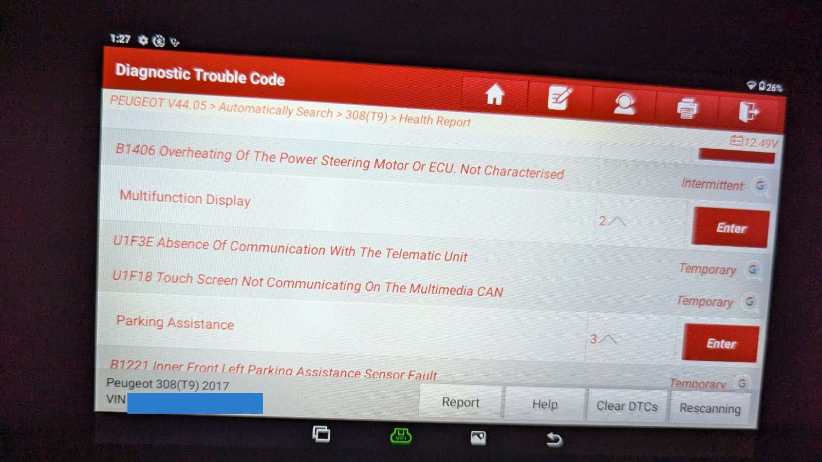

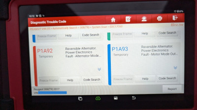

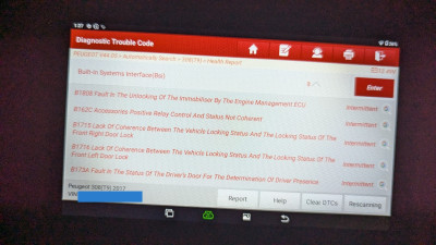

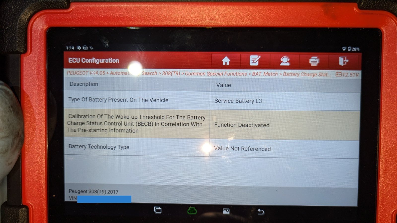

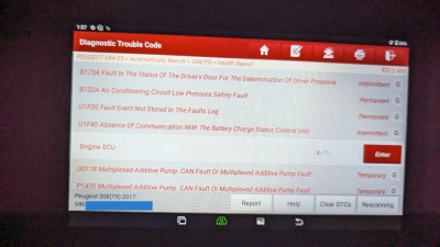

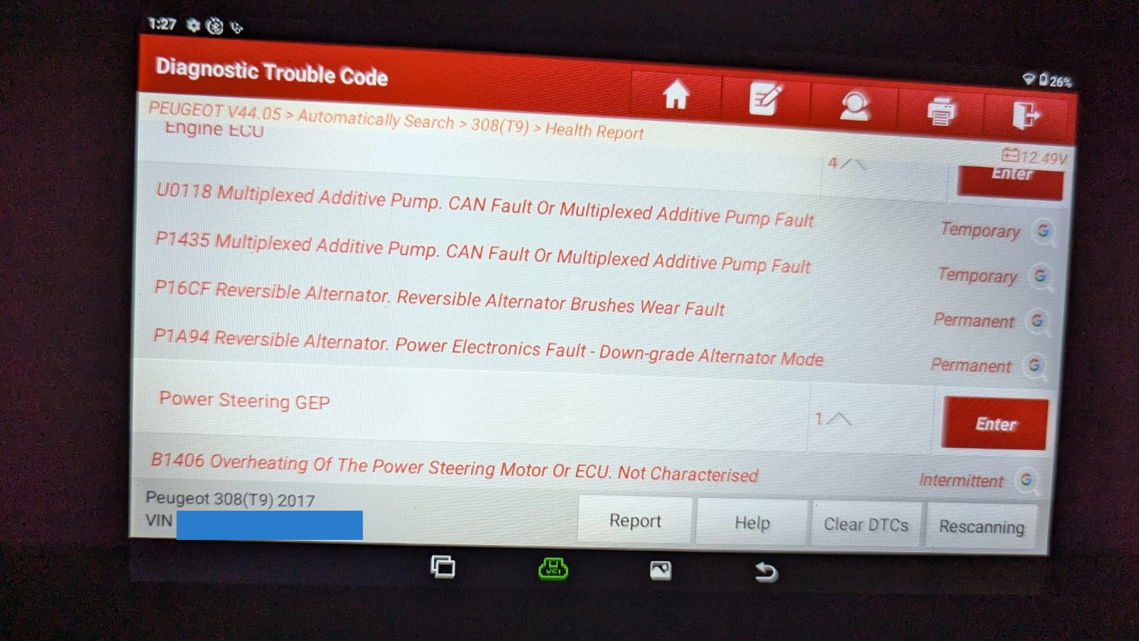

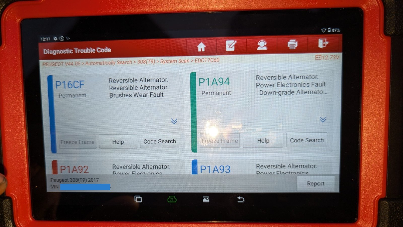

My mate has plugged a diagnostic computer in and the live data shows some alternator output activity which then flatlines after a short amount of time. I will also attach photos of the fault codes, which suggest the brushes have gone (I'm guessing in the regulator?).

Has the battery been replaced? is it the correct chemistry and rating for the car?
If the battery has less capacity than the ECU is expecting, the ECU can allow the battery to run flat before enabling the alternator to charge, because it thinks that the battery should still have reserve capacity.
G1980
- Posts: 4
- Joined: 22 Aug 2024, 22:05
Re: 308 T9 2017 Battery Charge Fault
Hi there, yes the battery is AGM and of the same capacity with a manufacture date of July '23.
