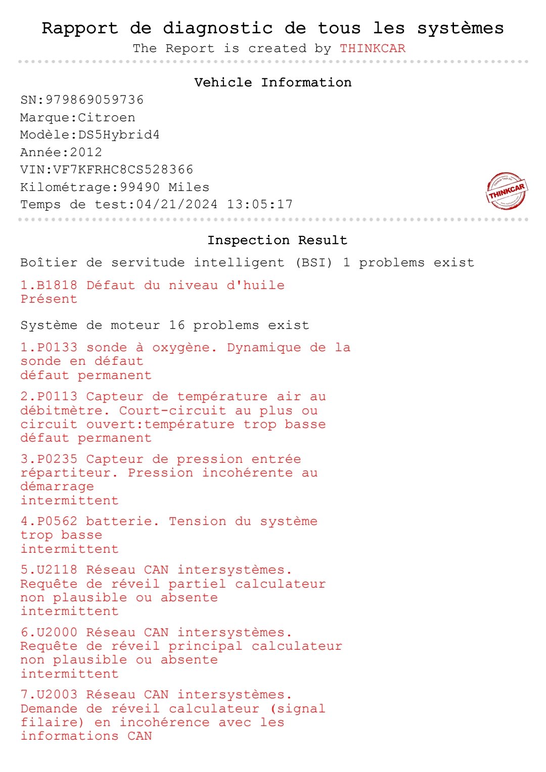

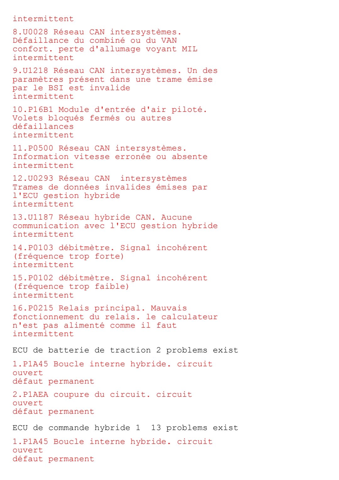

Do you have a diagnostic system to read fault codes and live data from the ECUs?
x 6950
Re: D5 hybrid4 challenge
You should be aware that Hybrid vehicles have very specific technology - apart from the traction battery, the drivetrain and cooling and electrical systems, many of which require specialist training on to be able to diagnose and repair.
So you may not find much in the way of help for these specific vehicles on this Forum, however, to provide any sort of help we would need the diagnostic error codes and the VIN, as long as there aren't too many...

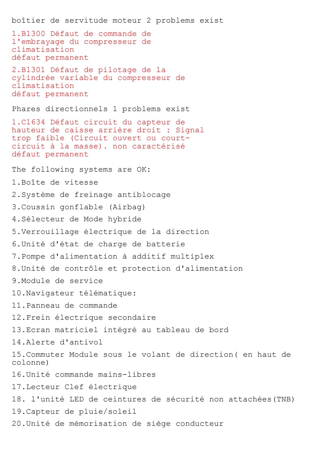

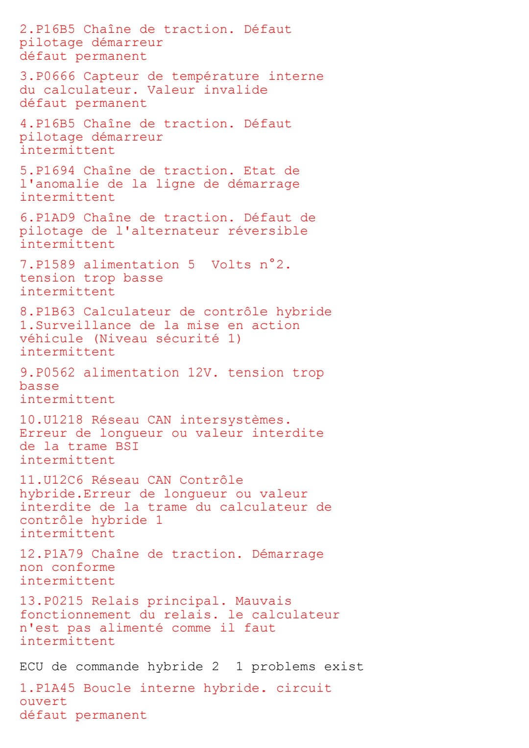

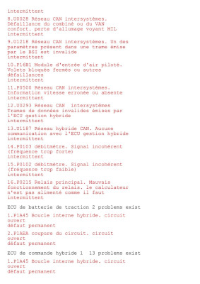

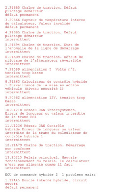

I do
But all are in French hope you would understand it
