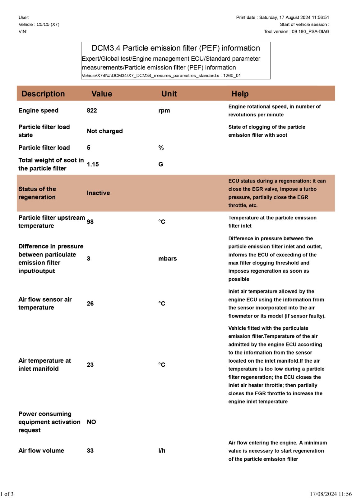

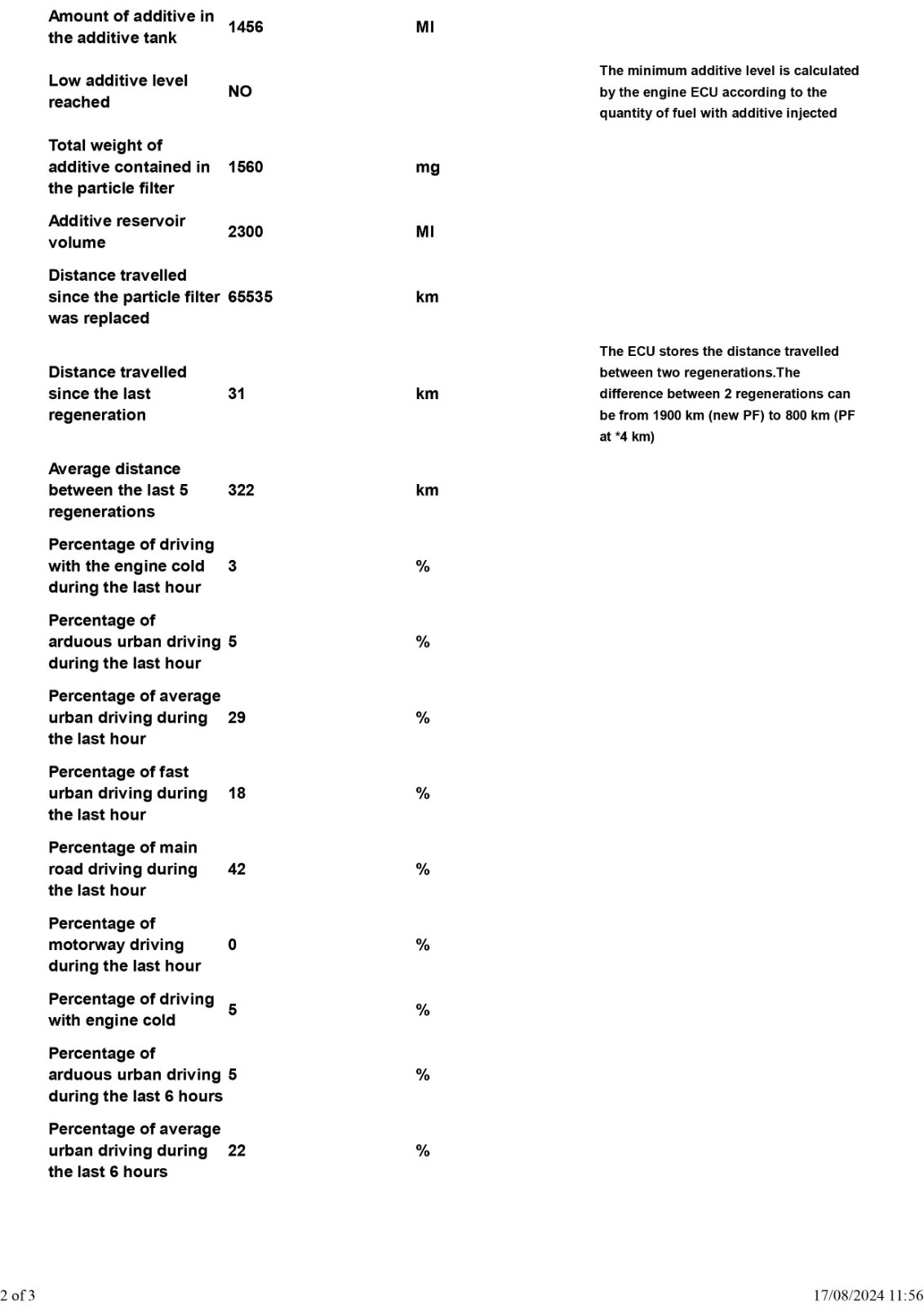

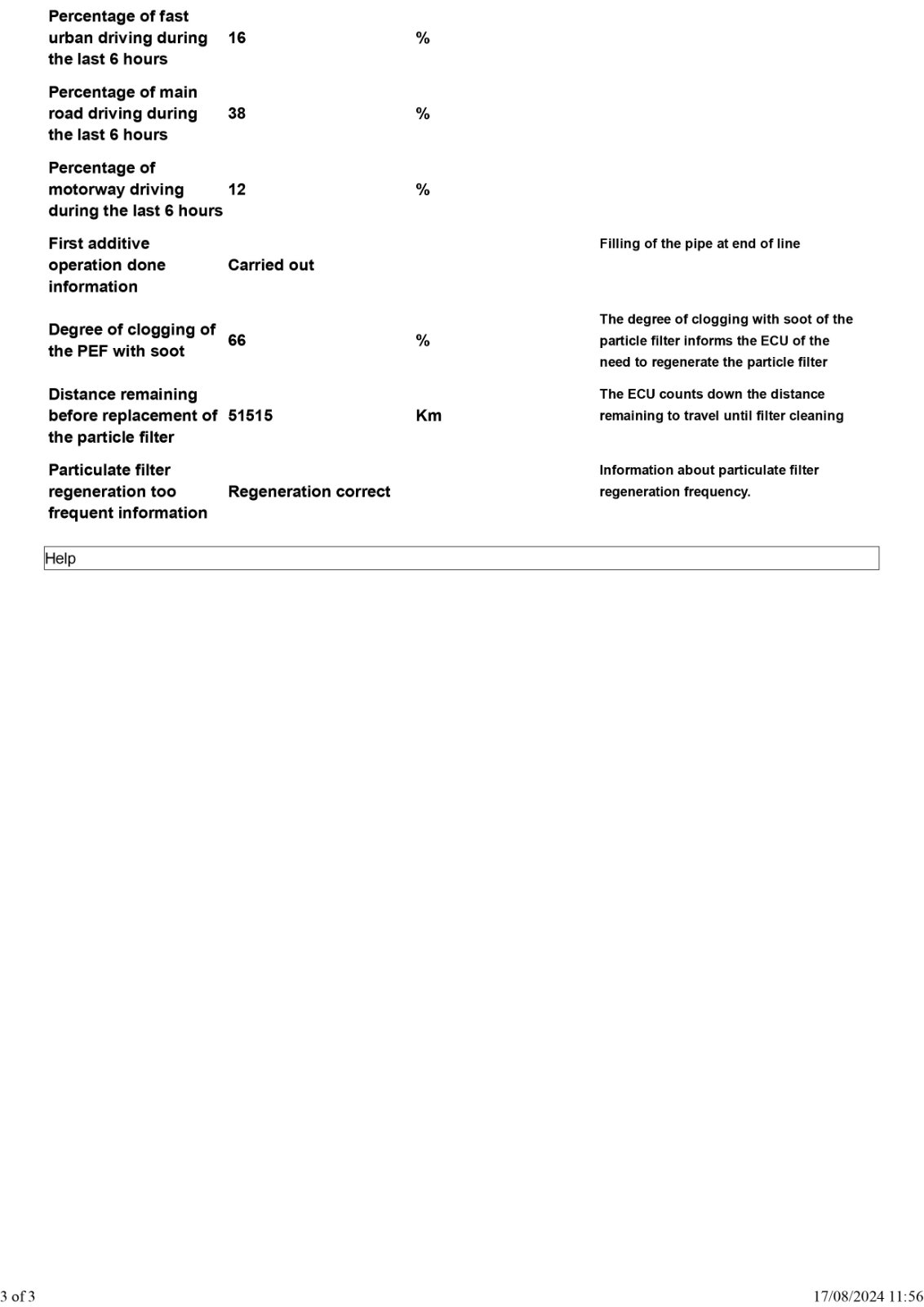

Re: Car Scanner Pro DPF readings
It probably doesn't help but these are what I get for my C5 from Diagbox for comparison
- x 6946
Thanks steveclv. Your numbers seem to correlate. My app also doesn't report distance since last regen.
I do see:
~25mbars at 900 rpm idle
~150mbars at 2500rpm (72mph) on level motorway.
These seem elevated to me, but that is only based on a graph I saw for a non-specific engine.
That would seem to be quite high - typically you want < 10mbar backpressure at idle and no more than 100 @ 2500 rpm.
The soot level seems high as well although grams per litre (g/l) is confusing me however as Marc pointed out, if it is at the point of regeneration then they would all make sense.
