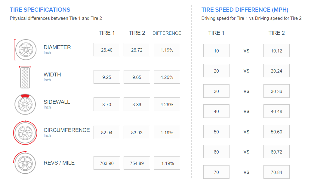

The DS5 was notable for it's poor ride - mainly down to the suspension, but having low profile tyres will only add to the poor ride quality.
It's my understanding that as long as you are within 3% of the diameter (height) of the originals - assuming these are factory specs.
The differences for 245/40/19 would be under tyre 2:

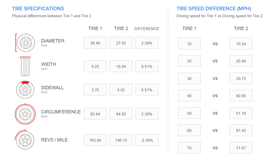

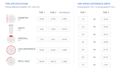

and for 255/40/19:
But I would check with a tyre expert before ordering on this basis to be sure.
Also you may possibly get an ESP error if the speed measurements are out of tolerance.
