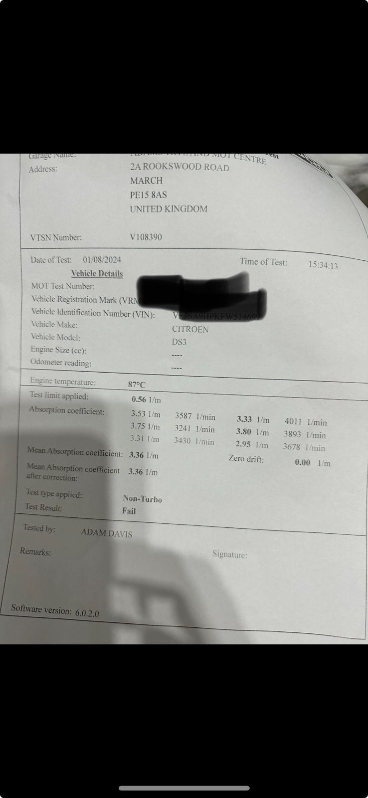

I have my car back from the Garage. He essentially gave up, but didn’t charge me either bless him.
Attatched is the MOT sheet.

As an update. Turns out the car was mapped and over fuelling.
The Citroen specialist charged me £800 to remove the DPF and pressure wash it, change the oil twice and apply an update from Citroen. Car passed the MoT.
