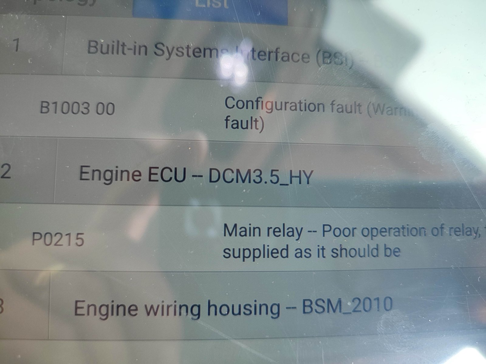

After all faults cleared only shows a relay issue. I have the screenshot but don't know how to add on here? Will try to add now.

I have several pure electric cars and have the diagnostic equipment for everything to do with re-progamming and battery cells work as well as airbags, key coding etc. Maybe certain parts of the system are locked out without Peugeot's specific program.
