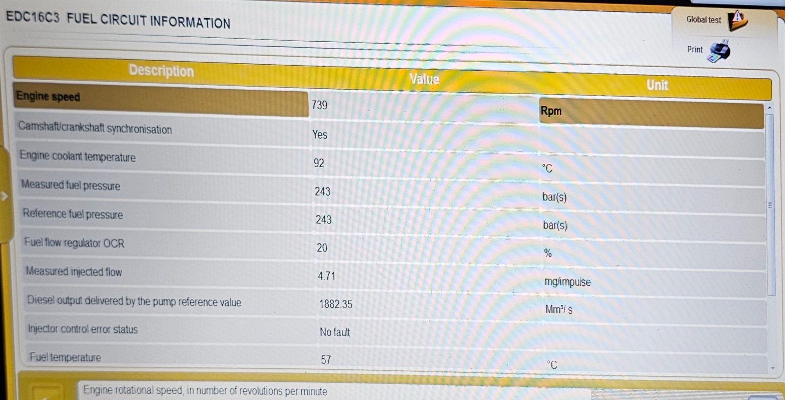

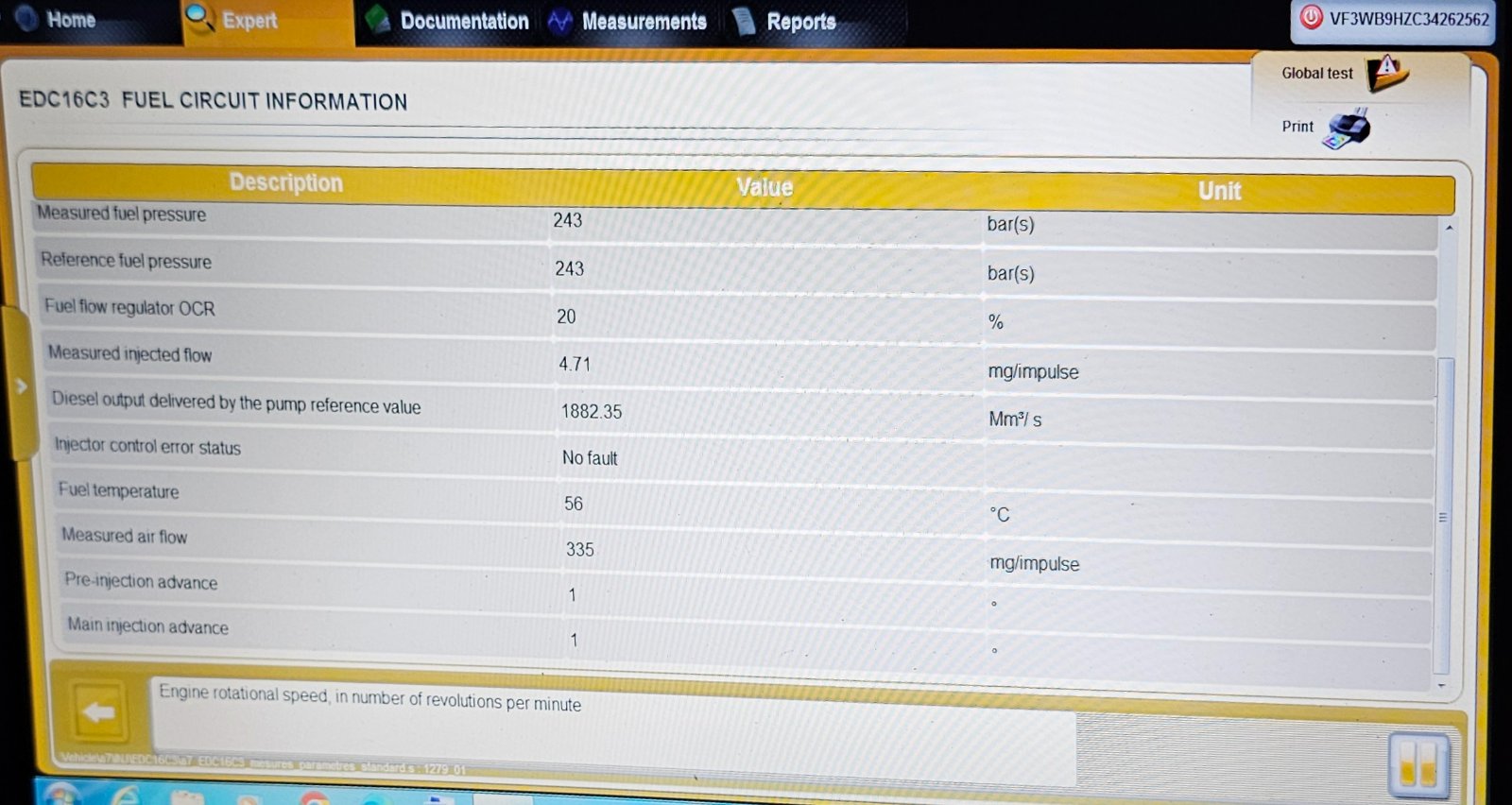

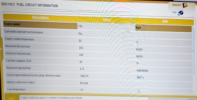

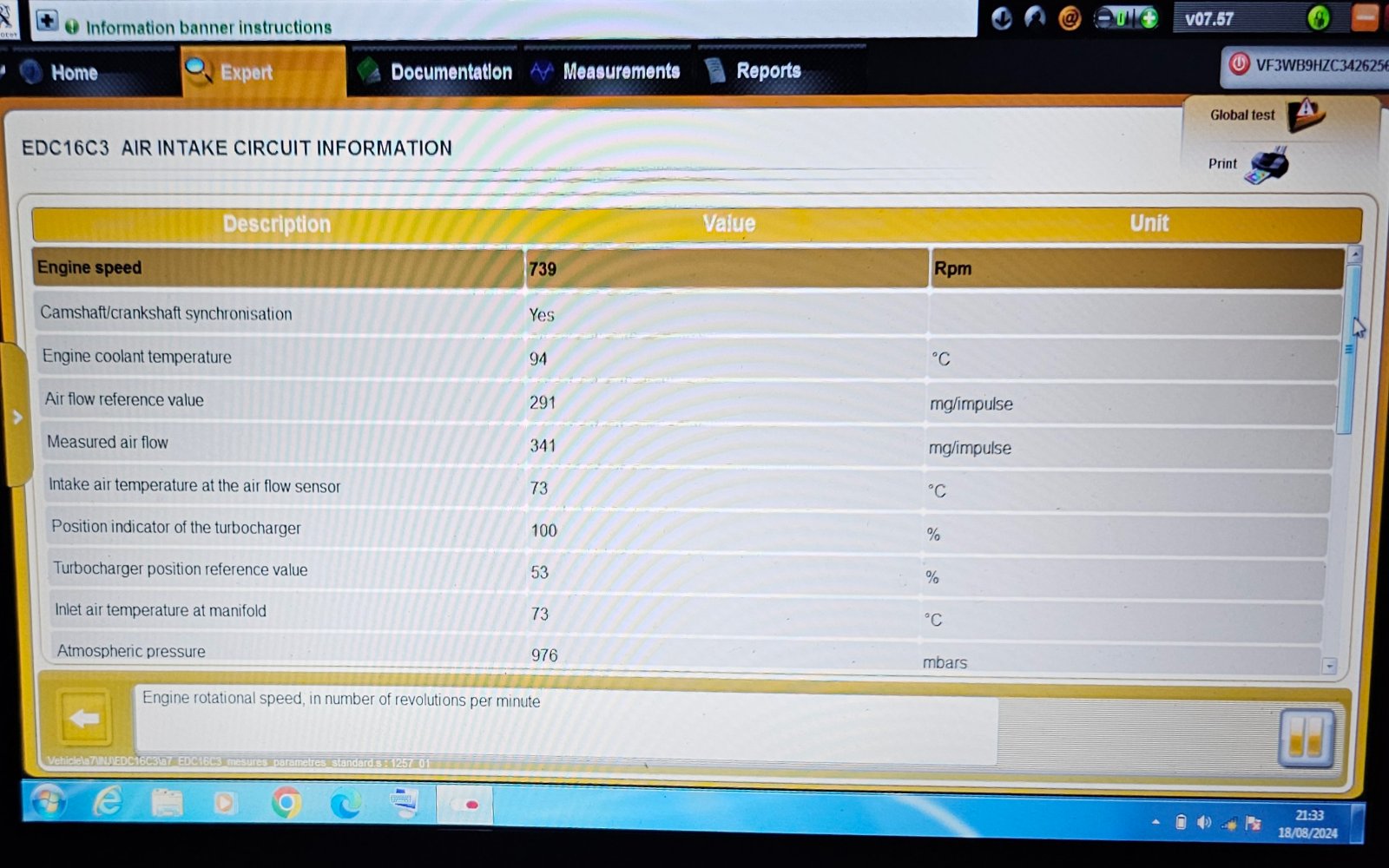

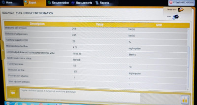

Somewhat of a partial update to this. I've got flu or covid dragging me down so not been out today but earlier yesterday I had to go out and drove it. It seems I can get the engine shake if I drive with a bit of vigour.
I haven't had a cut out yet but when I felt the shake coming off a bypass onto slower roads I pulled in to the side. I could feel the wobble for about 30s and then it suddenly stopped.
I pulled off and at the end of the journey the wobble was back. It took about 5 minutes idle to stop wobbling. I gave a rev up to 3k for 10s and the wobble came back bit only for a few seconds.
I connected up lexia (although no symptoms at this point) and couldn't see anything untoward but I couldn't see a display for individual injector compensation unlike my other vehicle.
Disclaimer - I'm aware my VIN is visible in the pics but I'm not bothered
307 CC 2.0 HDI
Sold/dead
Mk1 Dispatch 06 Face lift - 2.0 HDI - RHZ (sold)
2x xsara picasso 1.6 HDi
2x mk1 C4 Pic and a mk1 C4 GP
1x mk2 C4 Pic
C8 2.2.hdi (6 seat Exc) van/can
207cc 1.6 hdi (project)

In the first one it says Turbo 100%, vs reference value of 53% which doesn't look right. Does the figure move about if you rev it?

Oh yeah you're right, I'll have to check that out and post what I find.
Looking at those values, the coolant temp seems high for a hdi too, it had been on a good run but that's night time, had driven through a village for 5 minutes and been idling for 5 minutes.
Also the inlet temp at the air flow sensor matches the temp at the manifold (73 C) that doesn't seem correct either unless both are at the Doser not the MAF?

RichardW wrote: 19 Aug 2024, 17:59 In the first one it says Turbo 100%, vs reference value of 53% which doesn't look right. Does the figure move about if you rev it?
OK, turbo comes down when I rev, reference does not budge.
I assumed this was for the actuator so also disconnected vacuum to make actuator rise but this did not affect either reading.
