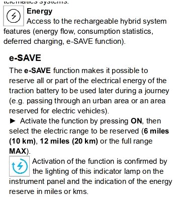

I have a Citroen C5 X Hybrid. New around first quarter 2024.
I know that it can charge via the cable/plug and also charge via regenerative charging.
However I notice that if I set the car to "save" battery for 10 or 20 km range (usually after I am at around 0% charge left) then the car will charge rapidly while I am driving.
Fuel consumption goes up so it is the gasoline engine providing the energy.
I do not see this feature anywhere in the documentation.
Question is, is it OK for me to charge this way (I know that it is inefficient)?

Hi, the e-save option stops the battery from fully discharging so you can conserve energy for use later, ULEZ or if you get home late!
The owners manual says that is you choose the e-save option and if the battery is not at the required level it will use the engine to charge the battery to that level, but the fuel consumption will be affected. I have not tried in myself, but there is an opinion that if you put switch the car to "Power" then this charges the battery more efficiently than using the either the "Comfort" or "Hybrid" Options, as I have said I have not tried it yet!

Owners Manual "e-Save function (energy reserve) page 23"

Thank you both.
What you said Stu matches what I have seen. Though I didn't see the bit about the battery recharging while driving if it was below the selected e-save value.
It actually continued to charge above the e-save percentage and it charged it much faster than via the cable, which was a surprise to me.
