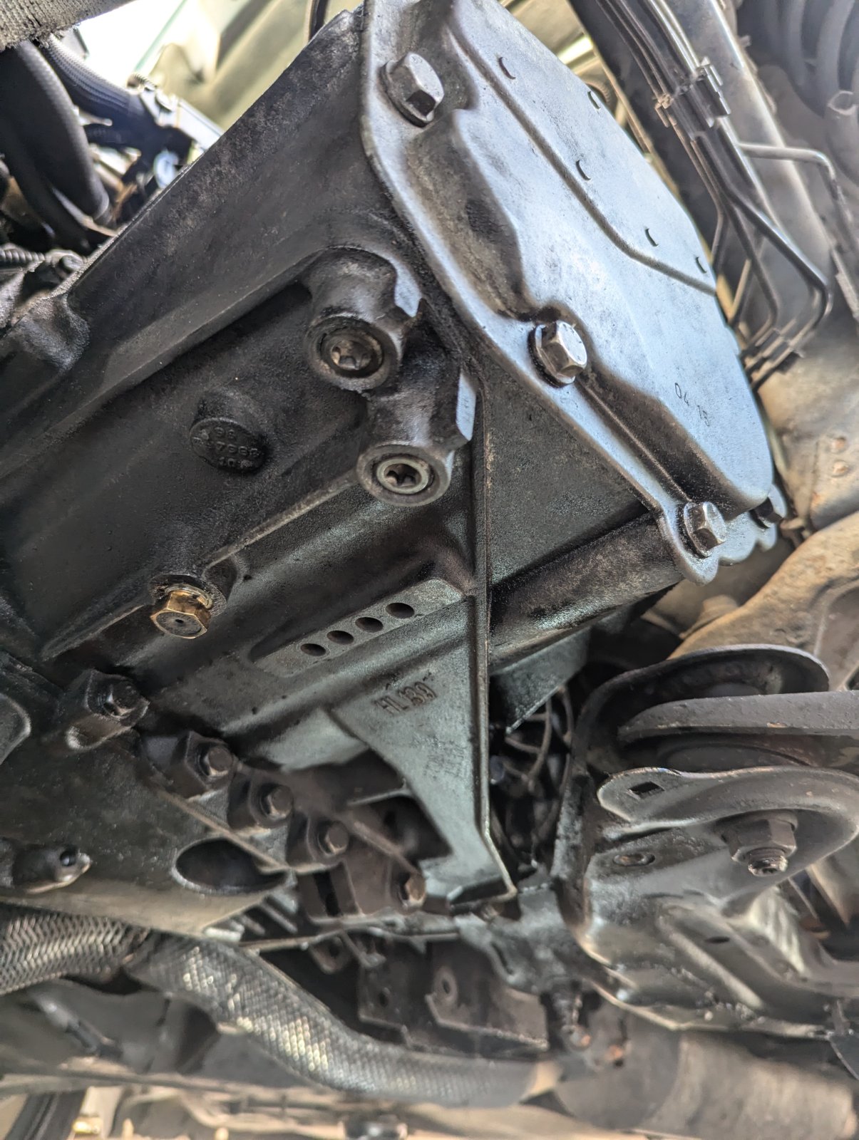

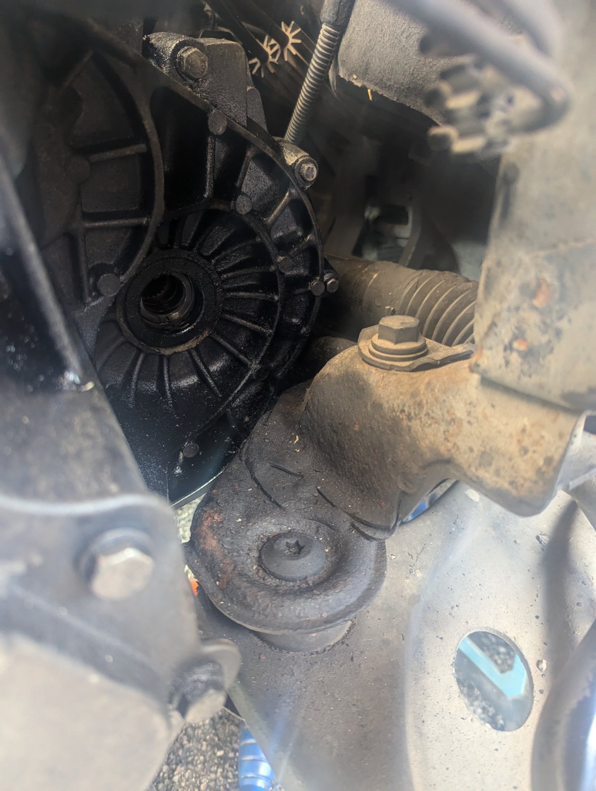

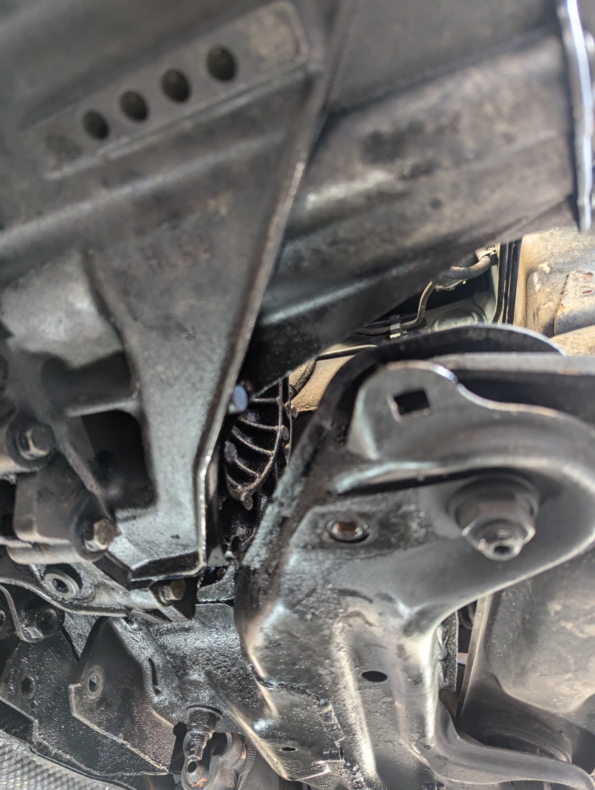

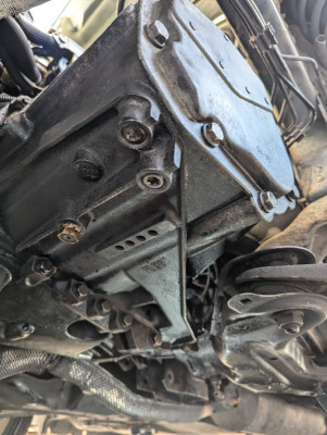

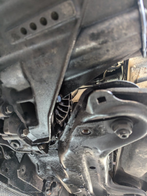

Have you removed the subframe extensions (if fitted)? You probably need to rotate the whole box forwards so that the diff housing will come out past the subframe.

I don't think it has any? I've attached some photos as I don't know what I'm looking for to be honest
not sure if any of them help. I've tried rotating the box and it won't budge at all! It's separated a fair bit and I can see there's no bolts or dowels holding it but still no joy... Bloody thing

When I did this job on a Berlingo, I had to remove all the mountings from the gearbox to get it between the chassis rail and subframe.
