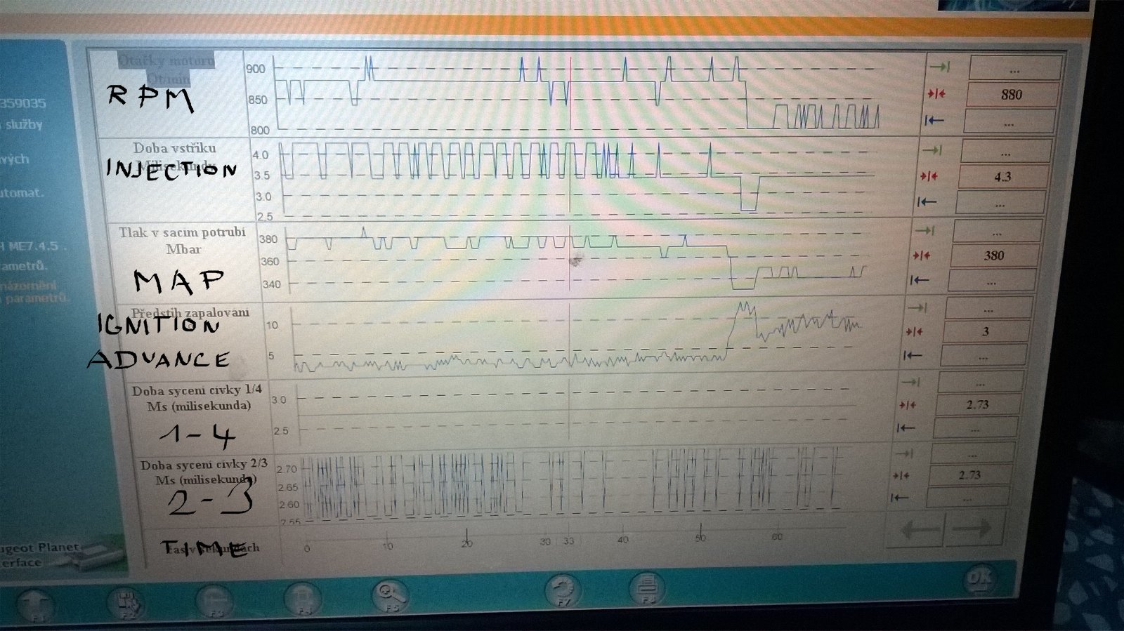

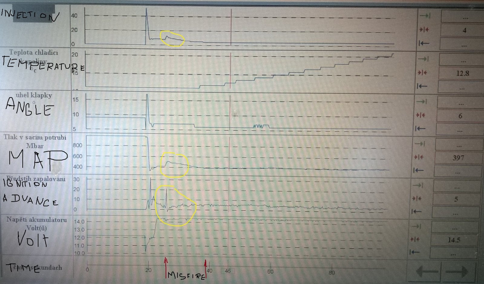

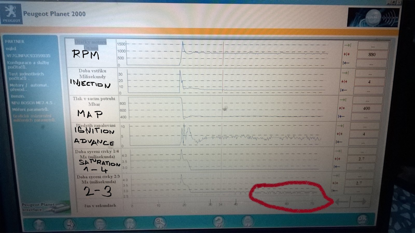

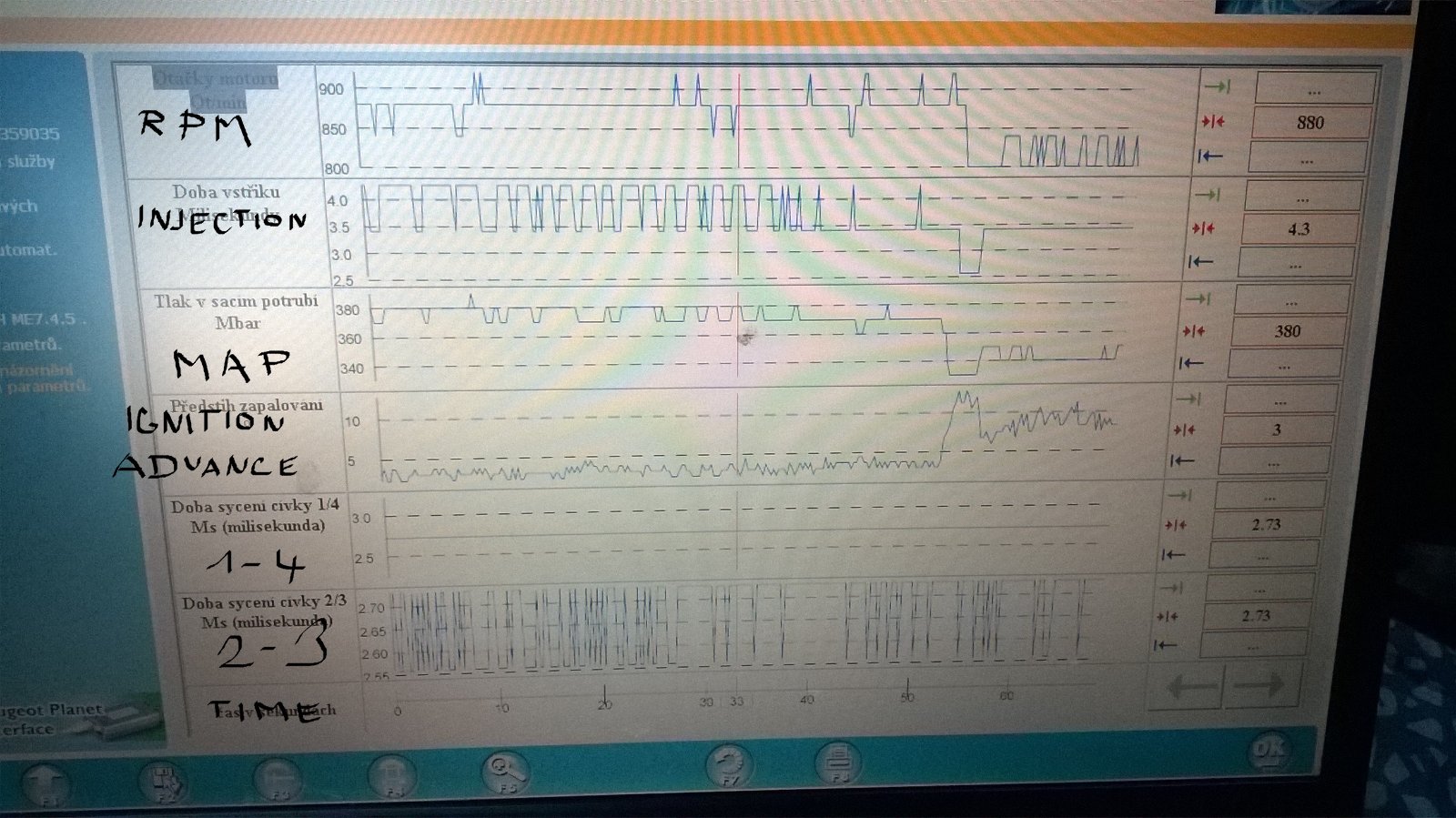

hello, before I change the control unit, I measured , and I don't like:
fig 1,2
ignition saturation 2/3 on the graph is not straight, 1/4 coil the graph is straight, what is the cause? I changed the coil 3 times with Valeo, NGK, Sage.
Fig. 3 engine failure, the engine shakes shown on the graph
please what could be causing this?
thank you very much for the explanation
