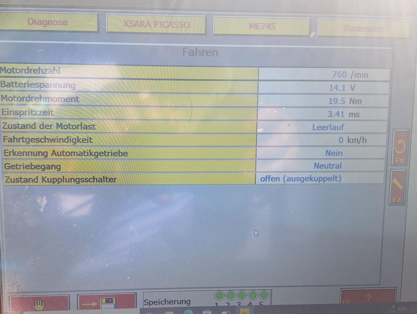

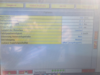

P0501 - no signal from Vehicle Speed sensor.
Here i can not read the speed in Lexia!

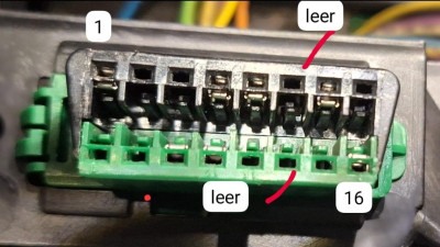

Is mine a special car? Normally on pin6 and pin14 in OBD connector there should be can hi & lo - but there are no pins...
