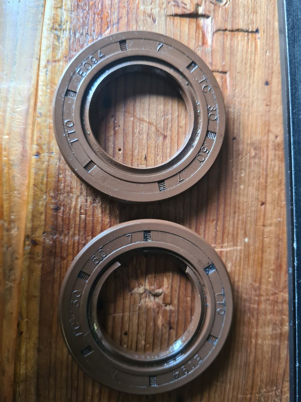

Here's what I've pulled out, a pair of these stacked up. "TTO EO94 TC 30 50 7"

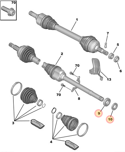

I have the VIN Richard. Are these what you're after?
(9) Driveshaft Bearing, part: 324706, £33.11
(10) Drive Shaft Bush, part: 324810, £12.37
If items (3) or (4) (Driveshaft Gaiter Kits), they are no longer available from Citroen, but parts numbers are:
(3) 3293C4
(4) 3287A5

9 and 10 are the intermediate bearing; I think the seals are on the gearbox housing / diff page.

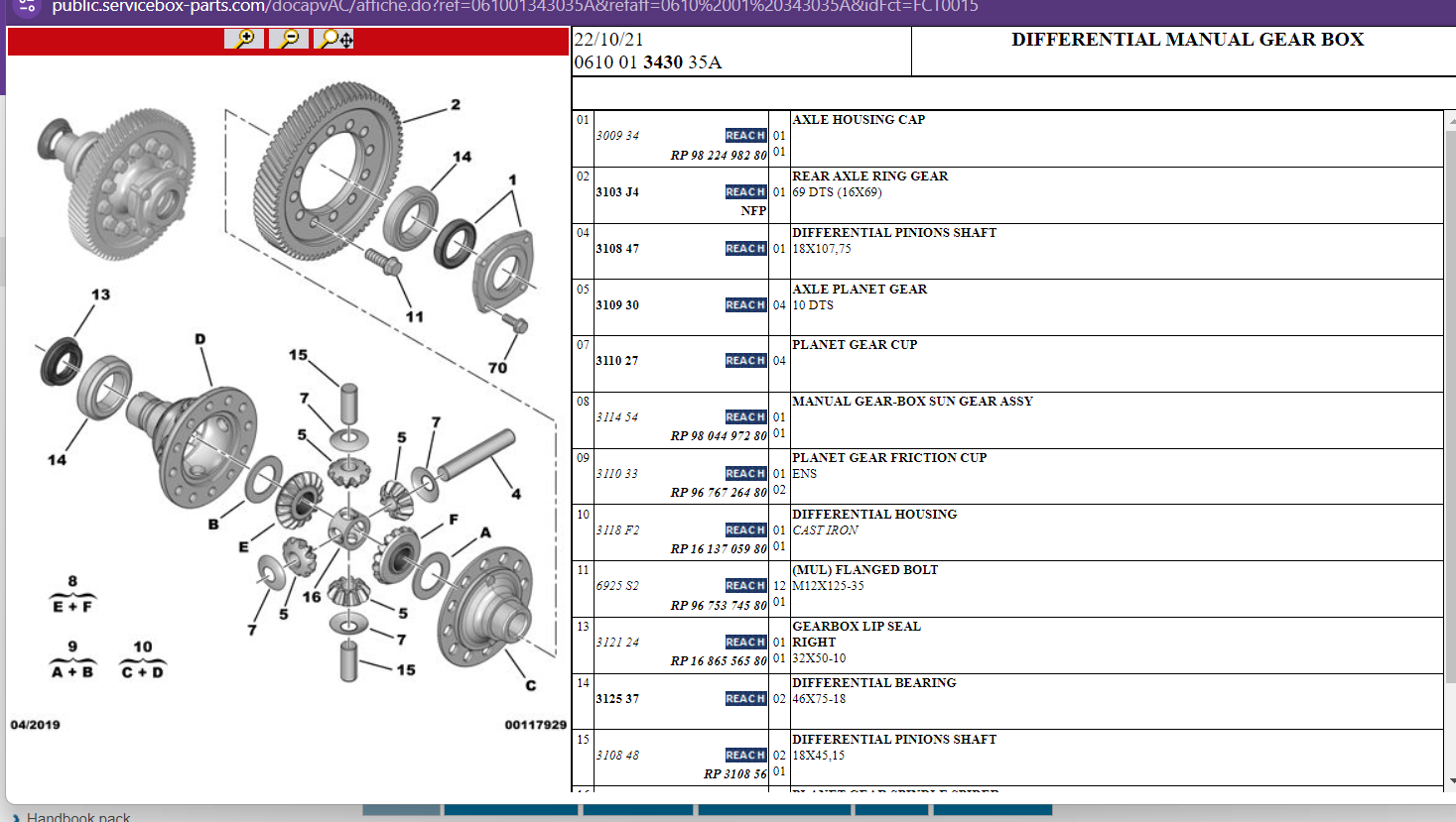

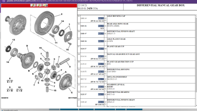

Item 13 (RH) and 1 (LH):
RH is listed as 32-50-10 which matches what is on the pic you posted. I would take that to be 50mm OD, 30mm ID and 10mm thick. Yes, any lip seal suitable for oil use should be OK.
There's only supposed to be 1 - if there were 2 in there, someone has been there before and just hammered a second one in rather than removing the old one first!

I was immediately suspicious when I pulled out two. I knew the clutch had been redone, I'll replace with one 10mm as per spec.
