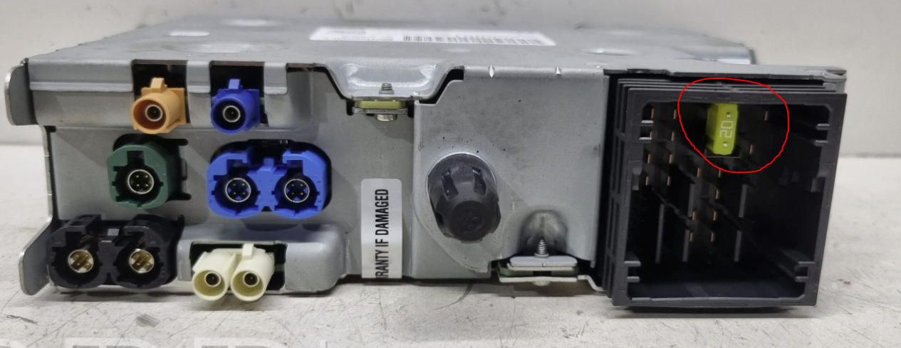

Ok, so you have the IVI system, so here is the 20A fuse I was talking about, where I've circled it in yellow:
I suspect replacing that will solve your issues - and make sure you are using a quality cable in future.
