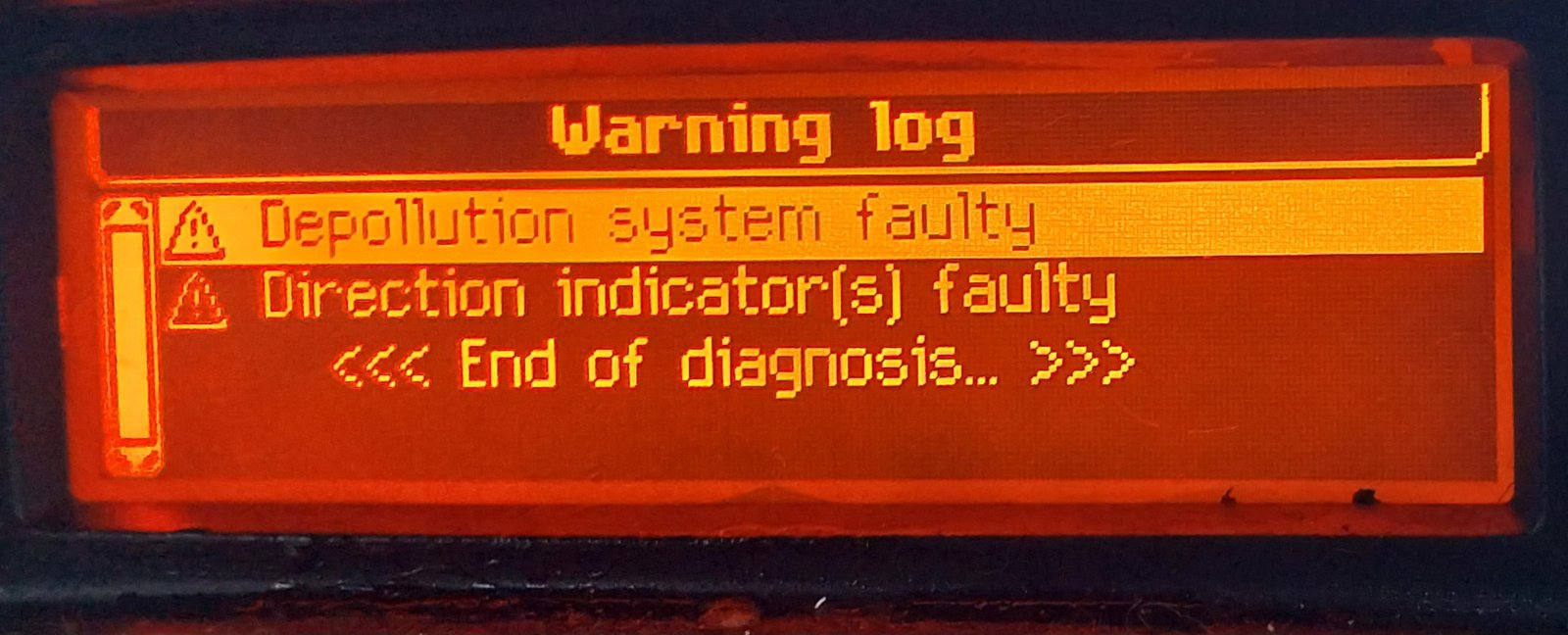

Hi guys
I am hoping you can help me. My ex wifes car goes into limp mode, engine management light on and her incar display shows:
  • Depollution system faulty
  • Direction Indicator(s) faulty

After clearing the fault codes, the following codes would stay: U2001, P1693, U1118 & P0473. All the other codes would return after the vehicle had been used.
Your help in sorting this out is certainly appreciated. I am no qualified mechanic.
