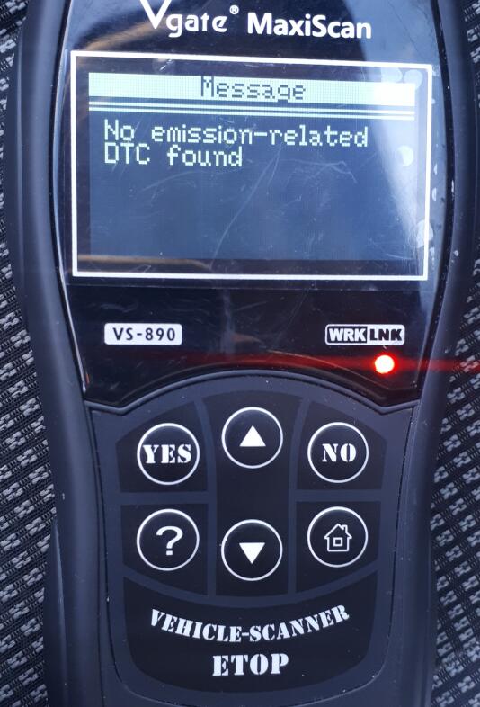

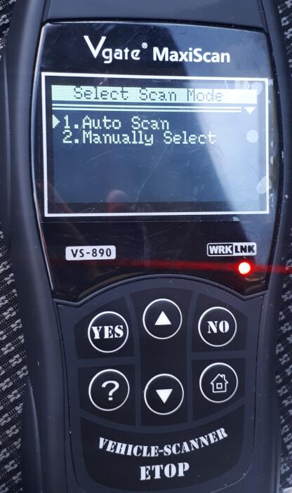

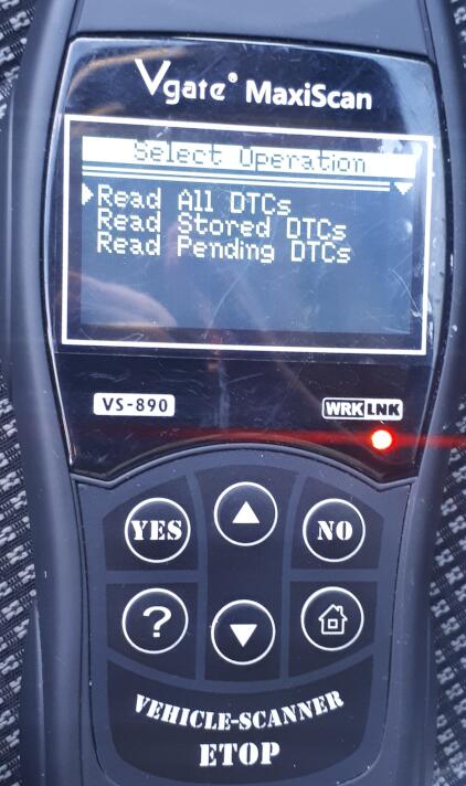

I borrowed a cheap OBD reader, it connects (KWB FAST init protocol) and seems to be working (tests connecting to the internals give results) but each time I start the diagnostic it almost immediately returns "No emission-related DTC found". I have no idea if this is a s**t product's internal error message or the car's. I am telling the device to get all DTCs.

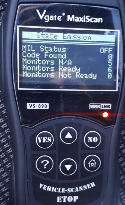

Unfortunately, it didn't do anything to the OBD reader. This is how it looks both now and in the past:
So apparently it doesn't find any error codes.
I wonder if it's the meter or the car.

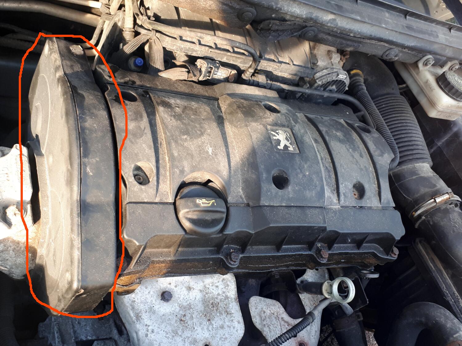

Engine:
Is the timing belt inside that plastic case? Is it possible to check its condition without completely disassembling it?

Have you access to another car, ideally a similar one, that you can try and read the codes from?Bescheiden wrote: 05 Aug 2024, 14:21 So apparently it doesn't find any error codes.

The timing belt is under that cover, the easiest way to make sure its not completely snapped is to remove the oil cap & get someone to try starting the car see if the camshaft is turning.
Does the diag tool read live data? can you see engine RPM?

looks to me like your OBD tool is connecting but showing there is no fault codes? not every scenario that will cause a non start situation will log a fault code.

The tool reads live data though! RPM goes to just under 200rpm when cranking. Does this mean the timing belt is not snapped?

Thats good that you can see engine RPM but does not mean the timing belt is not snapped. Engine RPM is measured off the crankshaft which will still turn with a snapped timing belt.

Instead of using the starter to turn the engine, you can put it in say second gear with the handbrake off with the ignition key removed from the car. Then give the car a push whilst looking in the oil filler cap hole to see if the cam shaft turns so it only needs one person.
Seeing 200 rpm might not be enough to start it but it can mean the crank shaft sensor is not faulty.

Anyhow, I learned that the engine is of the type where I cannot see any movement inside even after taking the oil cap of - there's yet another plastic cover.

OK, may me easier to just undo the 3 screws on the top timing cover & pull it back for a look.Bescheiden wrote: 06 Aug 2024, 13:53

I brought the car to a mechanic and his diagnosis is that the timing belt is loose and most likely jumped and misaligned the valves (I'm probably saying this wrong).
He says there's a chance that changing the belt will fix the issue, but there's alos a (big) chance that the valves are damaged.
