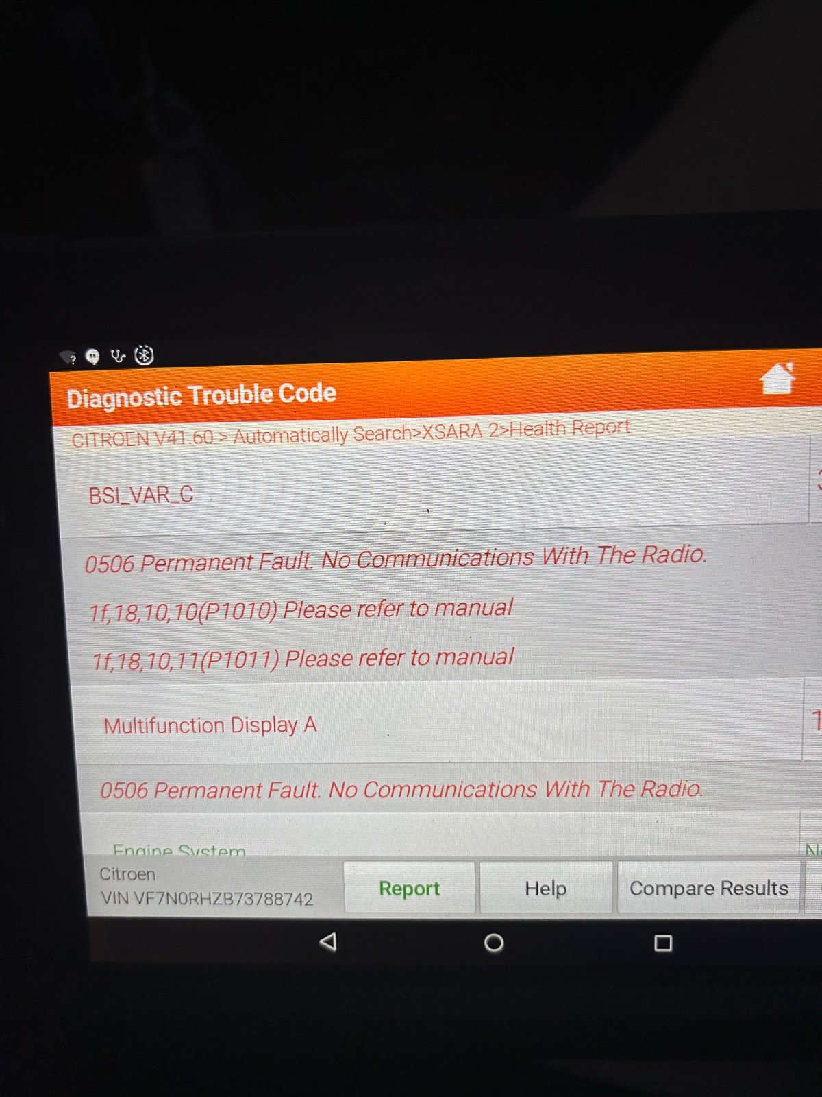

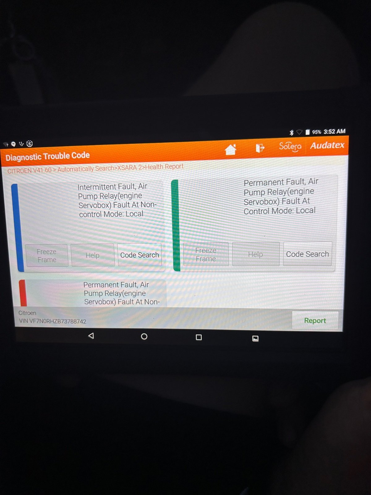

Car in question is my 2003 HDi110 DW10 Xsara.
When the car gets up to temp it puts its self in some form of limp mode when i have very limited boost. Ive tried changing the MAF sensor and N75 valves but no change…
Ive attached photos of what codes came up when it was scanned.

Those faults may be leading you astray, really needs to go on Diagbox which will interpret the info better.
