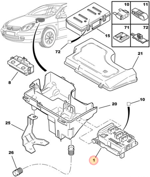

(1) Siemens Engine Fuse Box, part: 6500Y1, £402.72 inc UK VAT @ 20%.
These are still showing as available, but you may be able to obtain a working used one using the part number I've supplied above to see if that resolves your issue.

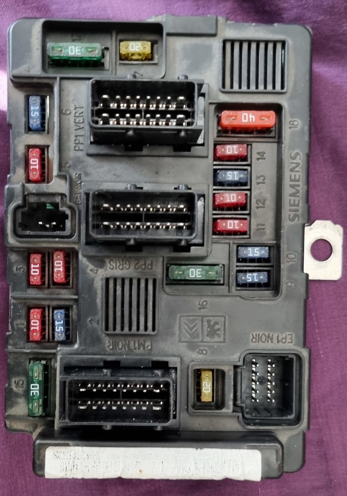

Thanks for the help. I'm going to purchase a second for cheap and try that first. One last question if you don't mind, I drove and picked up the PCB and it looks slightly different(pic). The connections look the same so I'm guessing it's just an older version? 6500Y1 vs 6500Y3? If these are interchangeable is it possible to have a picture for which fuse is which. I've looked online but not been successful.
- x 6947
Re: BSM replacement
No, they are not interchangeable - they may look the same but are not.
Stick to the correct part number I have provided.
