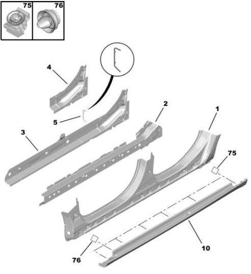

I reckon a diagram of the sill should provide the answer to my question relating to plastic cover removal. I am tempted to use a crowbar to flip out the plastic cover but that may be overkill. I am known for it unfortunately.

I've so many previous VINs Don, so not sure which is current, so please let me have that as I require it for parts. But on the assumption this is for a DW12C Saloon....
Sill Wing
Sill Wing

Re: Citroen C5 X7 scuttle removal
Using my limited computer skills I found one of your contributions showing the clips needing to be prised out to allow the sill to come free. As per your advice, I need to find new clips as I have managed to break half only

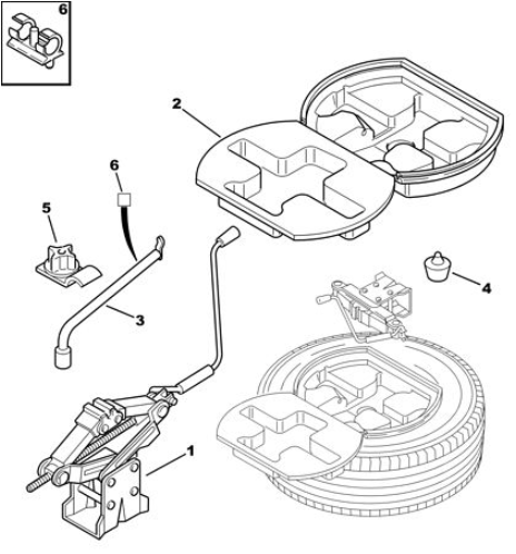

As an aside, when did PSA provide smarter jacks with Citroens which had a clip to be inserted at the jacking point. This setup assisted in ensuring that the jack sat in the precise location limiting the chance of mis locating the jack. The jacking point has a hole and an indent in the plastic sill to allow the seating of such a jack. I seem to recall that I owned such a jack which came with either a Peugeot 405, Citroen Xantia or a Citroen C5 Restyle. My memory fails me once again.

As far as I'm aware they haven't used this type - since the Xantia II: This shows the scissor groove in the jack at the lifting point
All subsequent C5 ones at least are the flatter type.

If you want to get a decent spare jack I have found the one used for the 2004 to 2007 C5 to be one of the better ones and use it when working on our cars. So the one with our C5 lasts, I bought a used one through ebay and this was as new since not many owners do their own servicing these days. The handle is separate to the jack so does not catch the bodywork. https://www.ebay.co.uk/itm/266698219026?_ul=GB
Trolley jacks can bend the jacking point since as the car rises the jack arm moves through an arc rather than straight up if the jack can not move freely on the floor.

Yes, that was the type of Jack that came with my 2007 C5. It was quite good to use as it could be operated somewhat remotely. I do use a trolley Jack when I am jacking the car on a flat concrete floor as the Jack will move to align with the line of the car as you say. Thanks for the detailed response.
