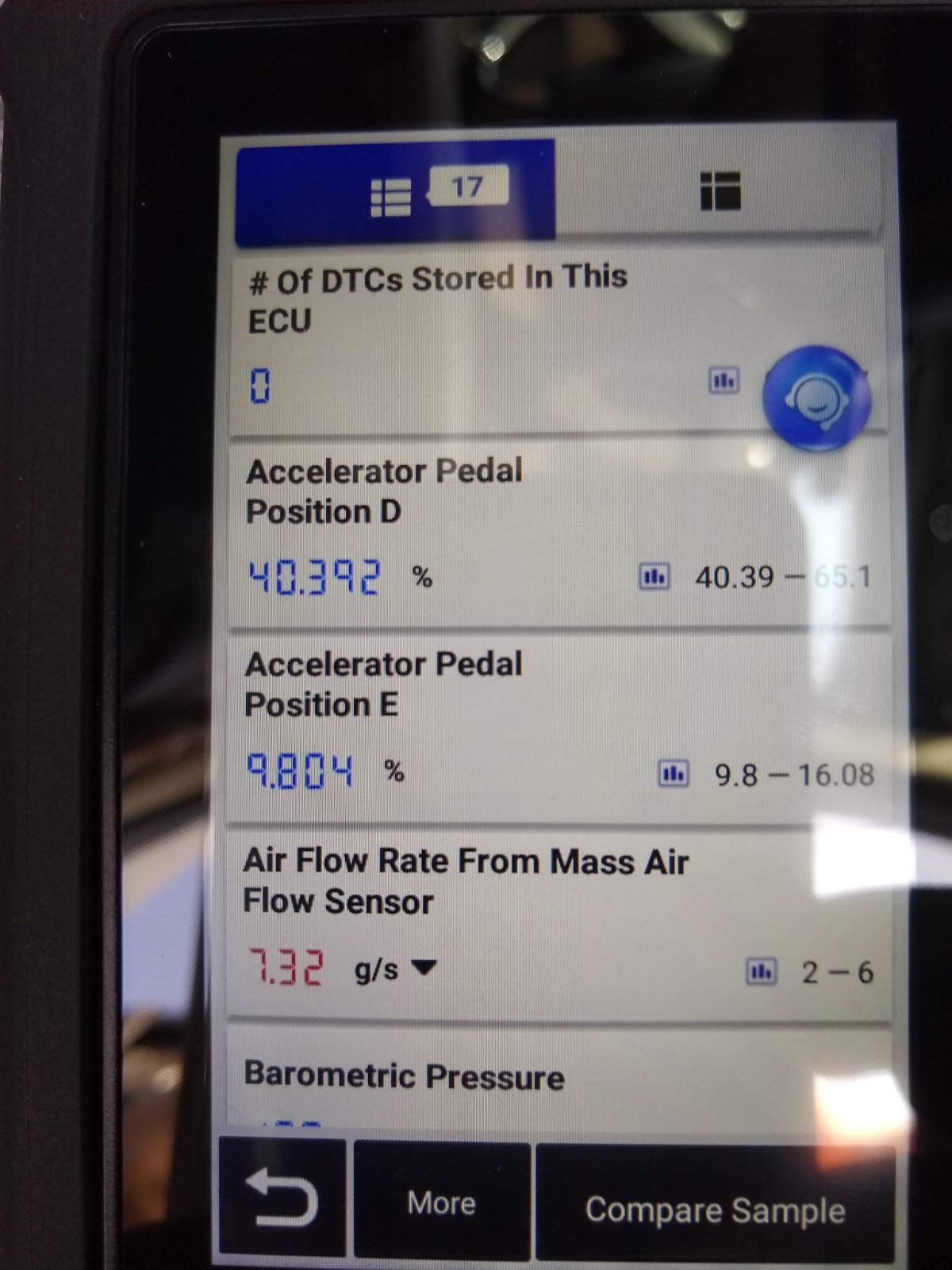

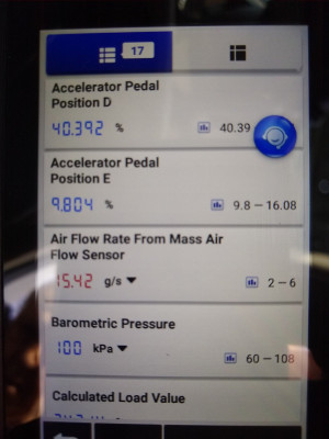

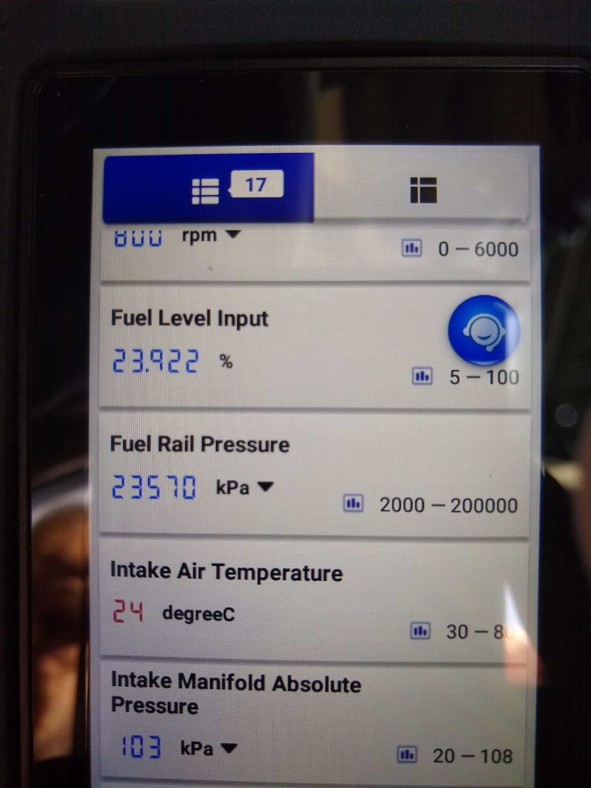

Ive pulled the van out today and hooked it up. It looks like there is only the one intake air temp sensor built into the MAF sensor has there is only one air intake temp reading.
I started it up and sure enough the EM light came on again and the reader gave the same fault ( P0095 Intake Air Temperature Sensor 2 Circuit Malfunction) yet on the live view it is giving a normal looking reading for the air temperature.
I cleared the fault again with my scanner and it cleared the fault light. When i used the scanner to diagnose the ECM it still had the fault in memory (P0095 Intake Air Temperature Sensor 2 Circuit Malfunction)
and it said 'permanent fault'.
So i pulled the connector off the MAF sensor with the engine running and to my surprise the EM light didnt come straight on, but the engine started to tick over a little rougher. I then plugged the connector back on and i noticed the 'Air flow rate from MAF sensor' was lower, reading around 7 - 8 g/s whatever that is. Previously it was reading around 15-16 g/s.
Whilst it was giving this lower reading i checked the fault memory for the ECM and that 'permanent fault' had gone so i thought it had cured it.
I stopped the van and restarted it, and guess what- the EM light was back on and the fault was back, also the 'Air flow rate from MAF sensor' was back up to 15-16 g/s. (by the way all these readings were taken with the van ticking over.
I have attached a few pics i took of the readings i was getting, perhaps someone can tell me if they look around normal. The first one is showing the lower air flow rate when the fault seemed to clear, the second one shows the higher rate, and the final one shows the intake air temp.
Any help to finally sort this would be appreciated.

The accelerator position sensors should I think have similar readings as they are supposed to provide a backup of each other and yours are showing different values.

Im not getting any errors relating to the accelerator, its just this stubborn air temp sensor error that keeps coming back. The VIN is VF7**************[VIN obfuscated, can be read by forum staff]

I noticed on your readings at the right side in black is a range - is this the range of values actually being given since for the inlet temp it shows 30 - 8? which might be it goes up to 80°C. The actual value ought to be ambient before the first start of the day but I have found on our cars as the engine runs it will creep up to possibly 40°C due to heat from the engine.
On our car the air flow on tick over when warm is about 7 g/s but it can jump to about 15 g/s with the rpm staying the same and blipping the accelerator will drop it back down. When cold it is about 11 g/s. I am probably wrong but maybe this could be something to do with the egr valve
