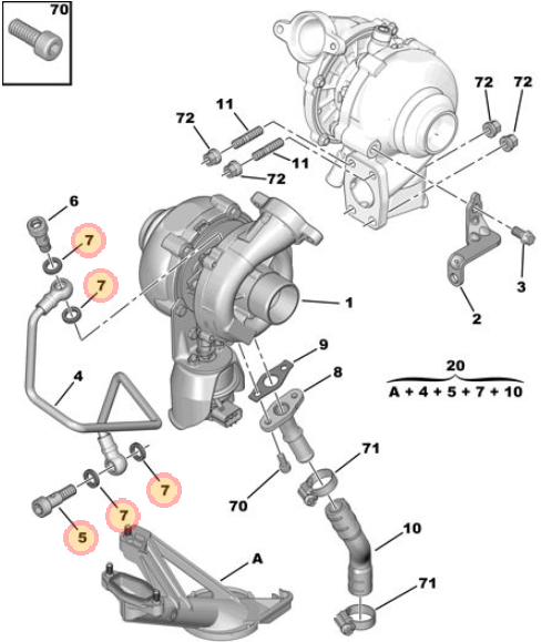

Check you have the newer banjo bolts with uprated strainer as some of these had updated parts to help counter blockages.
(5) Turbo Lubrication Union Bolt, part: 037660
(7) Copper Seal, part: 015708

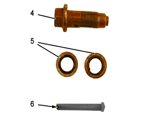

This is the old assembly:

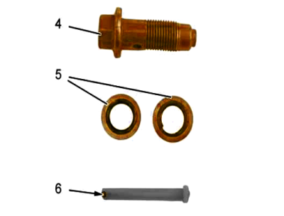

This is the new assembly, which concerns replacement of the lower banjo bolt on the turbocharger lubricating pipe with a banjo bolt that has a removable, larger-capacity, strainer filter.

Personally I've never had this engine, so can't comment directly, but with the removable strainer at (6) it's at least easier to remove and check / clean with your oil changes.
I'd probably opt for keeping it in place at this stage as you don't really want any debris getting in at this stage. Hard to know what sort of carbon deposits or other crud is in the system, so I would be inclined to fit with the new filter and see how it looks and just change the oil every 6-7k miles or at least annually.

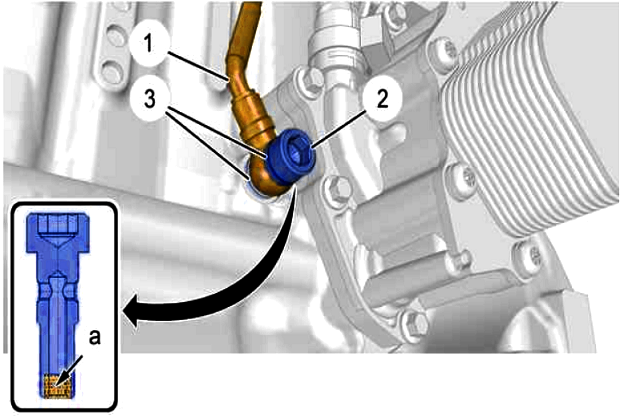

It's a shame the turbo strainer is on the block side. I haven't removed the old one yet but from what I'm seeing it's heatshield and exhaust/cat off to access the bolt.

Quick update. Ugh what a job that was. Not much space to work on a 207 so bumpers and headlights off, Doser off, intercooler out and radiator frame pulled forward. Heat shields and dpf off just to get to the lower bolt.
My replacement bolts didn't arrive so used the originals. Only 1 small bit of debris on the gauze so cleaned and refitted with no leaks. Oil was changed shortly after, had a 5l bottle so I twice flushed the dregs with 2x 500ml of oil. Still black so may do another change in a month or so. I know they go black quick anyway but want to give it a chance.
