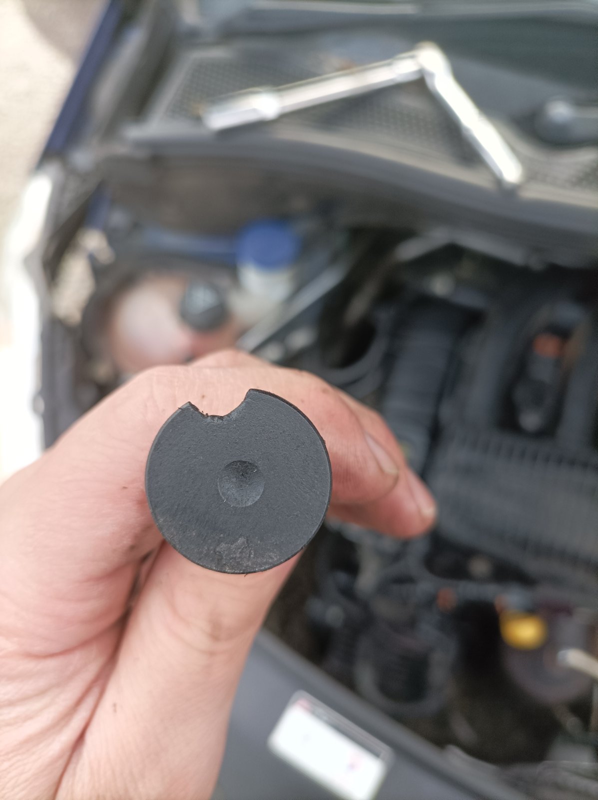

The no compression was a burnt out/broken exhaust valve. Seems to be common on these engines from what I have found out.
So new valve and all back together...start it up...all the previous issues are still there, every single light on the dash. Wonderful.

Attached is a picture of the exhaust valve
