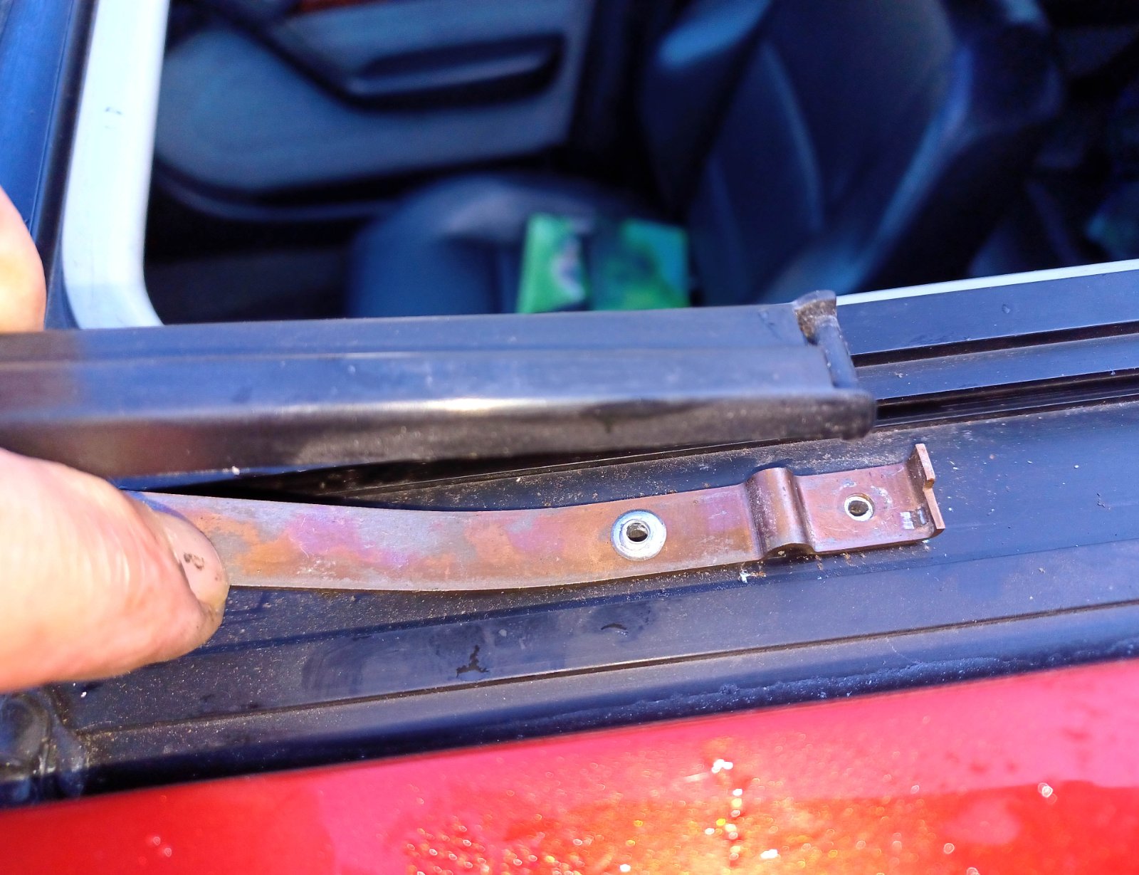

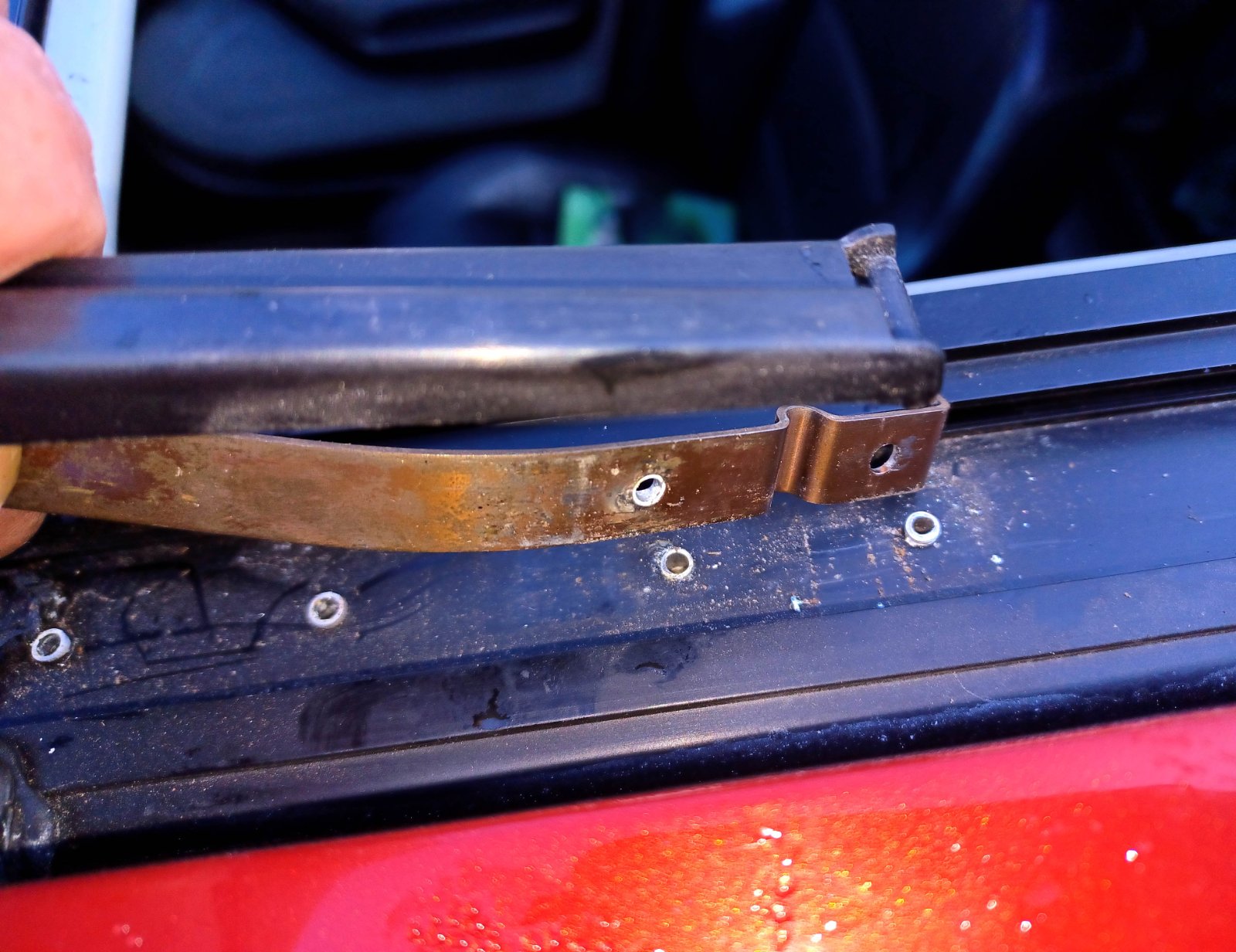

Finally got round to removing the glass to get a better look.........this is what I found.
The flip-up wind deflector is held on with a strong spring/hinge part this is secured with two rivets....these had both failed. I suspect the rear one "failed" allowing the hinge part to lift and on closing it pushed the spring/hinge and sheered the second one (was that the "crack" on closing ?....my bet it was )
Time to hunt for some small rivets, drill out what remains and see if I can re-attach the spring/hinge.
With it pulled out of the way and the glass removed the mechanism all works correctly without hindrance so I am assuming that the "blockage" is not at the back/inside.....so I hope I will not have to remove the whole cassette to fix it.
